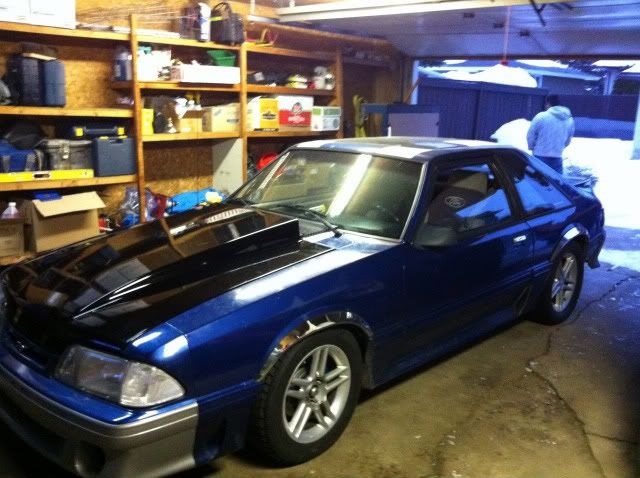

I am going to throw the MM front and rear coilover kits on my 88GT, what springs should I go with? Mostly street driven but would lean a little toward drag racing over cornering....and would like the same stance as my Eibach Pro Kit:
I want to get it done before paint next month, sorry about the Iphone pic

please remove those chrome wheel well covers

Hell yeah the flares are going!!!! I hate them so much, but whatever, paint is comimg soon (not soon enough, but you can still see the snow pile above my fence, the back alley is just two rivers about 6" deep!!)
