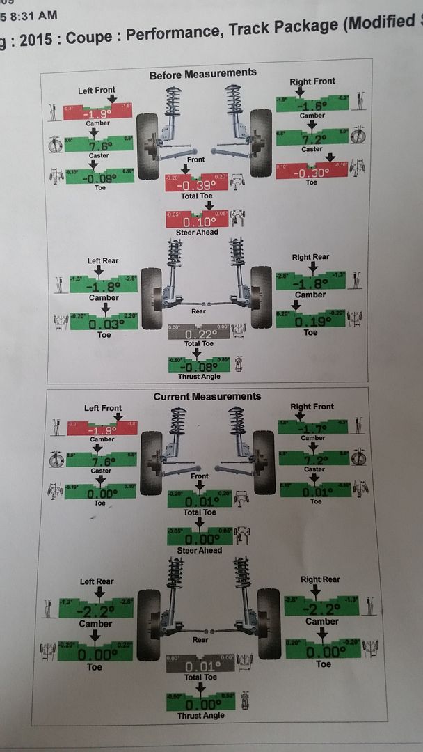

Well, official alignment is done and here are the final numbers:
Front Camber: -1.9 and -1.7
Front Toe: Zero
Front Caster: +7.8 and +7.2
Rear Camber: -2.2 and -2.2
Rear Toe: Zero
Not sure how all the rest of you F-Street guys got into the -2.0 and more negative range but I guess you are the lucky ones and the factory stamped your struts differently! :)
Factory alignment was pretty far out of whack with regards to rear toe... total toe was fine (.22 in) but the split was absurd (.03 on the driver side and .19 on the passenger side)Issue resolved and zero thrust angle so the IRS is at least square to the chassis.
Here is the before and after:

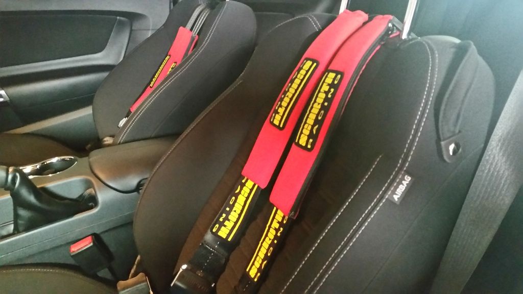

I want to know more on the belts please.....
They are Schroth Rallye 3 Harnesses. They are mounted in such a way that I wouldn't use them for street driving but they'd be fine for autocross duty. Biggest issue is the way the rear mounting point is angled. If it was at less than 45 degrees it wouldn't be an issue.
On the S550 chassis the rear upper mount for the seatbelt is actually a redirect and the actual reel is down near the base of the seats. Those mounting points are unsuitable for a harness mounting point so I mounted the lap belt points to the rear seat anchor points (which is fine) and the rear shoulder strap points to the lower seat belt anchor points.
