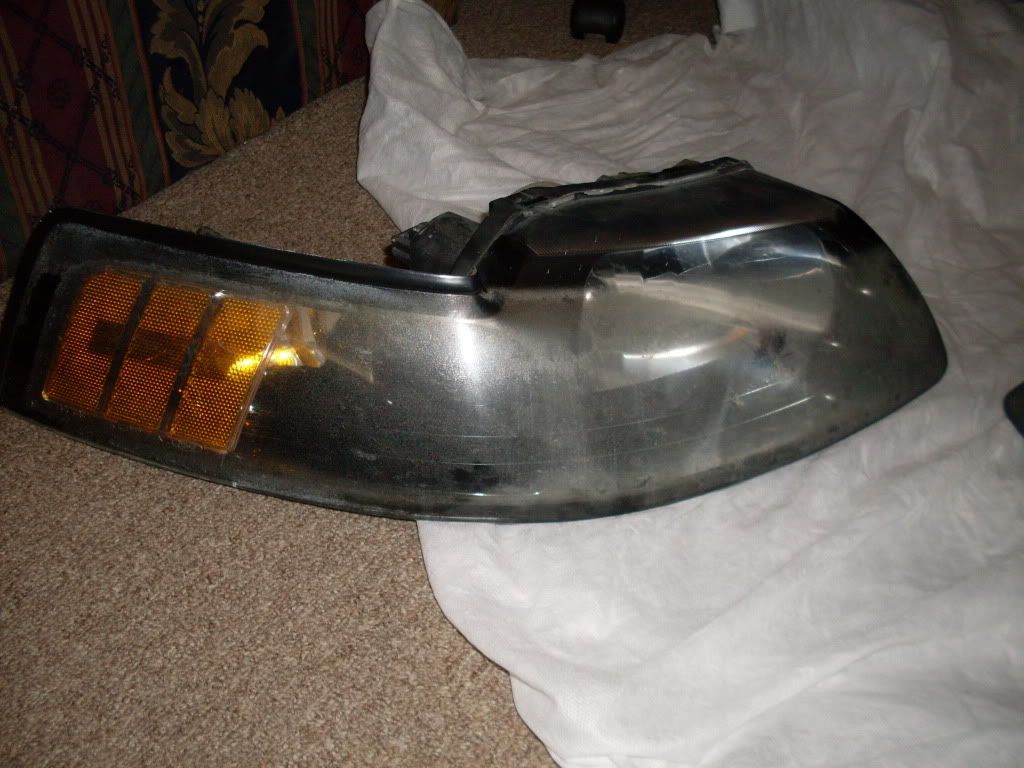

Before:

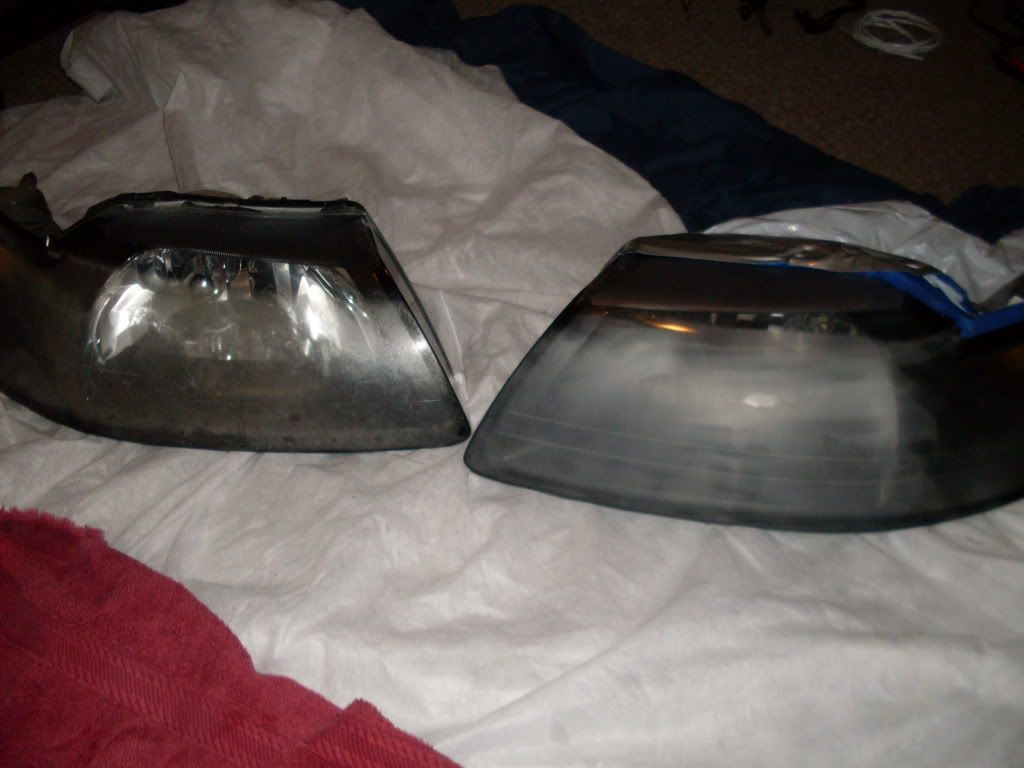

6. Now, spray the headlight with the quick detailer and begin sanding with the 400 grit. It should look roughly like this after the 400 grit. (pictured on right)

8. Again, spray headlight with quick detailer and begin sanding with the 800 grit now. Should like this afterwards.

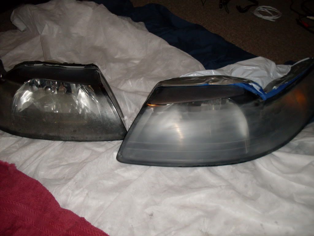

10. Spray with quick detailer and being sanding with the 1000 grit. It should look like this afterwards.
11. Wipe with IPA.
12. Begin sanding with the 1500 grit. Should look like this afterwards.
13. Wipe with IPA.
14. Sand with 2000 now. It should look like this.

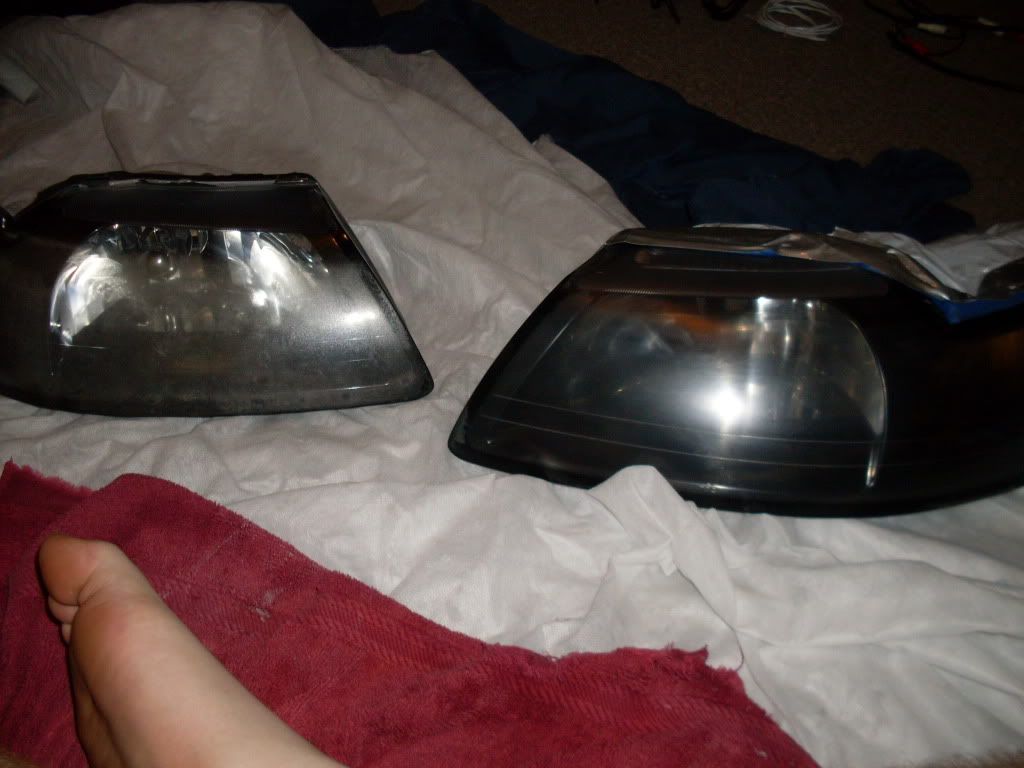

21. Should look like this afterwards. It should have a "brand new" look at this point.

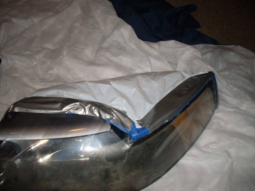

23. Now, tape EVERYTHING off that you do not want cleacoat on. I used a trash bag, masking tape, and duct tape (to save on the masking tape)

31. Final product. Video is uploading at the moment. Will be up shortly.
After:
