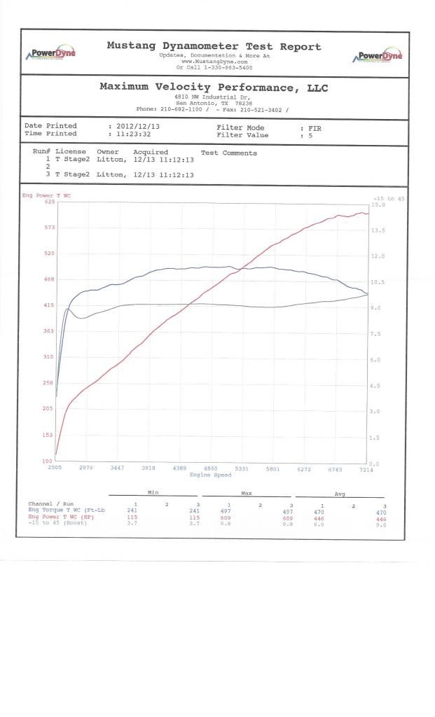

Nice numbers... care to share what you have done to the car?
56 Posts
Stock 5.0 with the Roushcharger (TVS2300), JLT Big Intake, Ford Racing Cobra Jet Throttle Body, KB Boost-a-pump, and a slightly smaller SC Pulley 88mm versus 92. Tuned by Lund. I can't wait to get it back to the track!!

Nice.. Congrats. The car is gonna be a monster now.

Nice number :) what brand is the strut tower brace?
863 Posts
Congrats.
If you want to go smaller on the pulley, let me know, I have a few hanging around.
