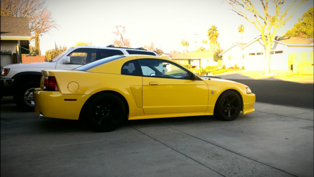

Hey guys I recently pulled of my stock H pipe during an egnine rebuild and once we put on its been hanging waaayy to low.. I scrape evertime I go down sidewalk. Its the spot where the mid meets catback, its like a V at that joint. Any ideas on how to get it back up in its proper place?
Also scoot back the tips which I never knew you could..

If it's hanging too low and you didn't change anything then it just wasn't put back on correctly. When I say correctly I mean there is too much slack. Losen up where it connects to the cat-back and push it in more. There is just slack in the exhaust system. This happens sometimes after installing long tube headers and you have to cut the exhaust to make it shorter. If you pushed the tips out further then that's probably why it's hanging too low, because it's not all in as far as it can go.
Car looks great btw man.
