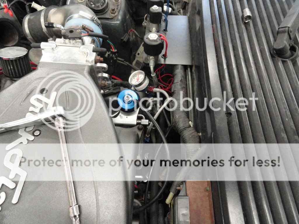

Fabbed a temporary bracket to locate the nitrous solenoids for now
