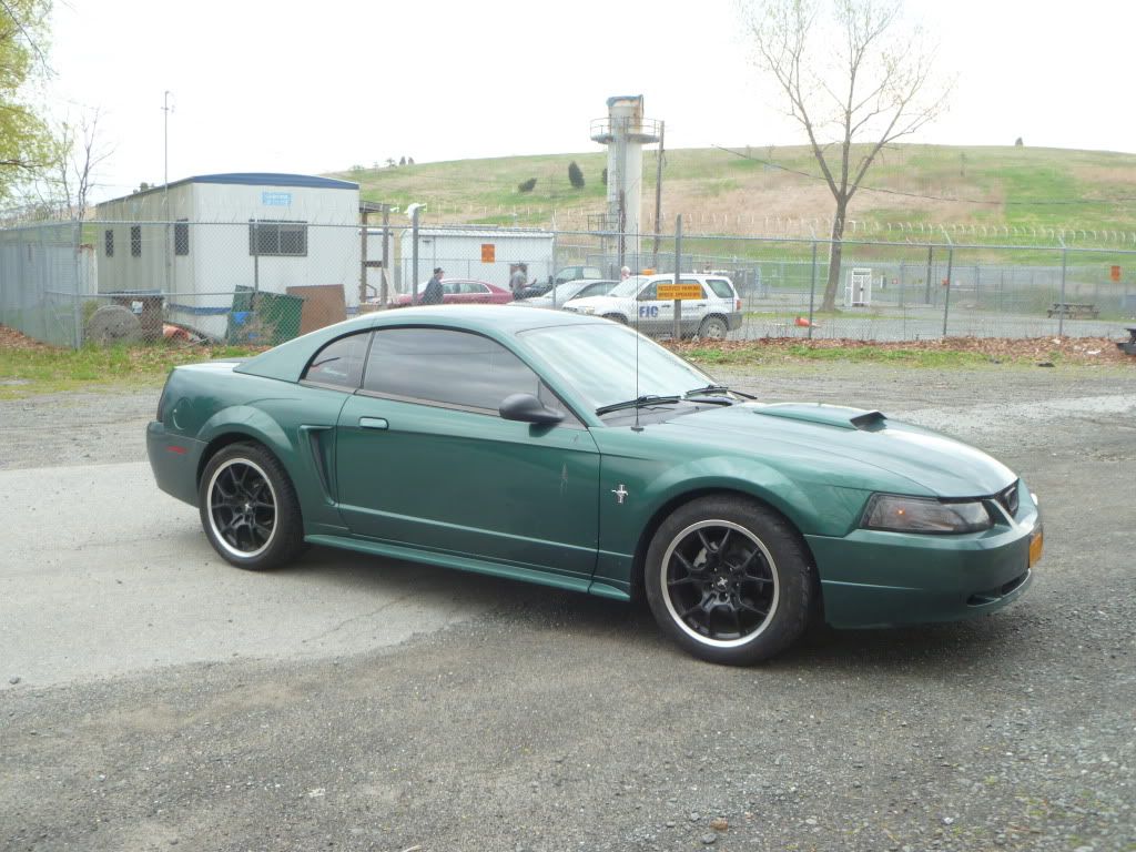

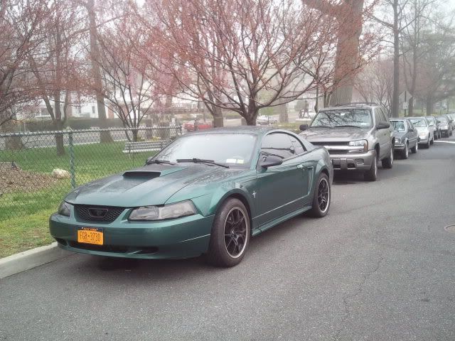

Ok so basically after looking at alot of peoples car stance ive decided i want to be more like them :D
Unfortunately my car looks nothing like it,
My car is lowered, Eibach lowering springs,
18inch rims: Front tires 255/45/18, rear 285/35/18
I am not sure if its 18x9 all around, I bought the rims + tires off craiglist :confused:

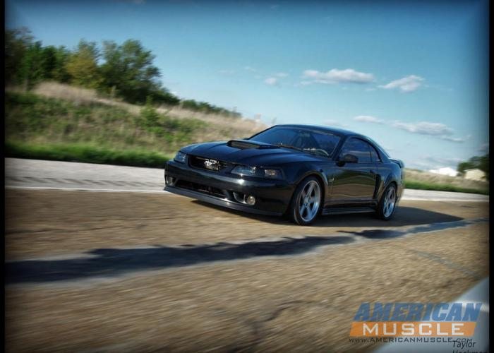

This is the type of stance i want to aim for,
(Zats pic)
Basically i want my Chin to point down instead of looking up,

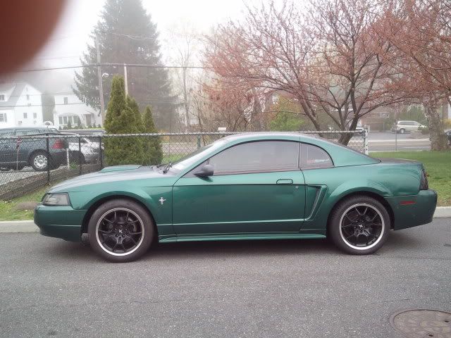

This is my stance right now:
In real life you can clearly tell the front tire+ rim look taller
I am considering cutting front springs up, and putting stock springs in the rear to get that stance..OR if by any chance my rear rims are shorter than my front i will just mount the tires backwards,
also does anyone know if there is a chance that my front rims could be taller by looking at it? I cant tell if its the tires or the rims, I just know theyre 18 inch dont know if its 18x9,
This is my first car and i would appreciate any help :D

Your front tires are way bigger than your rears, that can be seen in the pictures. I have Eibachs on mine and it's much lower than yours. You could try removing your isolators.
1,134 Posts
^You got it. 10mm difference in the sidewalls is actually more noticeable than I thought it would be. Especially when the taller tire is up front! I'd look into getting new tires for the front with a closer sidewall measurement. I think just that would make a big difference. In addition to that, as 89StangGT said, remove your isos. That'll bring her down a bit more! Good luck!

Yeah dude you need a 35 series tire up there. That thing looks like a life saver.
