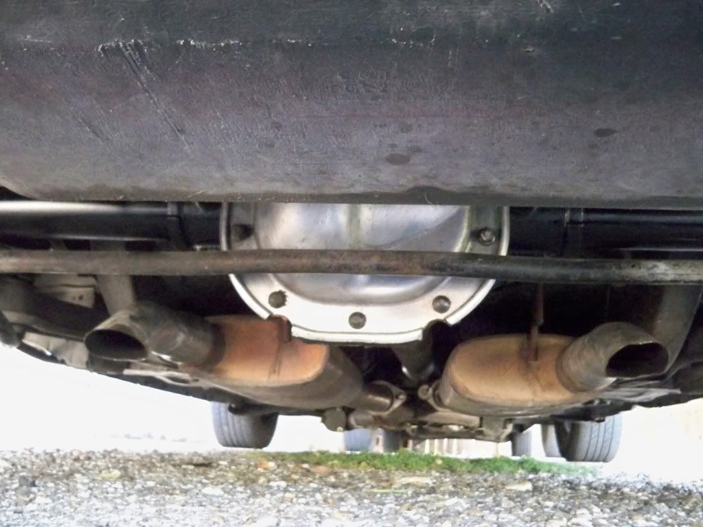

Oh my god this should have been my first mod to do :yes I just freakin luv it. It shifts faster than before. It use to shift at 4500 rpms and now it shifts at 5k :p
I dont know what else to say but this has been the best mod ive ever done to my stang, im speechless. No more one wheel burn-outs ;)
I think ill be in the 15's now :rolleyes:
Big thanx to Iron Horse Motorsports :cool:
Ill be sure to make a new vid
477 Posts
Looks good man, I take it you painted it? Also how much did you pick it up for?
well the shop i took it too did it for me
i picked up the 8.8rearend with its stock gears for 200. Then i bought 3.73's to get them installed, that was 100 bucks for the gears. Then labor was another 300
so in total 600 with parts/labor :cool:
shoot they even added new bearings too whenever the installed the 3.73's. I luv the shop i take it to, they do awsome work :D
like i didnt even expect them to paint it for me but they did and im happy with the results

Nice bro. That would prolly really help my car's response off the line as well. I should be sitting around 16.5 with my tuner now. That would prolly push the car in the mod to high 15s. Add a simple turbo and you could be lookin at 14s or even better.

nice...b4 gears i ran a [email protected]
with the gears now...i think i should run high 15's :cool:
i will be going to the track this coming saturday :)

Yep, I currently run a [email protected] before my tuner. Hoping for atleast 16.5 next time I go to the track. My goal is 15s flat without heavy heavy mods. That will be 2.5s off the stock time it ran when I got it.

Awesome on the gears, but not to be a bummer, gears won't change the shift points of the transmission.
Hmm. Correct me if I am wrong, but gears make the car run at higher rpms through the mph range. So while its not technically chaning the shift points MPH wise, each shift will be at a higher RPM right?
I think thats what he ment. Example;
It still shifts from 1-2 at Xmph. However it was shifting at 4000rpm, now it shifts at 5000rpm.

well IDK but it does shift a 5k now... dont know why :confused: lol
ill get it vid of it and post it up
