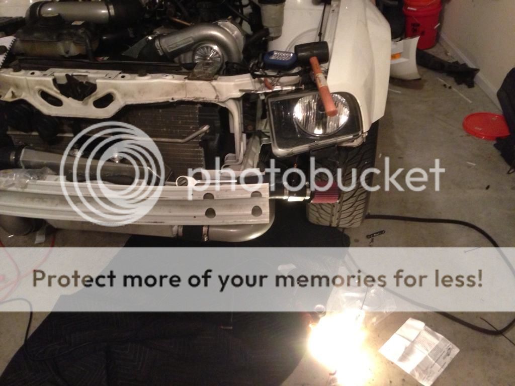

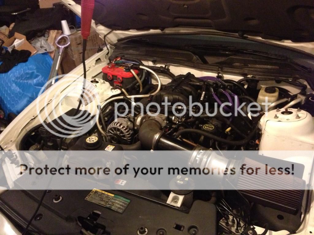

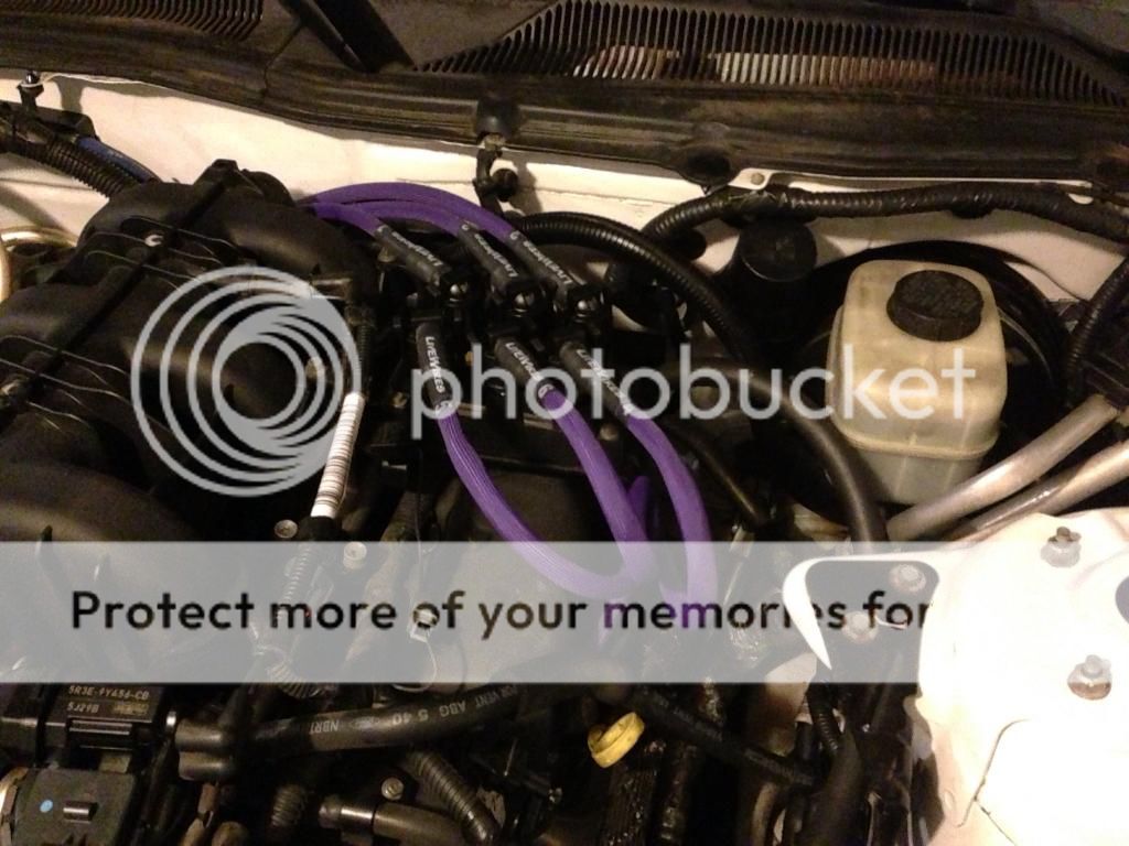

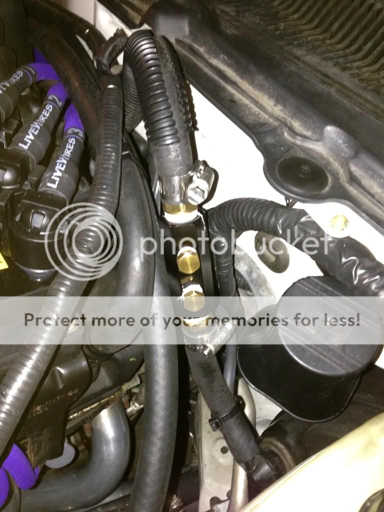

After buying it and having it sit in my garage for almost 2 years I finally gathered the testicular fortitude to install my ProCharger P1SC. I worked on it for a few hours each night while my family slept. It took a few days working like that to get it in, but I was able to get everything in. I never did anything like this, much less alone, so it was sort of a PITA. It wasn't as bad as I was thinking it would be though. While I did this install I also added in a Moroso Oil Separator, Screamin' Demon, LiveWires, new plugs & I also Seafoamed the car prior to install. Next up I'll be ordering and installing an Auto Meter Boost/VAC gauge, Aeroforce Interceptor w/Fuel/Oil Pressure & WideBand AFR. The plan is to fit them in two of the Roush Vent Pods. Not that this is over that 8.8" rear w/4.10s that I bought around the same time is going to be going in sometime before spring. Suddenly it doesn't seem as daunting...
If anyone wants to pick up my JLT CAI and SCT Tuner I will be putting them up shortly. Thanks to all who helped me and answered my noobish questions! Below are some pics of the carnage!!
