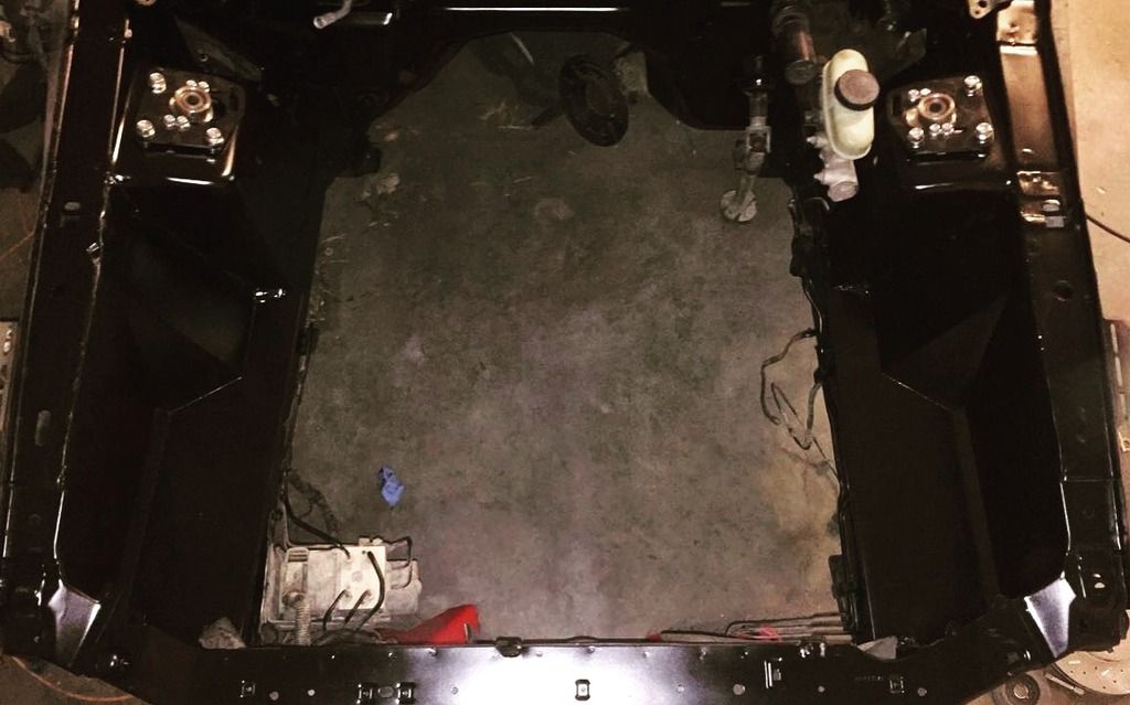

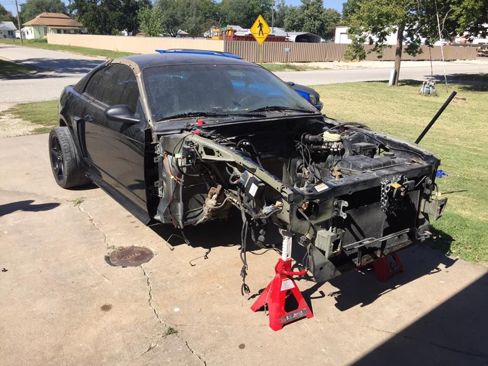

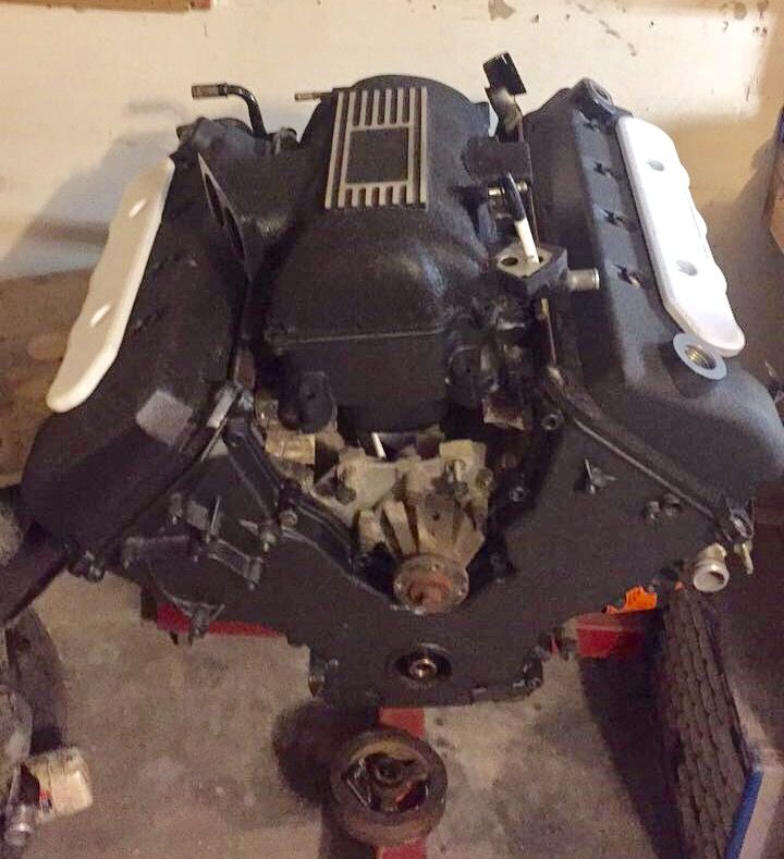

I didn't realize there was an actual page for the MK8 swap!? Here's a little preview of whats going on with my 99GT.
Picked the car up for 75 dollars from a buddy of mine that had started parting it out.
Then did a Team Z tubular K, Tubular A's, Coil overs, etc up front. In the rear I put a yukon duragrip differential and 31 spline yukon axles, frpp 4.56 gears, frpp dif cover, etc.
All sitting on a set of SVE 15x10 rears and 17x4.5 front with mickey thompson et street pro radials on the rear
Picked up a set of COP valve covers as well as a complete 96-98 cobra intake (actually picked up a second engine just for the intake lol) And decided to VHT wrinkle coat the top end.
While everything was apart I decided to use scottrod inner panels to shave the engine bay and do a complete wire tuck.
Goal right now is to put the engine, trans, front K back under the car this weekend.
Here's a complete build thread on the car so far.
http://www.moddedmustangs.com/forums/projects/613018-99gt-boosted-4v-build-pic-heavy.html
See less See more
