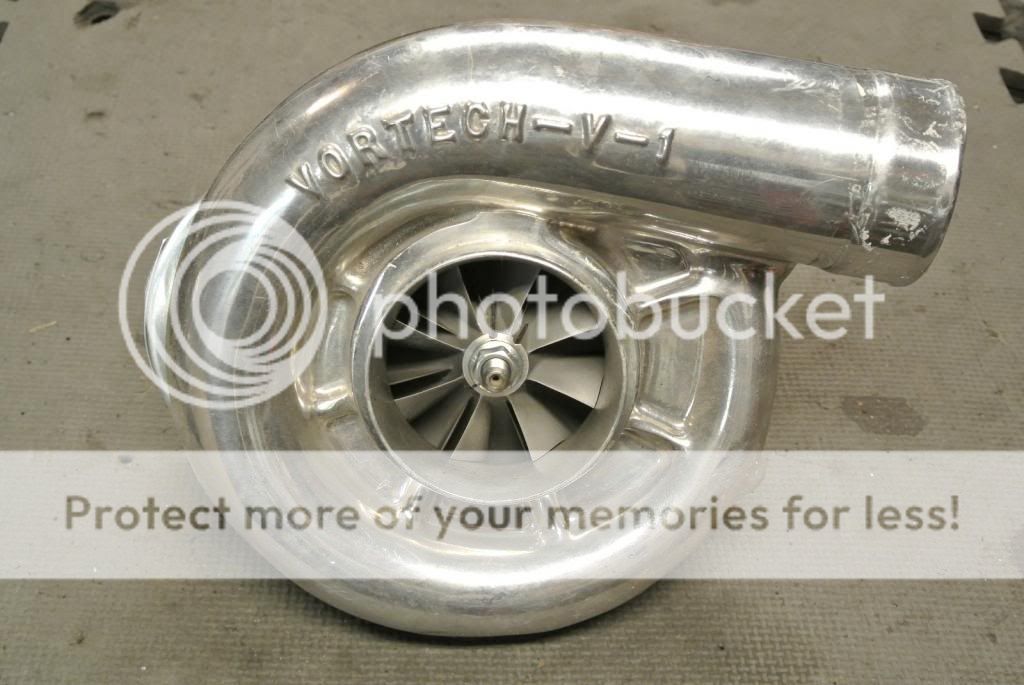

this is the Vortech V-1 S-trim that i bought, now i had no speculation that this wasnt the right headunit for my 04 GT but i showed it to a buddy of mine and he swears up and down that its not....
some clarification?

depends if it's CCW or CW.. it looks like it would fit based on what I saw but it's rotation is what dictates whether its compatible.

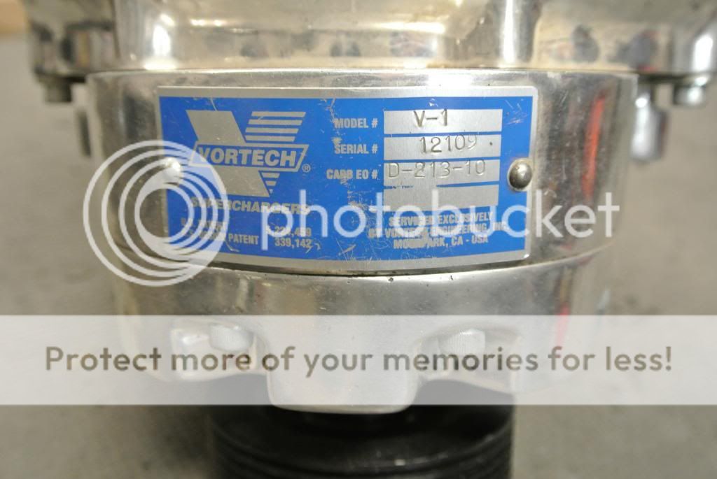

hmm well i got it off ebay. seller said it was on his 99' GT. there isnt any dead giveaways? i have pictures from any angle you could think of if it helps.

Needs to be CCW

To get the pulley size.. I believe it says on the pulley itself. If not measure it!

Find a used set of 03/04 cobra injectors(39lb) or some frpp 42's, both will work perfect. and the best way to figure out what rotation it is is to just call vortech when you receive it, give them the numbers they need off of it and they'll tell you.
