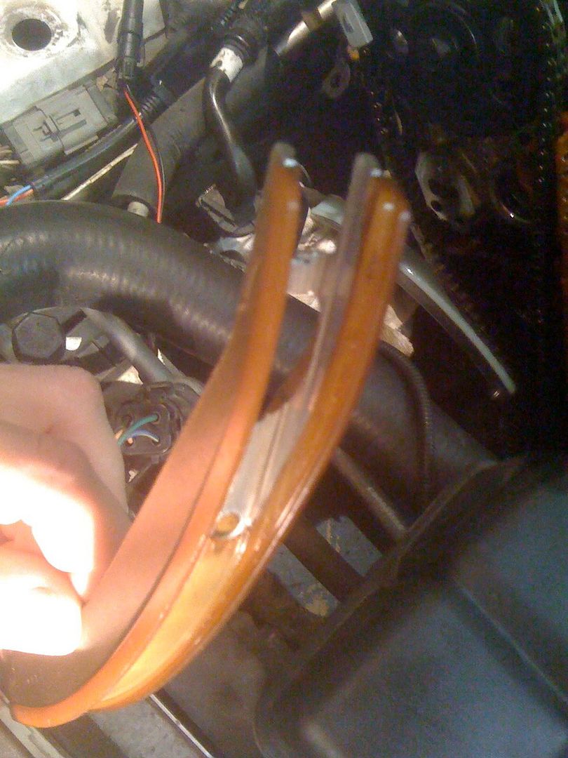

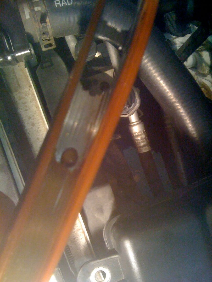

Is your tensioner arm and tensioner supposed to look like this? lol cause mine did

lol yeah, a new tensioner arm and tensioner should solve that

the chains still look perfect. had new cam gears anyway and just getting a new tensioner arm and tensioner. the left side is fine.

well i reused the stock cam bolts, put new cams in, new gears, new valve springs, new tensioner arm and tensioner, thats about it. nothing else looked worn nor close to it. just that tensioner.

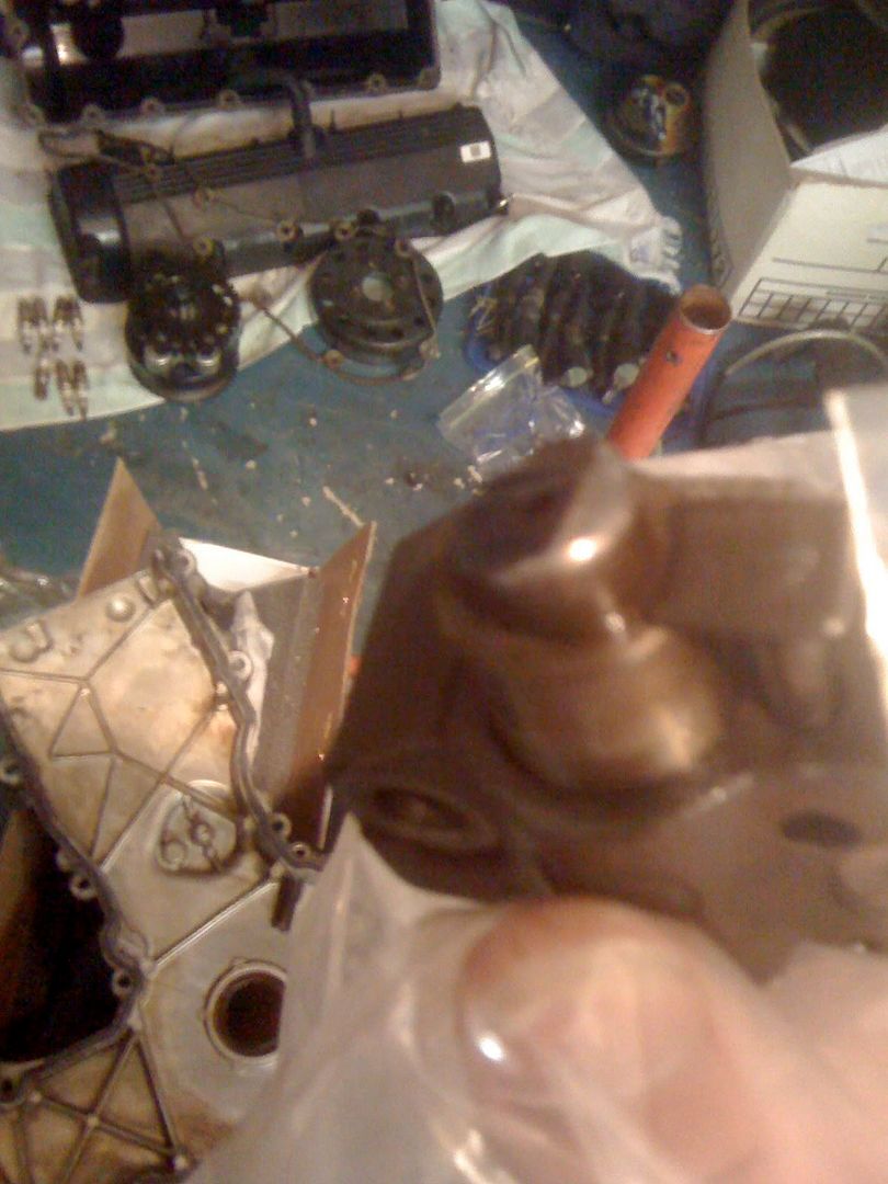

full setup being.. just the tensioner and arm, or chains, gears, etc.?
let me rephrase that
should i just replace the worn tensioner and arm, or should i get new:
chains, tensioner arms for both sides or just the one, new chain guides, new crankshaft gear?

Why new cam bolts? I've never heard from anyone that you can only use them once. This is getting to be very expensive just for a ****ing cam install. I think I'll just replace the tensioner and arm and that's it. Chains sag but that is what a tensioner IS for.

i ordered 2 new chains, a new guide for the right side, a new tensioner, and a new tensioner arm.

im only replacing the right side because its worn down way too bad. the left side is fine, plus the left side tensioner is on top so there isnt as much pressure on it as there is on the right side where its on the bottom. if the left one was worn id replace it, but it isnt.

Tensioners wear out because of stretched chains...
replace them both, on both sides... its the right thing to do.
