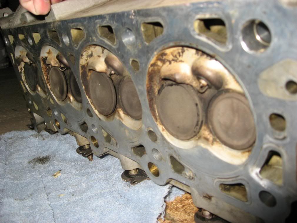

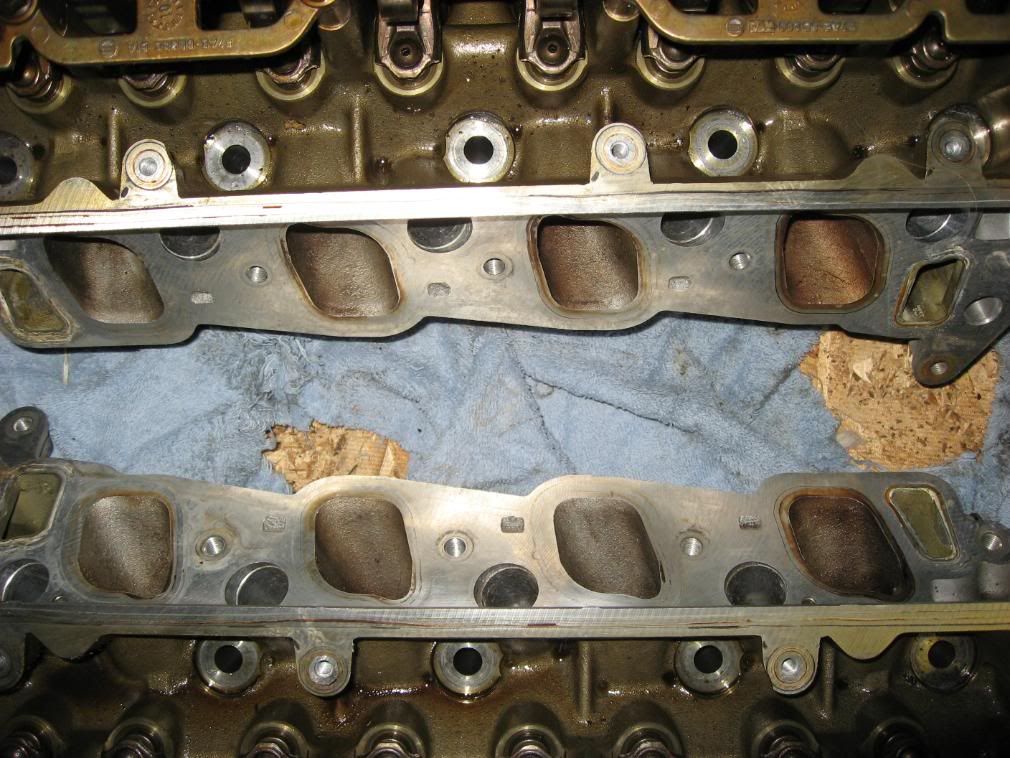

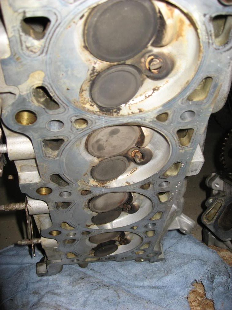

And also, are these heads clean enough to be put on:
The majority of the head surface is smooth to the touch (and the minor imperfections are nowhere close to a hole). I'm really looking for people who've done this before- I can't afford to mess this up :(

Those Combustion chambers should be cleaner IMO. But it looks like you have the parts good. WHile ur in there, I would think about a shorty header. YOu can bolt it to the head, and then put the head on.

I've cleaned out the chambers on the head in that first pic a bit since it was taken, but I'm not worried about that- it's just going to get all crudded up after a few hundred miles driving anyway. What I'm primarily concerned about is the seal. I don't want leakage or blown head gaskets.

Haha yeah I've done the fingernail thing. The stuff I couldn't clean up with carb cleaner and a shop towell, I scrubbed off with my thumb nail. I have thick nails :p

those gasket surfaces really need to be cleaned up, the combustion chamber is fine.

How would I go about cleaning them? Again they're smooth to the touch / nail. Looking down it there aren't any bumps. I've used a whole can of carb cleaner and some engine degreaser on them. What you see in the pictures are just lines- you can't feel them at all.

I use one of those and one of the pads you see laying there. Just use low rpm and keep it moving dont stay in 1 spot to long. Do not use a wire brush or sandpaper. That is aluminum and will mess up.
Try using a scotchbrite pad and some carb or brake parts cleaner. That pad I use is just a scotchbrite pad for a grinder.
