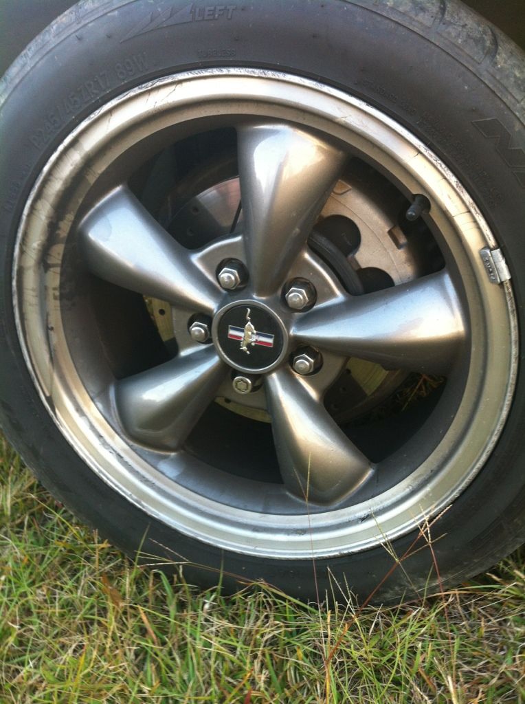

First I cleaned, A LOT, and I mean A LOT! I had to clean the backs of my wheels which have always been neglected. Took me about an hour :(
Next I prep wiped, sanded with the scuff pad, and prep wiped again.
Then I tack clothed until it was clean and dry.
Next I laid down a 3 coats of primer sealer about 3-5 minutes between coats.
Then I left it for an hour or so, and then I laid down 3-4 coats of yellow paint 10min between coats.
I killed about an hour or so eating subway and watching Duck Dynasty. After waiting I taped off the stripes. Taping is not my strong suit so it's a little rough.
After taping I laid down 5-6 coats of black.
After waiting a little bit I took the tape off and started clear coating.
I let them sit overnight and let them sit in the sun most of the next day
Notice old shoes for painting^

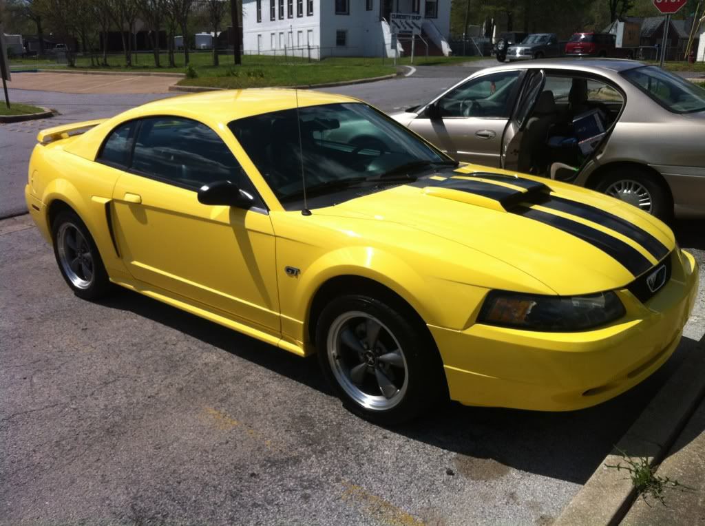

Decided to take some pictures while I was at my school the other day:

It'll buff out...
5,379 Posts
Black and yellow black and yellow. Look great man, I was going to do the exact same thing using that very thin pinstripe on the edge of the rim, but I've decided to keep it polished aluminum.
960 Posts
Discussion Starter #9
Haha I actually listened to that when I left school earlier.
I thought about keeping the aluminum lip, but they sell them that way and I wanted to have something different. I looked around and found Zinc's write up and I set my mind on it. I've been waiting for months to do it.
291 Posts
Looks good, though I would have removed the Weights and painted where they were and had them re balanced with the weights on the inside. Otherwise not a bad job at all.
960 Posts
Discussion Starter #12
I kinda spent all of the little bit of money I had on the paint and supplies. I'm only in high school haha.
