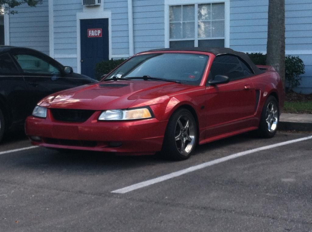

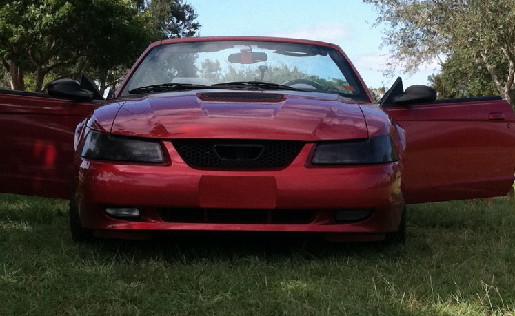

I started off with the OEM 99-00 clear chrome mustang headlights. I didnt really like them much so I decided to black them out with some vht nightshade

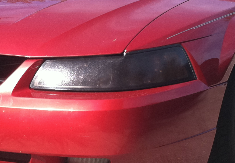

I loved them for a while, but after a couple of months they became yellowish and the clear coat started to break and become uneven, and it started getting really hard to see at night
So two weeks ago I sanded them down to what they originally looked like

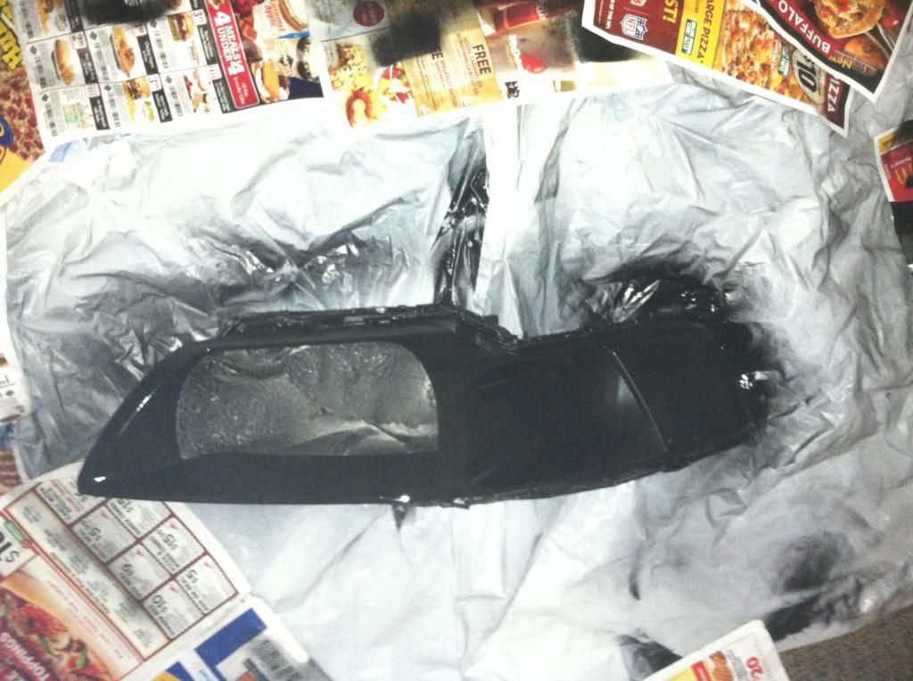

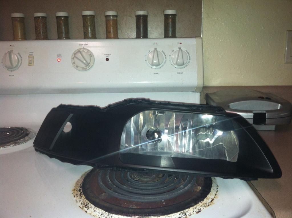

So finally I decided to paint my stock ones, I took them apart, painted and put back together. tomorrow Im going to seal them and install

How did you take them apart? I'd love to rip the orange reflectors out of my stockers.
( o )( o )
276 Posts
Heat the lamp up. Some people use heat guns, some put them in the oven. You will have to be careful and pry the lens away from the housing. Also be careful with the black silicon and not to get it everywhere.

To do it I popped them in the oven for 8 minutes at 250 degrees and used a flat screw driver to take them apart (scary) then popped them back in the oven for another 8 minutes and pit them back together. Then I sealed them with some advance auto parts silicone.

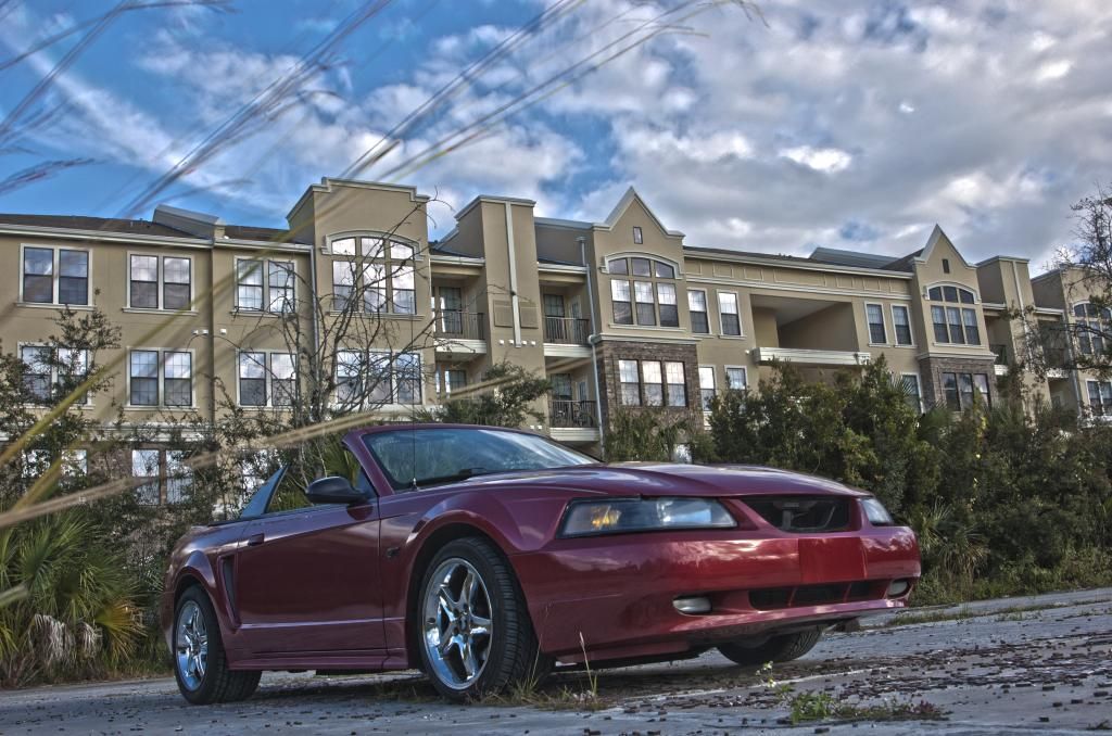

Here are some pictures of the final product:
before:
After:
I realized the ISO was really high after I took these pictures lol
Not too bad for 7 bucks (the silicone I used to seal them)
