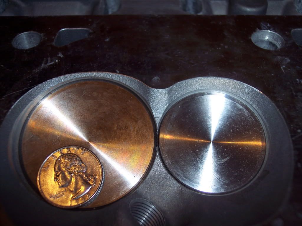

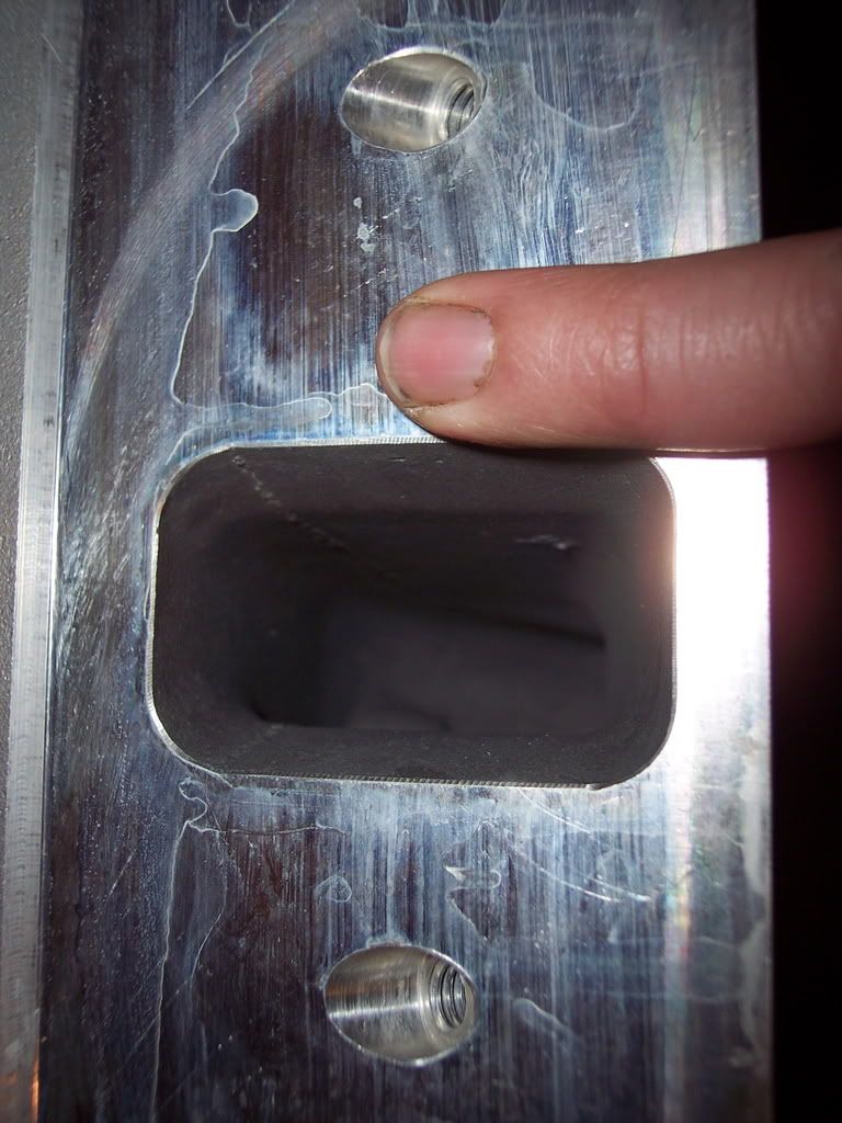

Ahh,,, The best China has to offer...2.02/1.60, 60cc chambers, 210cc runners. The casting isn't too shabby at all, I was pleasantly supprised.

Did you get those from tristate? Procomps? Better check out the valve train.
They are from a company called performance engine and machine. They are assembled with good stuffs tho. They assemble to your specs. They don't have a crazy ammount of options, but you choose the valve size, valve material, springs exct... I went with 125# installed 300# open, and ss valves.

559 Posts
125 on the seat will barely hold a comp xe series of cams, 150 on the seat is the minimum I like to run, dont plan on using any cams that have an aggressive lobe, valve float will kick your ass in 2 minutes flat. Need way more spring, unless your running a flat tappet, then your fine.
Your site says your AFRs are assembled with 120# seat pressure springs????
559 Posts
correct AFR sets them up from the factory and thats the old 11/32nd's valve train package (which is why everyone always commented on the junk parts they came with), they have since started using 8mm valvetrain with 135 minimum on the seat. :)
