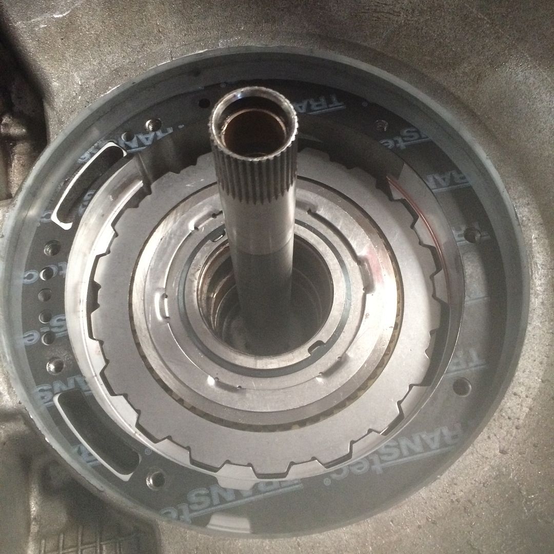

anyway I am back to work on the transmission. So after we got the center support in on that last picture we put in the forward sungear with its torrington bearing.
then the sun gear shell gear, and its bearing, that is the bearing. that was destroyed when I took it apart.
after that you install the overdrive band, and then the reverse clutch assembly. this is an area where we did some improving. this groove is where a snap ring resides. it is frequently broken on these aod's and the snap ring off in the aod. this snap ring holds the roller clutch Assembly in place. the monster transmission kit and indeed most high performance rebuilds recommend replacing that snap ring with a spiral snap-ring and lock. fortunately my snap ring groove was in good condition. sometimes that lip is broken or rounded off and you have to replace the reverse drum.
this is the original snap ring.
and the replacement.
so once that is installed and seated the second gear pressure plate, clutches, and steels are installed. this brings the case almost all the way up to the top.
next we have to install the front pump. since I was not sure if I damaged the front pump when my seal leaked I had planned to just replace the pump and seal so I found a n.o.s. front pump on eBay complete with new seal
I installed the sealing rings and the piston with new lip seals and the set the total end play. we struggled with this a bit. the way you do it is once you have the main transmission assembled you take the front pump and install it with the original thrust washer and no square cut gasket then tighten two bolts and then place a vice grip on the shaft flat at the base and press up on the tail-shaft then slip a feeler gauge beneath the vice grip. it should be between .020 and .045 inches. At first we could not get any end play we tried everything but it was just tight. we used the thinnest thrust washer and everything. finally we decided to put it together and do some reading on what to do now. so we put the pump in lubricated well and torqued the bolts to 18 foot pounds then inserted the input shaft to make sure everything turned properly. after we did that we decided to check the end play again and at that point it seemed we had a bit of end play so we measure id and mine measures between .025 and .030 so it is good with the thrust washer I am using. if it is too much end-play you have to use a different thickness of thrust washer. and the monster kit comes with a selection.
the top one is the one that was in the transmission,
next the monster kit comes with a new A plus overdrive servo, spring and lock ring that is also an upgrade over stock.
I also ordered a hardened input shaft and it should be here soon but UPS is having weather issues lol.
next step is to install the governor and the valve body.
