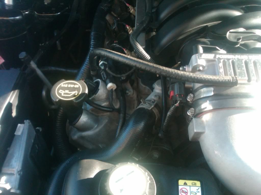

Ok i was cleaning my throttle body and maf sensor cause my car was idleing weird. Anyway when i was finished i saw this not connected to anything. I was like wtf :confused: cause i know this use to b connected to my intake. I just a zex nitrous kit put in and it seems they coverd where this use to go and put the nozzle there. Can i just put a breather on there?
509 Posts
Do I just take the tube off and put a lil filter there?

lol yes, take the hose off and put a mini breather in its place..

Make it look like this. K&N clamp on filter. It's either 3/8" or 5/8", I can't remember which sides the sizes are on.
2,465 Posts
Smaller size diameter (3/8") on the passenger side, larger size diameter (5/8") on the driver side.
When you get vacuum caps for the PCV inlet/outlets on the intake (you definitely want to if you're spraying), make sure you get the right size -- I found out that the heat will cause a smaller size cap to split over time. None of the multipacks for the vacuum caps at my local Carquest/Autozone/Advance had 5/8" caps, but there is a radiator hose cap in that size.

Where eould I put the vaccum caps? I only have the opeing on the side of the intake manifold. My intake where the other one goes is were the nozzle is now.
13,629 Posts
Just plug the one opening.

Ok thanks everyone for the help.
