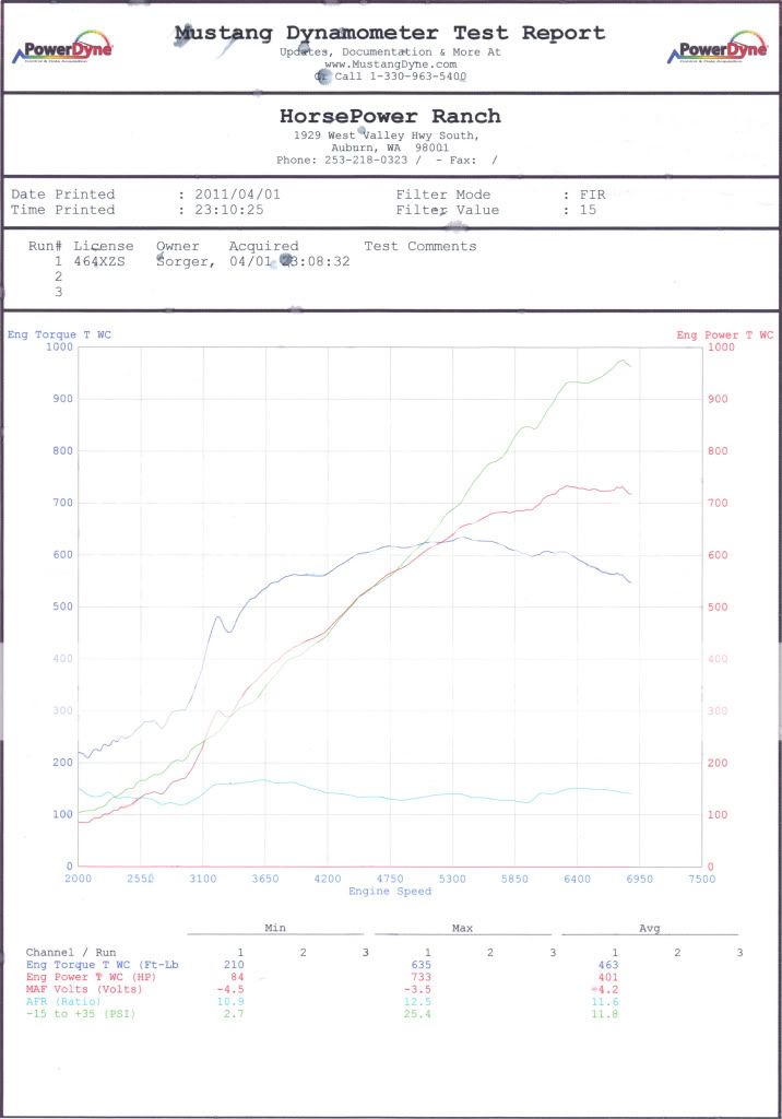

Just got home from from working on my car. It's starting to show pretty good numbers. 11.6 A/F, 23 degrees of timing, and 24lbs of boost. A little more work on flattening out the A/F curve and it's done. I don't think I will push it any further.

O man those are sum nice numbers. What kind of compression are u running? Im in the process of getting a 302 stroker shortblock but not sure if i wanna drop compression or leave it the same. Right now my car is putting down 482 rwhp on the D1.
My compression is 9.73:1. This tune was on 114 octane race fuel.

if you have meth or E85 I wouldn't do below a 10.1:1.

I wanna go the same route keep compression around the same turn up the boost. And just use meth. I really dont wanna drop it cuz of the lag it will have

I ran the car again today to sort out some drivability issues. It made 743/641 this time. The HP numbers seem to be very consistent. At this point, the D1SC is maxed out. Spinning it faster doesn't create anymore power. I forgot to mention that I am spraying a 30 shot of nitrous to keep IAT's in check.

so are you running a street tune for pump gas and then a track tune for the 114
I have 3 tunes. Pump gas 646whp lower boost and no nitrous, race fuel 698whp, and race fuel with nitrous 743whp.
