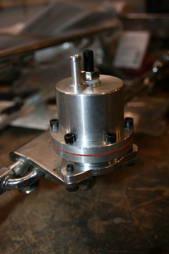

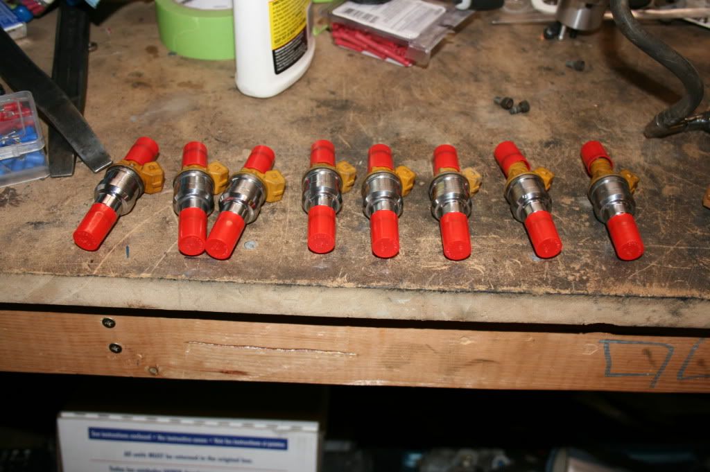

got all the parts today, kirban AFPR, rebuilt flow matched 19lb injectors, and a 190lph fuel pump

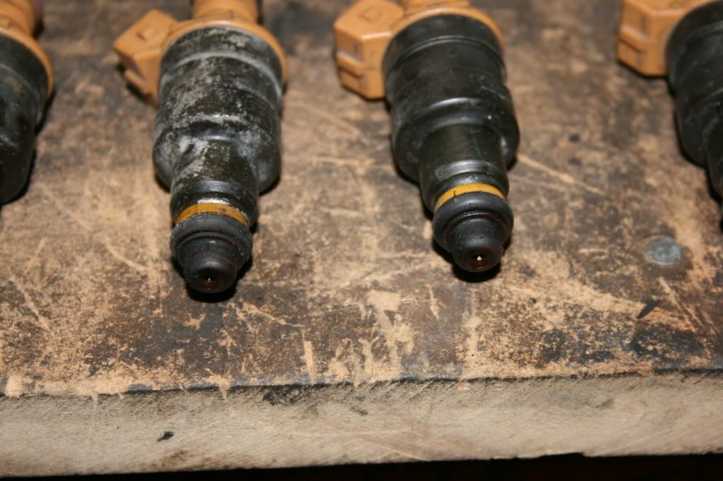

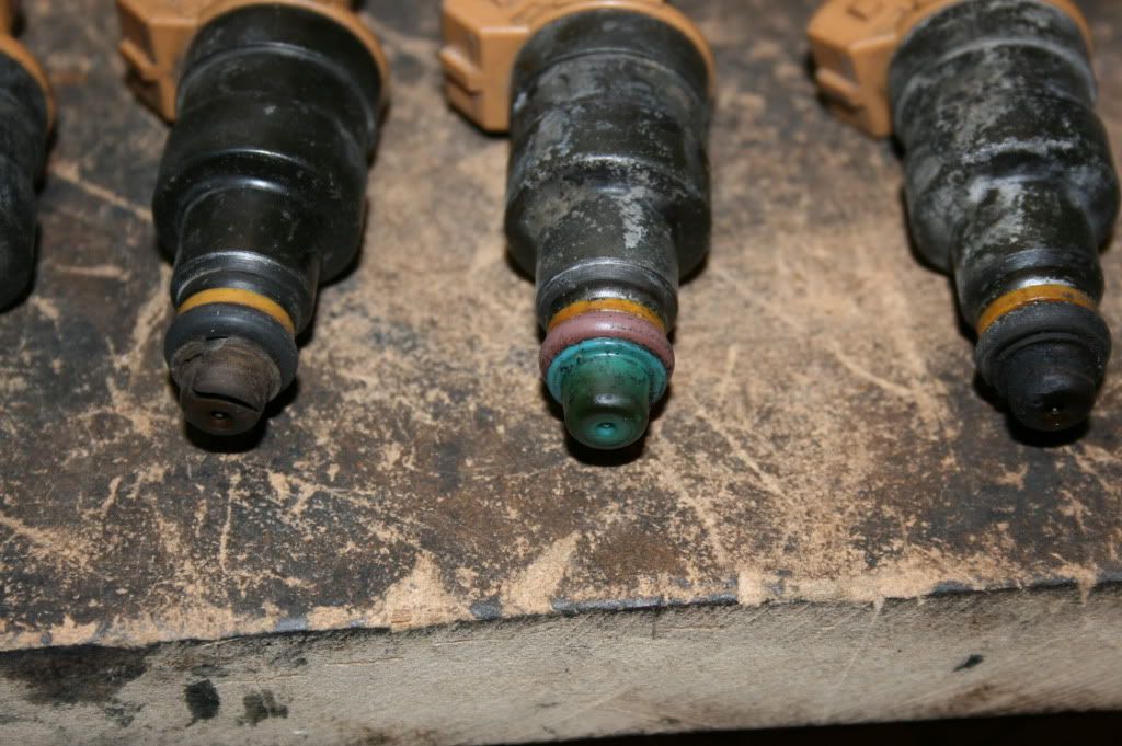

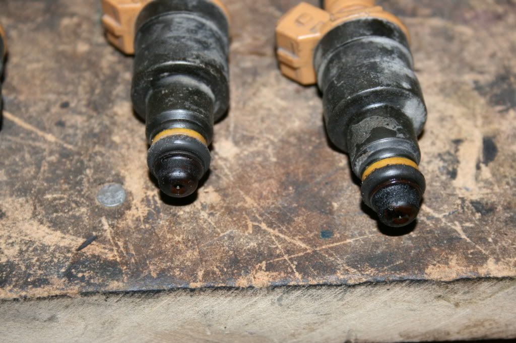

i got the fuel injectors out and it didnt look good, glad i bought new ones, so far i have the fpr and injectors on, but didnt get the intake on cause im frantically trying to find some valve covers to replace the ones i hacked up.

here is the pics, old injectors then new stuff
