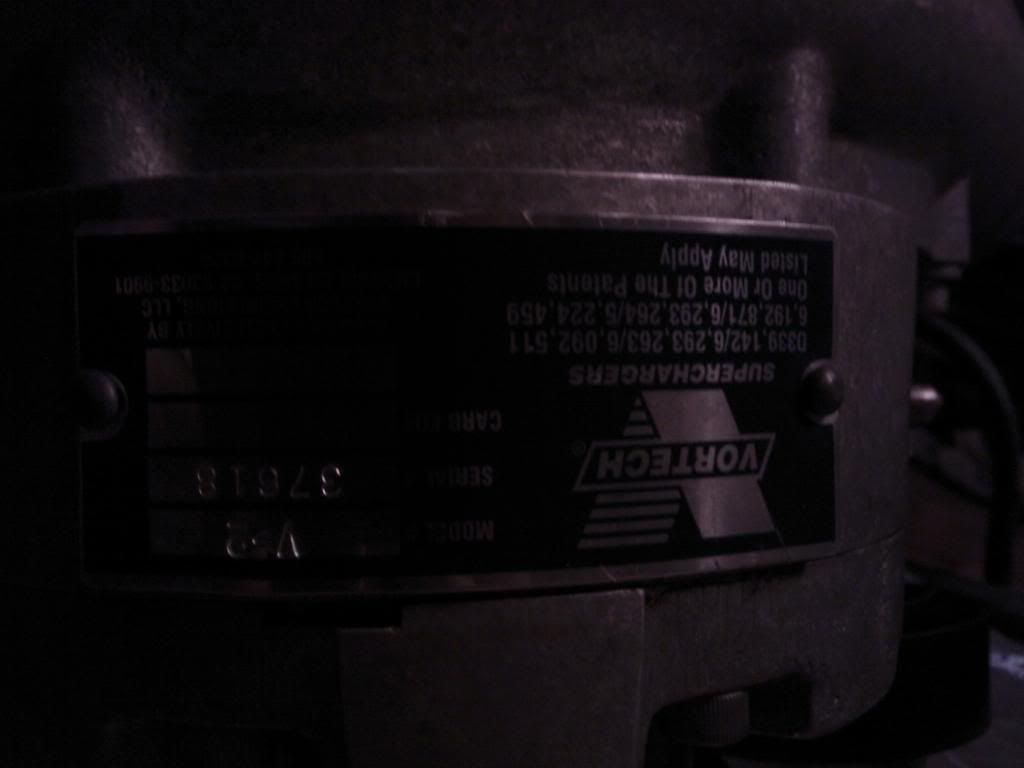

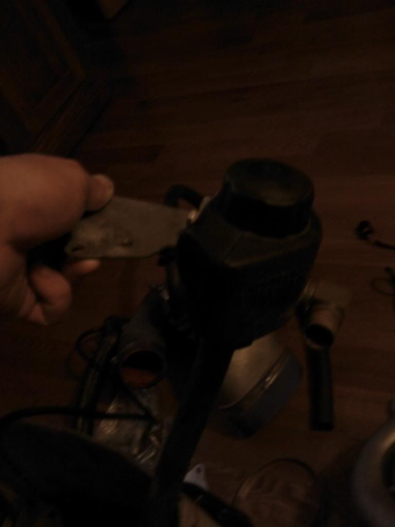

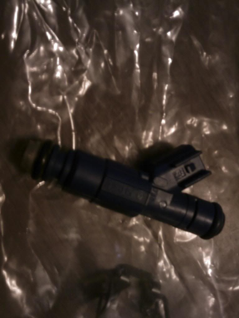

Ok, so I just bought this setup this evening. It's a V2 unit with the charge cooler, 39# injectors, MAFia, and piping. Could you Vortech guys tell me what else I am going to need based on these pics?
1 - I know I need a heat exchanger, but should I buy the standard one or the upgraded one for $450 from Brenspeed?
2 - I need new plugs, think I'm gonna buy the Brisk.
3 - BAP or fuel pump? What to do? GT500 or Saleen or Ford GT?
4 - IAT relocation kit.

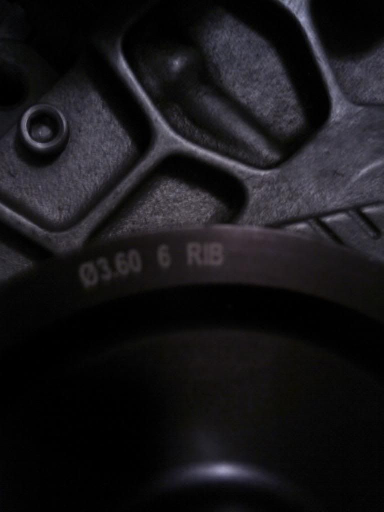

Also, it has the 3.6 pulley installed on the blower already, is that the 10 pound pulley? And do I need to run this pulley to use the MAFia?
What all am I going to need? I have not researched the Vortech much as I was planning on a Whipple but I could not pass on the deal that I got. Also, do you have any V2 guys have advice for tapping my oil pan? I'll be doing everything myself except for the tuning. Thanks

i run the twin gt500 setup with the zone 5 mdm, works good with that setup, and as far as the heat exchanger, the standard one should be fine with 10 psi on it. and congrats on the deal!! im a v3 guy myself

congrats on the buy, seeing as its the same blower i have youll probably need a 3.33 pulley to make 10 psi most people on the 3.6 are making 7-8, but a boost pipe could change that, idk how much the 3v kits need one though. Go ahead and pick up a vortech mini race bypass valve the ones that come with most kits just down right suck!
oh yeah that looks like the air to water after cooler you got there that thing works great!
244 Posts
V3 is the only vortech that you dont have to tap the oil pan. Its not a big deal really.
745 Posts
I would assume you have the 10lb pulley since you have the charge cooler and if you are only running the 10lb pulley a BAP would get you by. and as far as the heat exchanger I would run the bigger AFCO one. Just one less thing to by later on when you are craving more power. I will look on my pulley at home to see what size it is and let you know.

So I think I need a pump for the coolant for the heat exchanger and Power Cooler, right? If so, what I can buy for that?
03-04 cobra pump or get one from vortech....Also I did some research and found the 3.6" pulley to be listed as a 10lb pulley. I seen in another post that some one noted that you will need a bypass valve....You should not forget that piece either.
