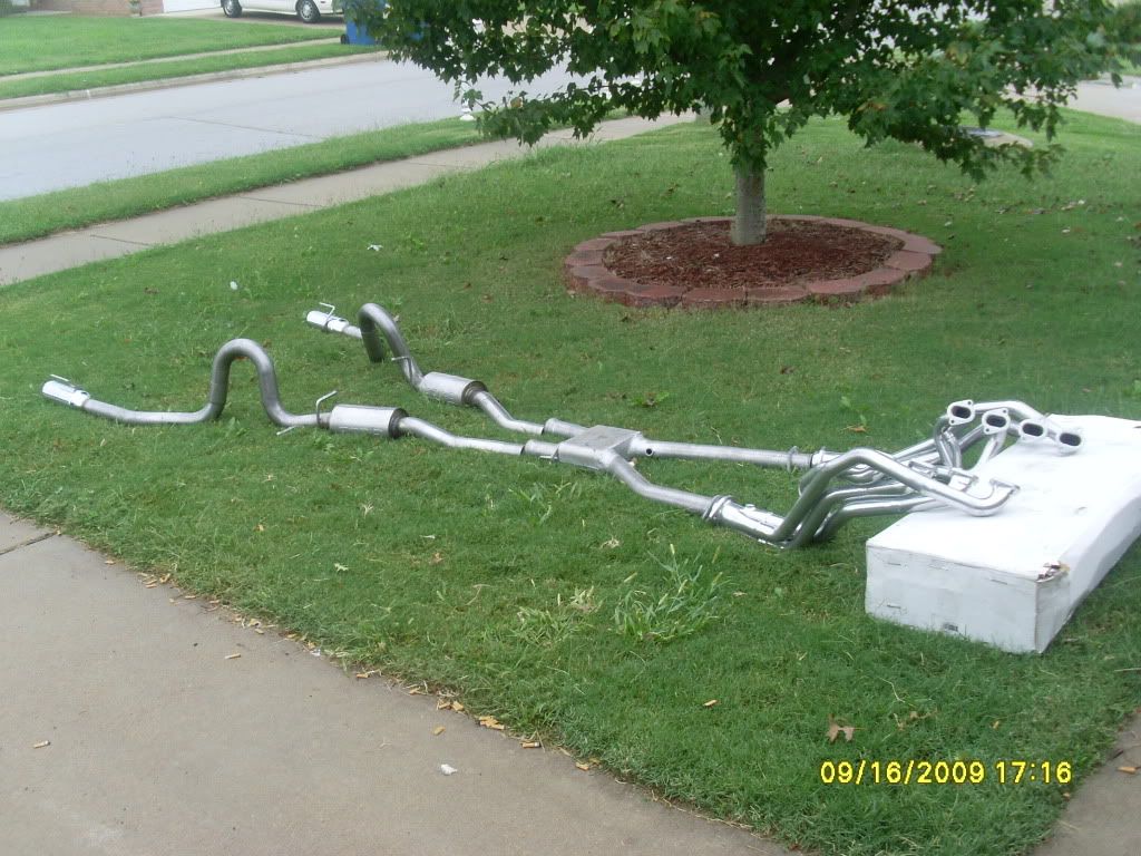

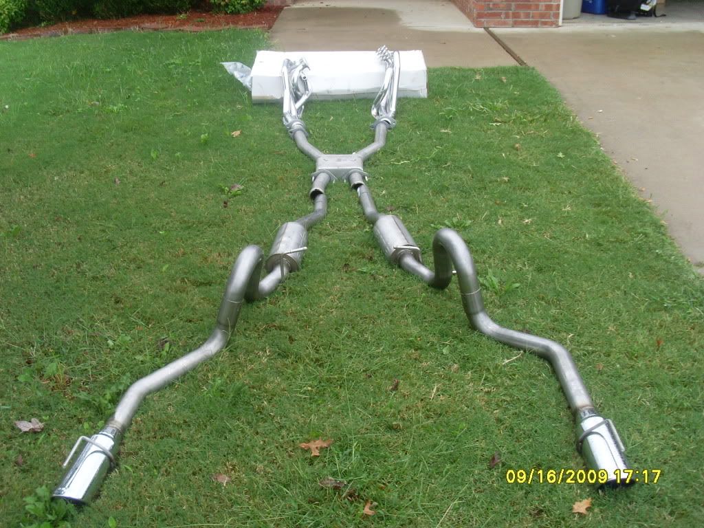

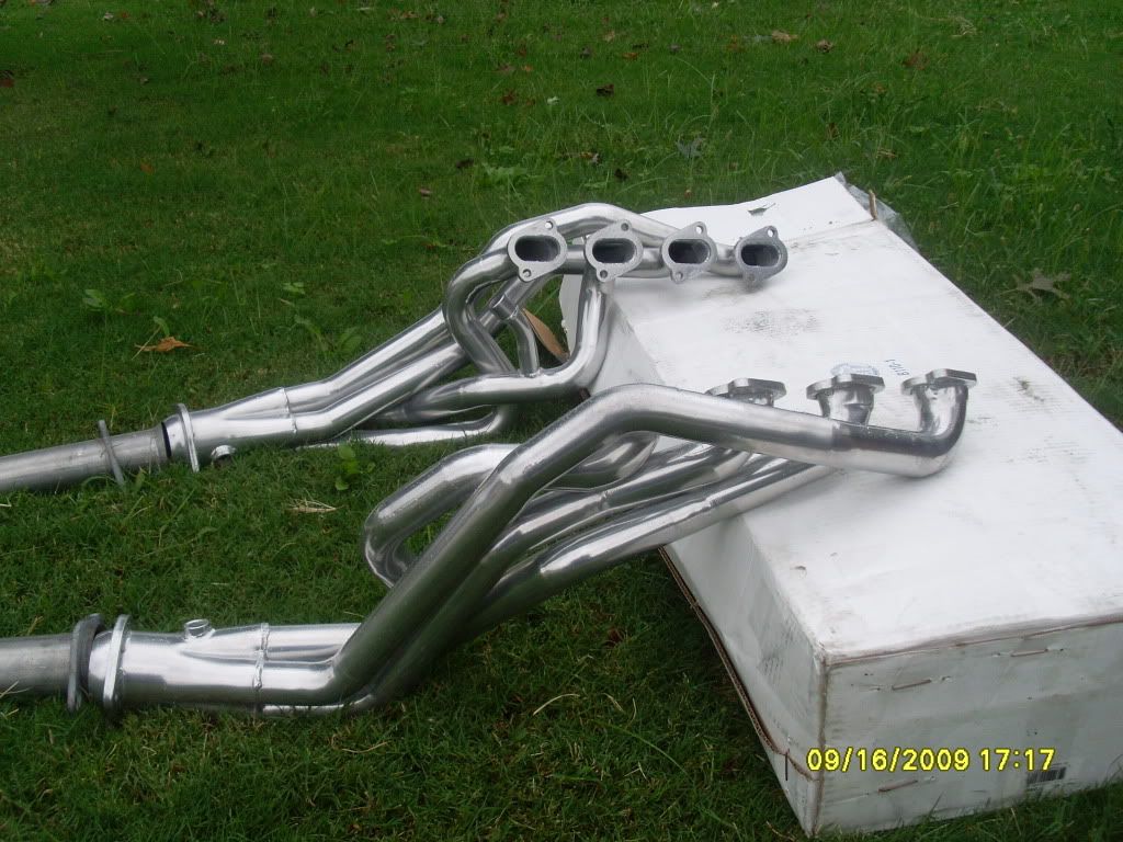

some may know rob broke a secondary chain on his car, he called me up to work on. i went and go it and here is where i sit on it so far:

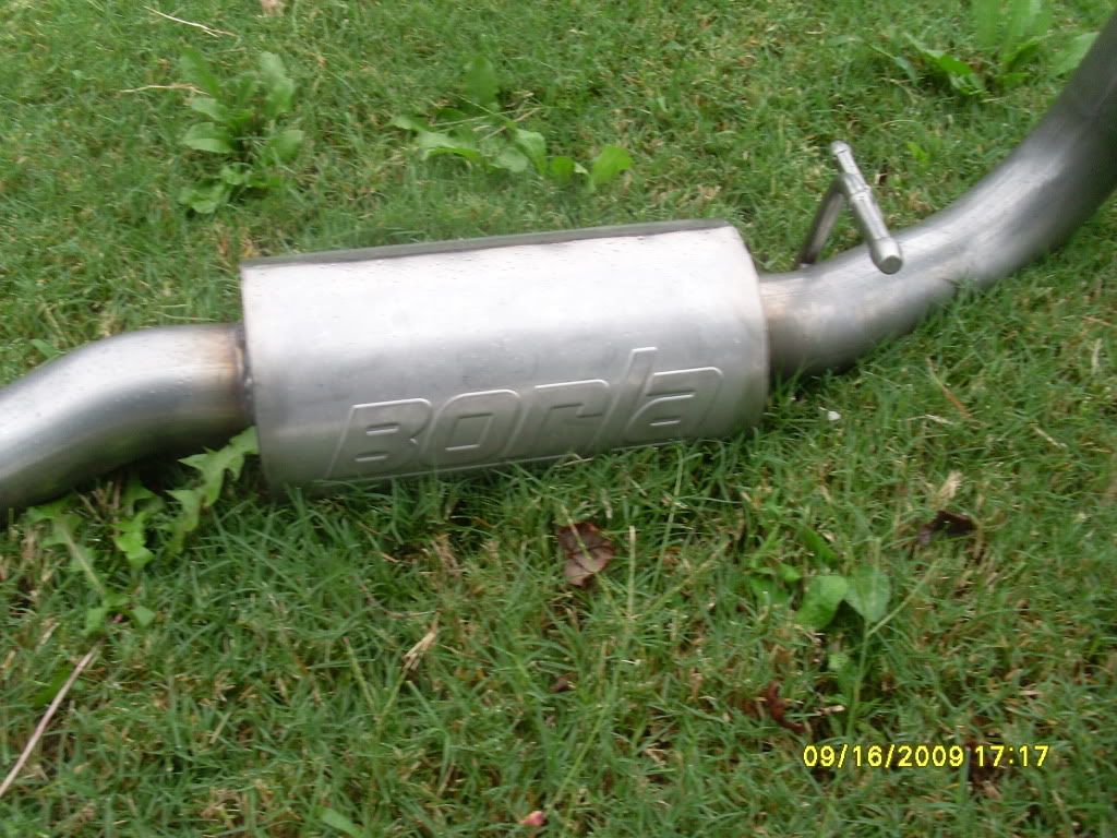

I wish I would have done pics of my exhuast like that before I put it on, how much power you think you get out of this rebuild?

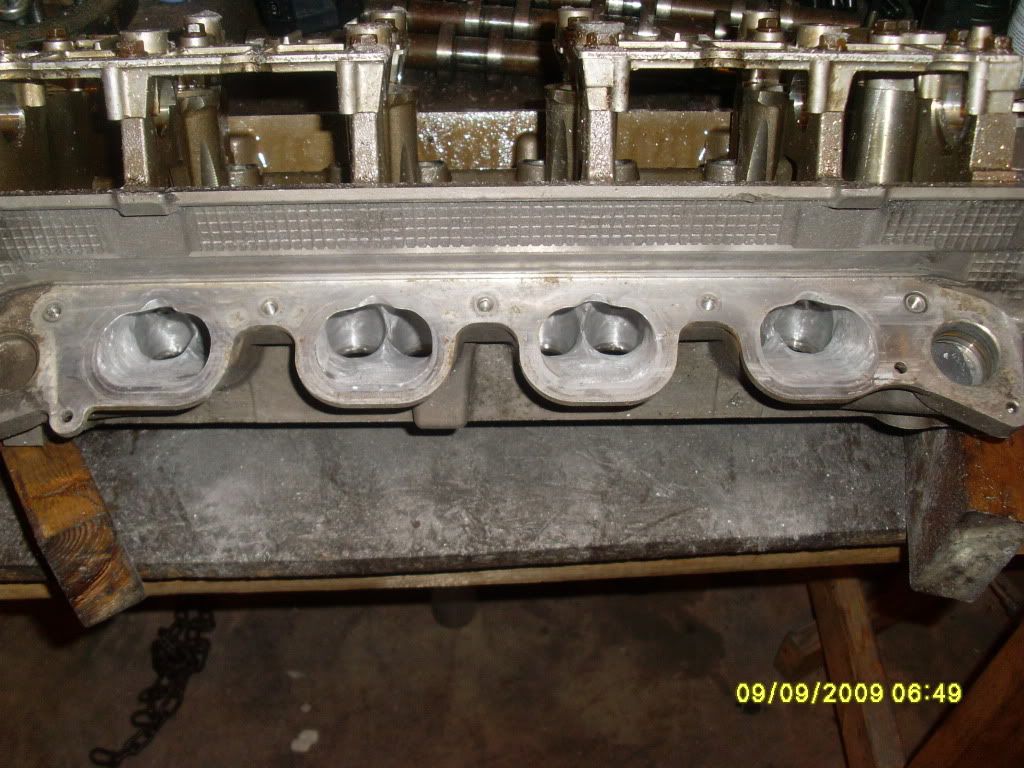

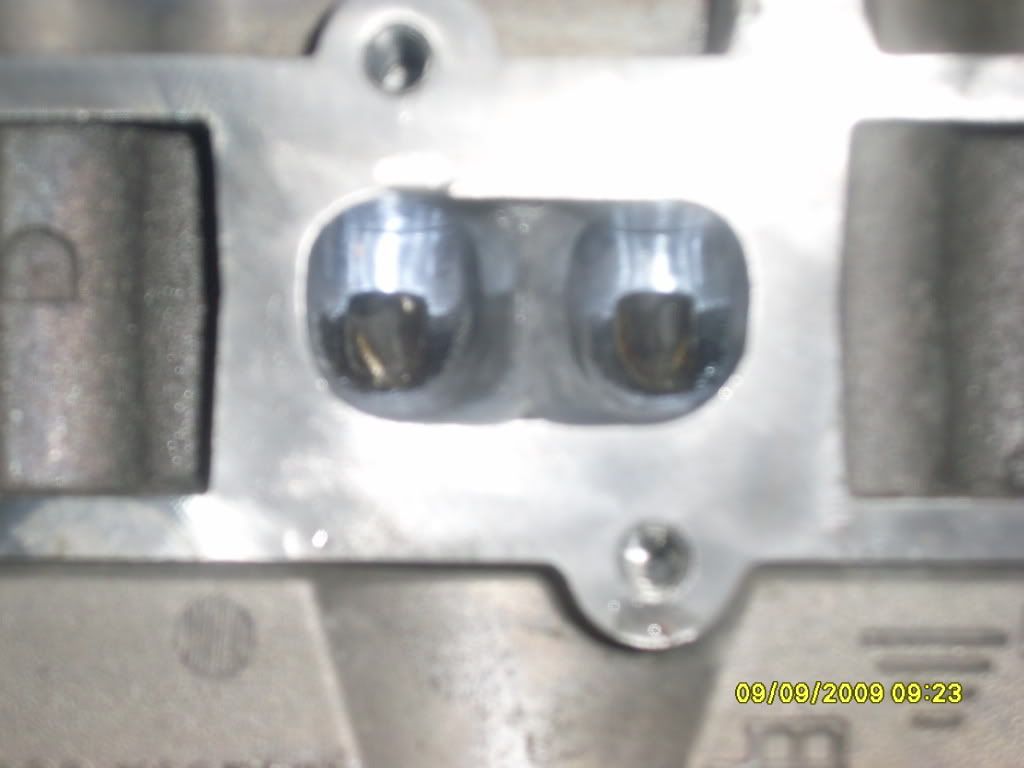

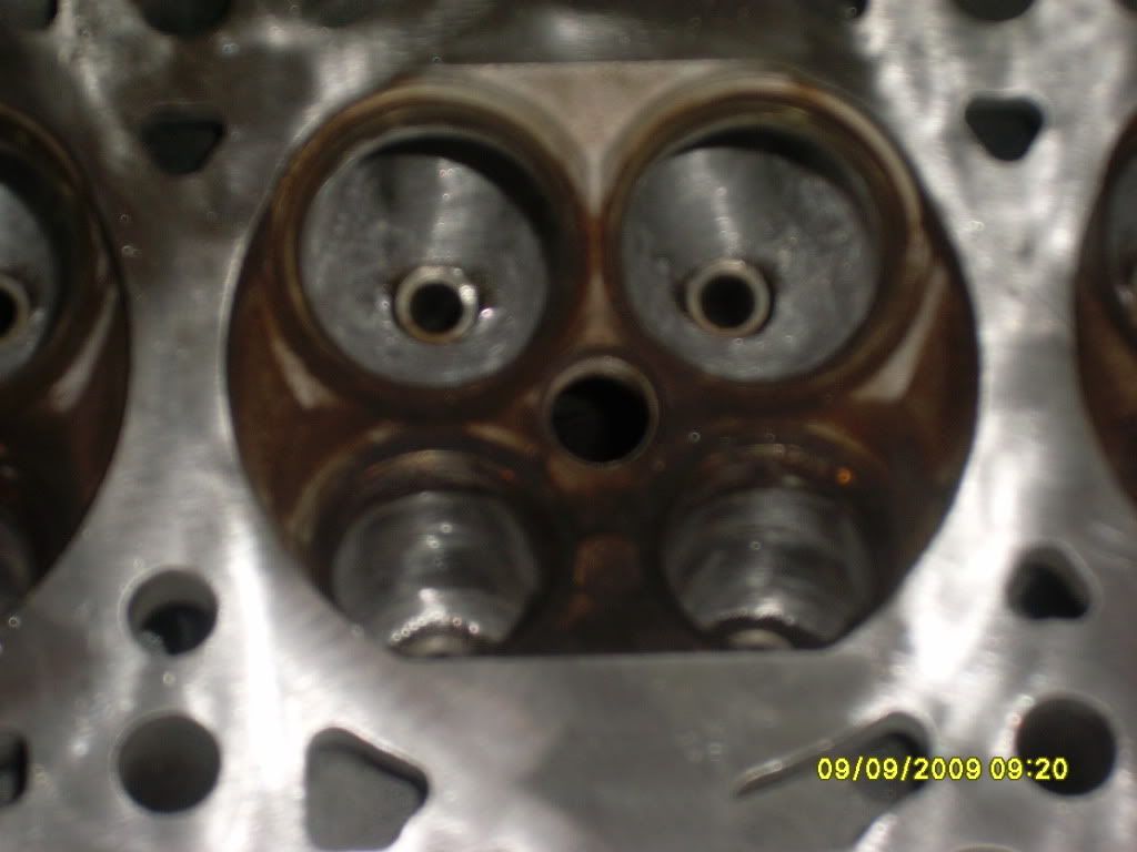

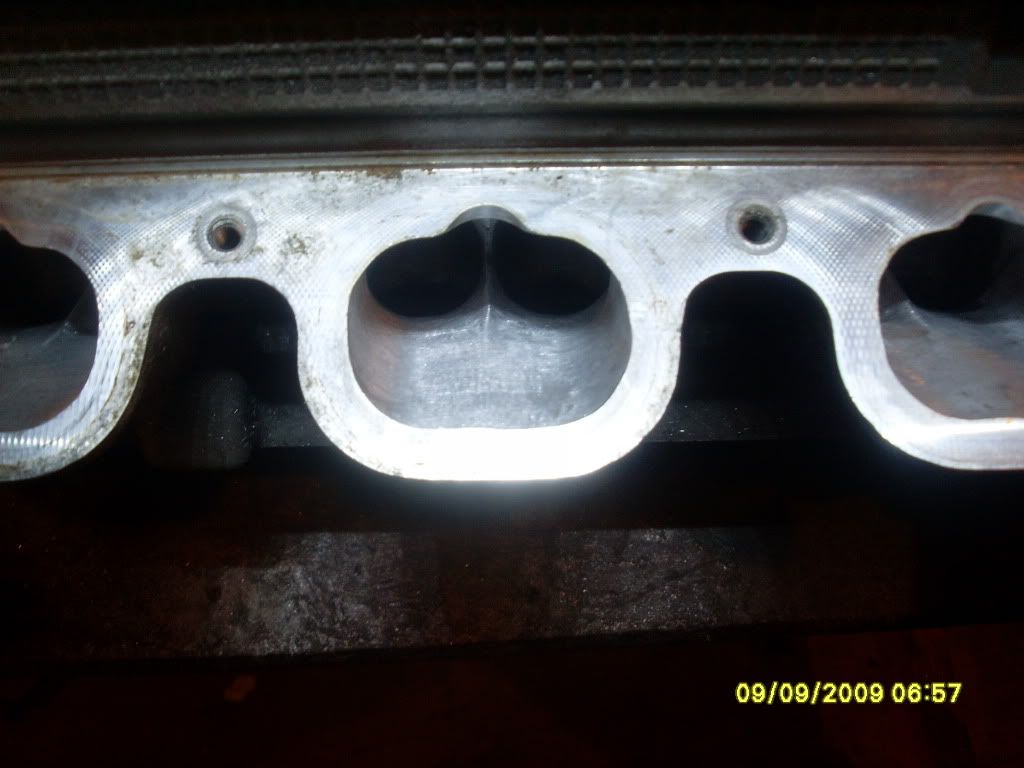

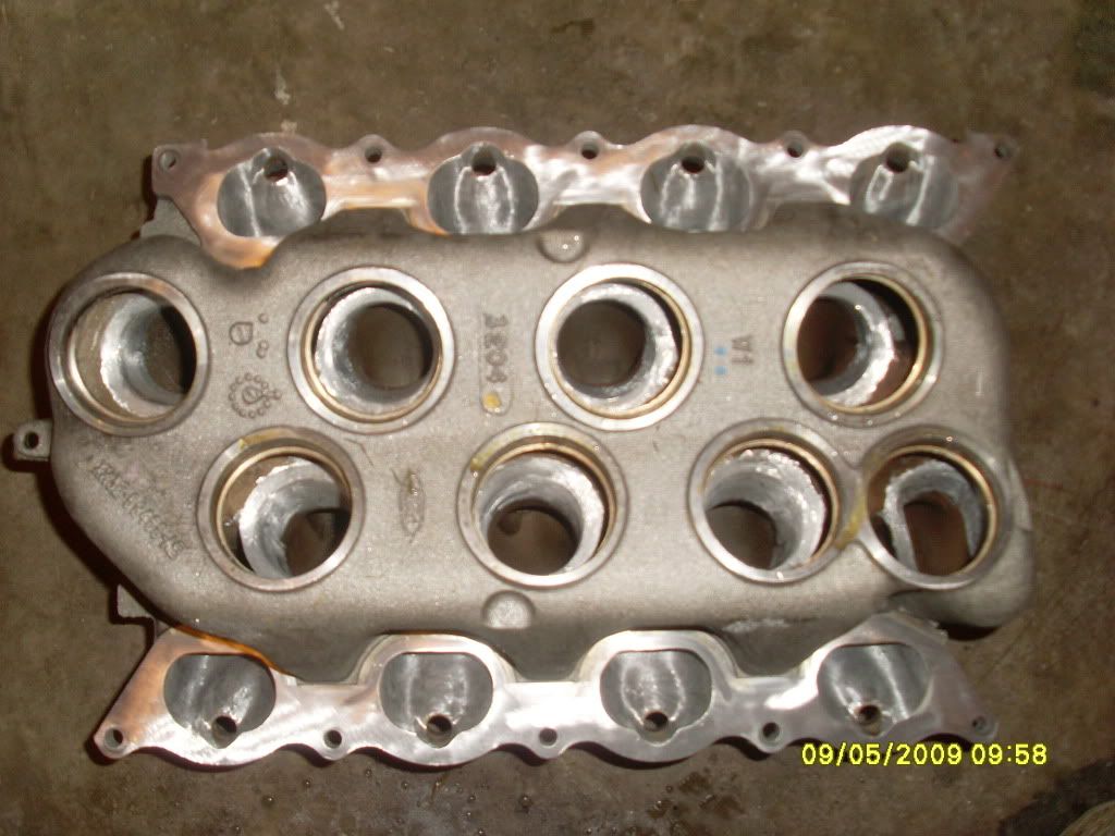

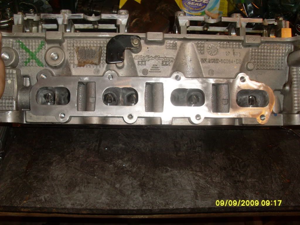

now for the specs:
ported lower section of lower intake manifold
my "stage 1" ported heads
fr500 cams, springs, valves
mac lt's
mac prochamber
borla stinger cat back
C&L 95mm MAF
and a new fuel door :D
existing mods:
jlt RAI
ported t/b
ported top hat
ported top half lower intake
UDP's
built 31 spline rear end w/ 4.10's
fidanza lightweight flywheel
spec stg 3 clutch
injectors and fuel pump will be in order soon as well :D
