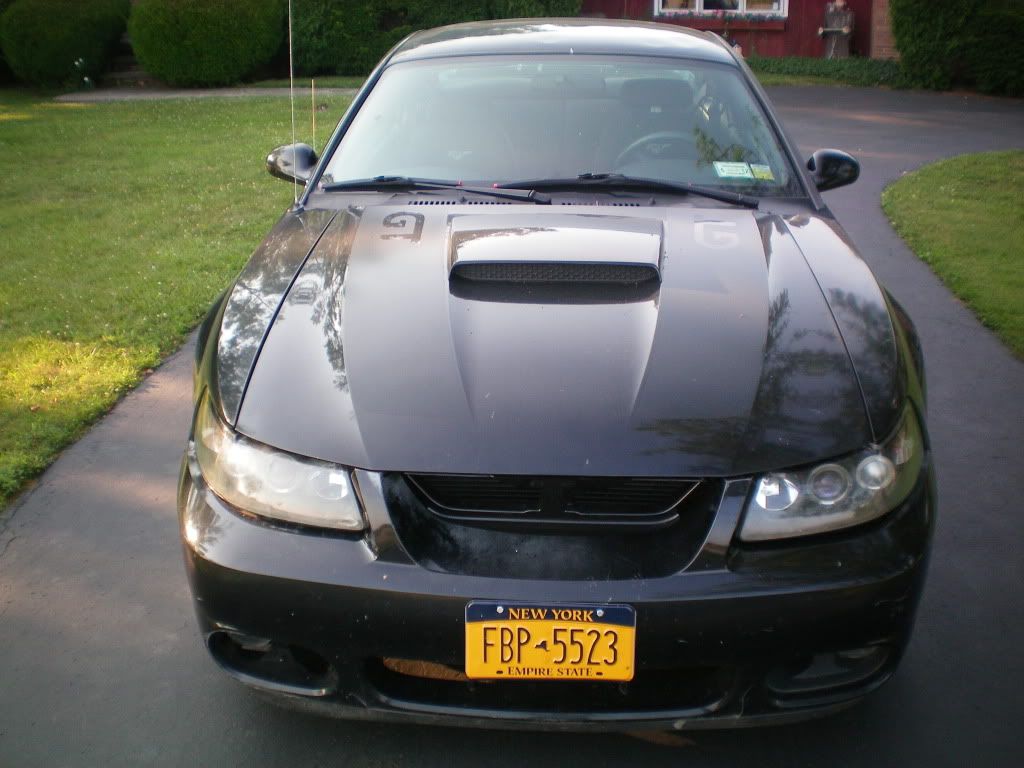

At that point, the car was a complete and total paperweight. Massive front camber problems, electrical problems, locked up brakes, vacuum leaks, exhaust leaks, a caved in quarterpanel, poorly done shaved doorhandles, primer everywhere, poorly installed gas tank, unhooked e-brake, misaligned bumper, misaligned fenders, misaligned hood, bad bearings and destroyed tires. Here it is when I got it:

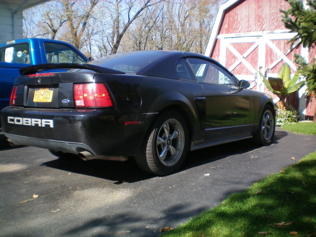

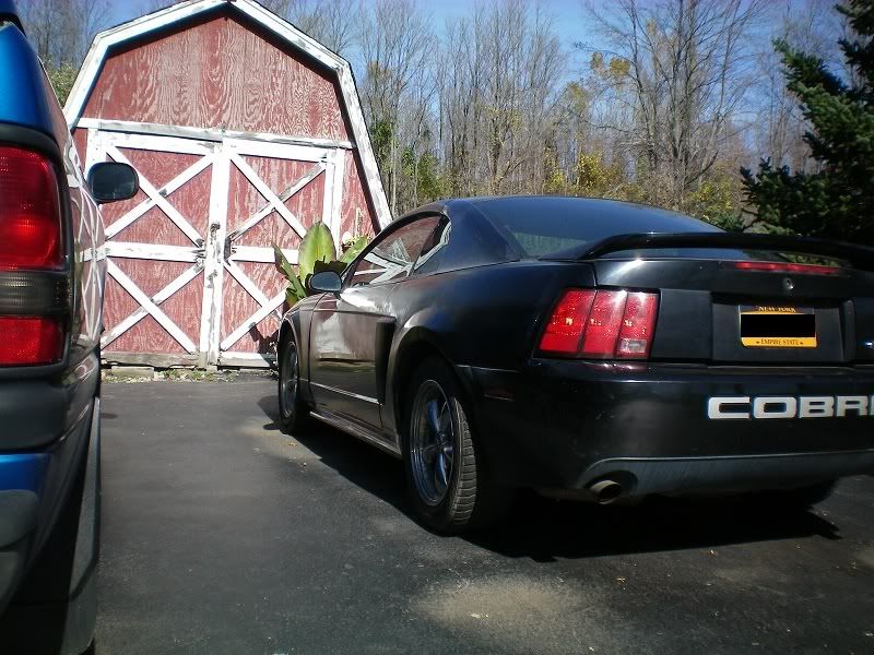

After that, I put a considerable amount of work in to fix all the aforementioned issues, and got it to pass NYS inspection.
Cost of repairs; $500 All work was done by myself, with the exception of the inspection, and the bearing being pressed in, I don't have a press. Low cost, but hours upon hours of labor.

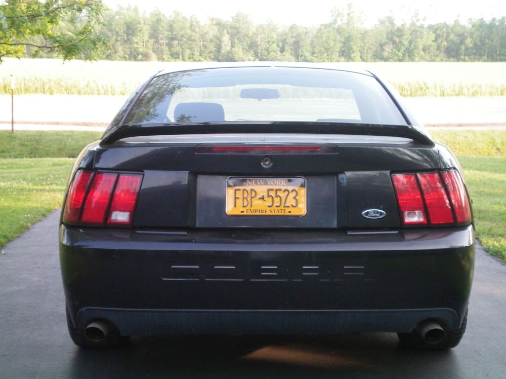

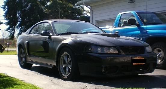

...and then the body work was done...
Total so far: $4000
