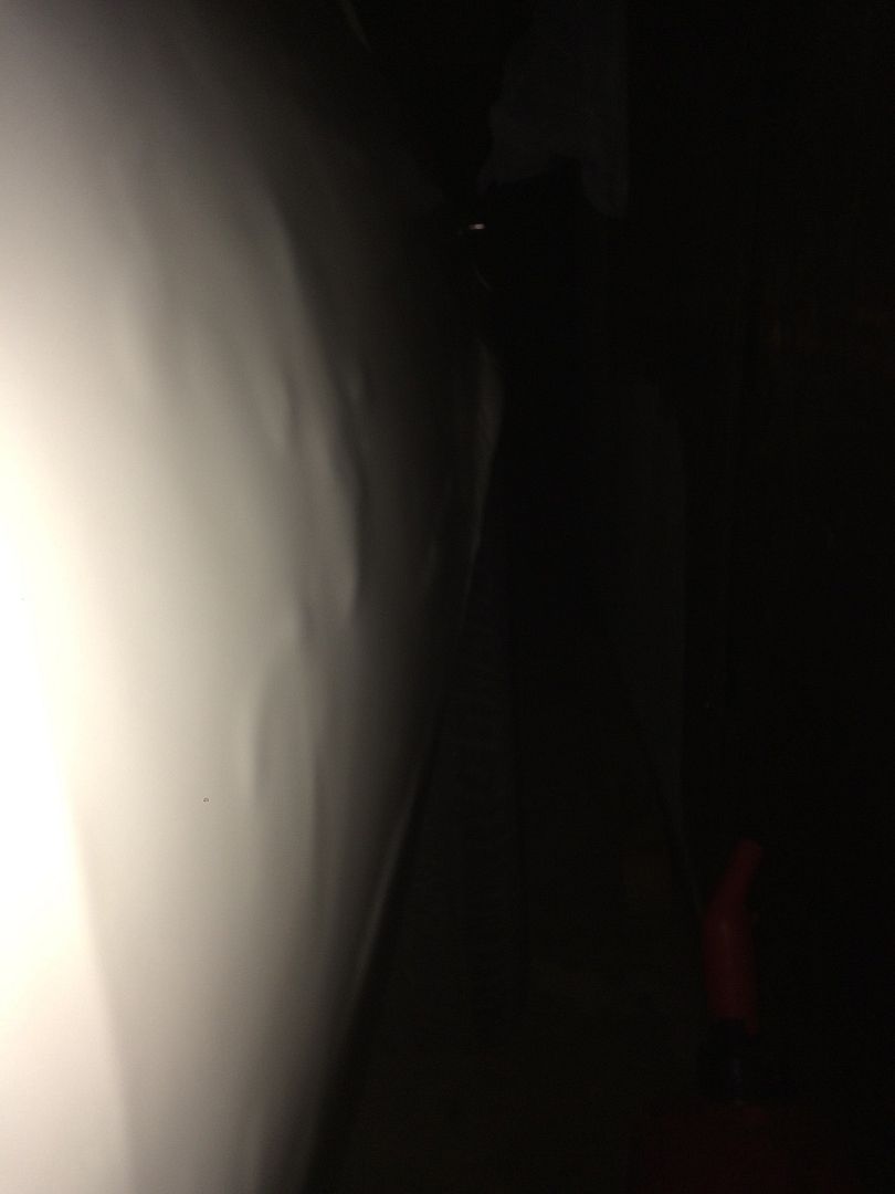

So she's in the process of getting some body work started. I decided to start with the quarter panels. They are not bad the worst is the passenger side just looks like they banged it out and left it there.
That's how it looks. The indent that is in the bottom of the quarter panels was also banged out. So my question is does anyone know the degree of that bend has anyone ever done it?
