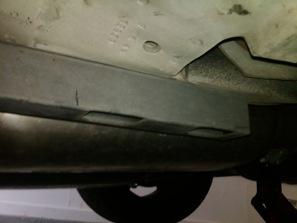

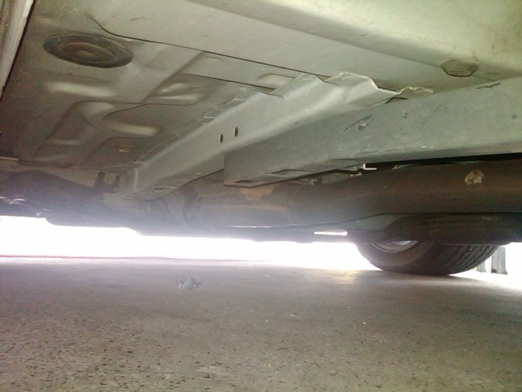

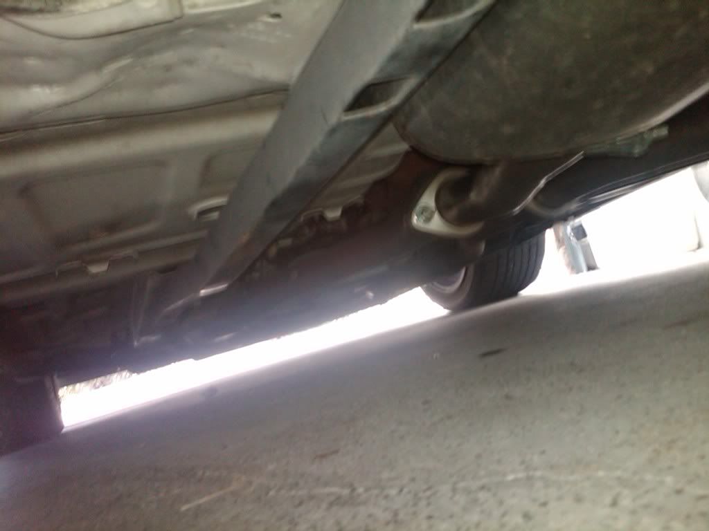

Yes verts have them stock, but like most Ford parts, they are crap. That link you posted is a good upgrade and worth it.

yup, vert do come stock with them. and if i am not mistaken they are only bolted on and are rather flimsy. the mm full lengths welded on would be a good upgrade.

Verts come stock with them, and I think bullitts do too. But yeah like all these guys said, it's a good idea to upgrade. MM SFCs are awesome units.
