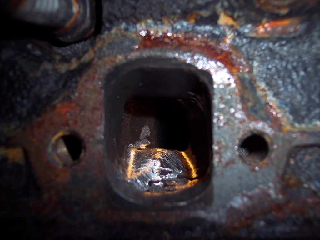

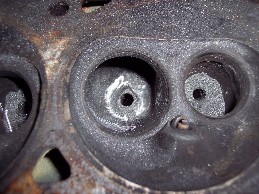

I'm by far not done, knife edged the guides, smoothed some transitions raised the intake, and exhaust roof.

You have alot of patience. Porting cast iron heads is a pain in the ass. Looking forward to seeing finished pictures.

how do you know when every opening is the same is there a tool to measure or when you port youdelf is it by eye?

Idk the name but its a adjustable y shaped measuring tool. I just hold it up to a ruler, I check the ports every 1/4 into the head. I give myself a margin of + or - 1/32.

what heads are those and why knife edge the guides. ive seen both which is better and why?

They are gt40p's. You can either knife edge the valve guide protrusion, or try and lower it, or remove it altogether(not recommended).
