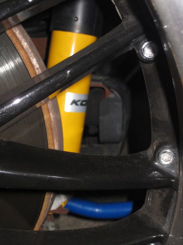

I just installed the rear Koni Yellow Shocks (fronts are on back-order till January) with Steeda Swaybars and Adj UCA. It depends on what your looking for out of the car, I wanted adjustability for the drag strip and track days. The price on the STR.Ts is really good though.
Car was filthy i know
