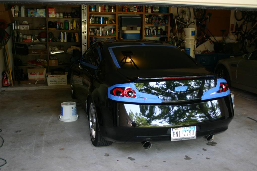

Hey guys, told you i was going to be doing a g35 detail this weekend and i just finished!
Kind of sucked, i had a time limit, i only had SEVEN hours to do a complete detail...so i wasn't able to do three passes with polish, but it still turned out WAY better than it came in
What i did
1. Washed down the whole car
2. Clayed entire car
3. Hit it with CG no.721 all around (orange LC pad) followed by IPA (first time doing and it HELPED)
4. Hit it with CG no. 7xx (forgot number) (White pad) (IPA again...)
5. Hit it with CG wet glaze (first time using it, LOVED it on the black) (Blue pad)
6. Finished off with the auto glym (hand application)
7. Washed down the vehicle again
8. Dried it down and used CG v7 detailer on it to shine it up

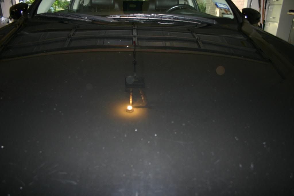

for only 7hours of work, it turned out great! Almost all swirls gone, only light scratches but nothing major! couldn't even see them even in direct sunlight!
SO i took pictures for you guys but only a few because i want on a time limit! not even a break for myself.
TRIED to keep them in order. but PB is annoying....
NOT MY BEAMER...lol
50/50
50/50

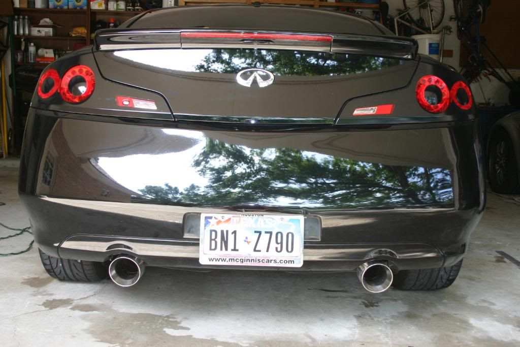

sorry i focused on the rear end so much...but that had the WORST damage on the whole car so i focused a lot of my time there!

Good job, it looks great. Question, what in the world is with the tail light in the first picture?
Exactly. I've used it quite a few different conditions as well considering Florida is pretty different from one time to another. Like you, always prime my pad and I get very, very low dust. Maybe a 'smidge' more than #80. Either way, it's not bad. However I really want to invest into some Menzerna like their SIP and PO85.
His first attempt at doing layover tint, he cut it himself and didn't exactly get it right so he had a lot of bubbles/excess tint! never bothered to fix it

That really looks like a rattle can tail light job...A bad one at that...

I hate how the car is gloss black, and the tails are flat... clashes.
