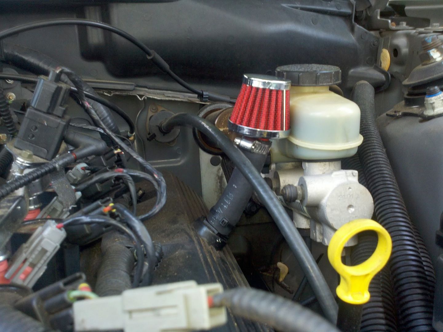

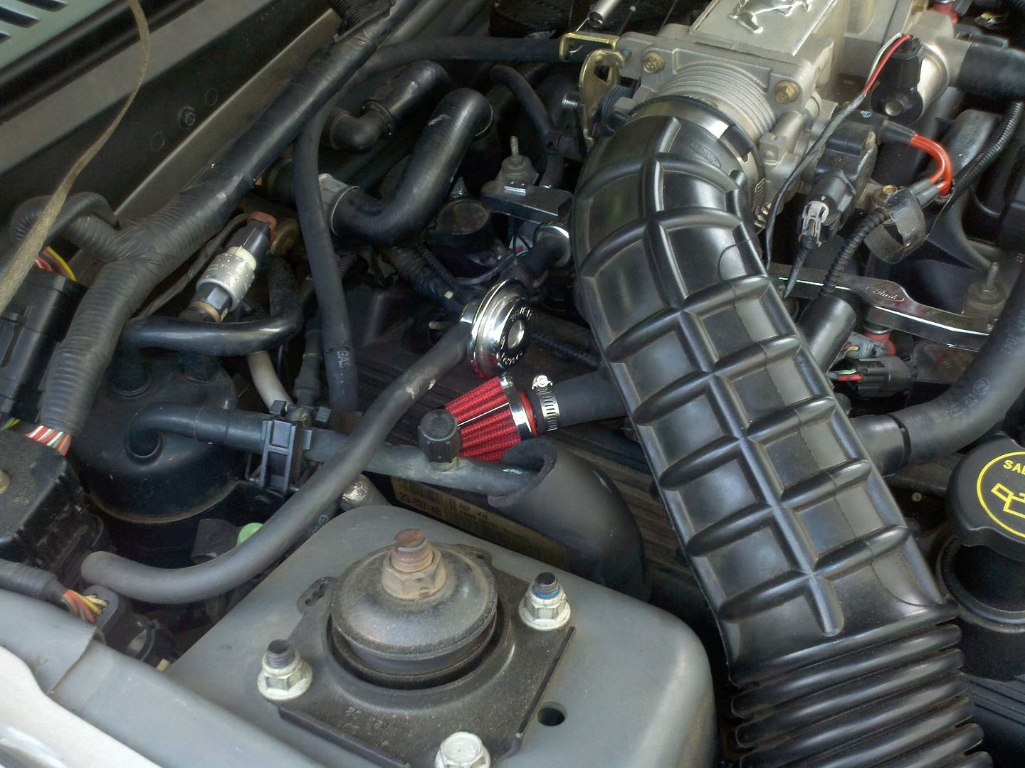

I've noticed some blue smoke coming from my exhaust after my car has been warmed up. Mainly when pulling off from a dead stop. Obviously that means I'm burning oil. It's not a lot of smoke, but definitely enough to notice. I'm running an off road X pipe so I'm wondering if no cats has something to do with that? Regardless I started looking over the PCV system and noticed some oil residue in the vacuum lines. I first tried to run a catch can but I couldn't keep the massive 5/8 hose from sucking flat. I finally got so frustrated that I said screw it and deleted the whole system. In the pictures you can see how i have the breathers set up. for the passenger's side, I just drilled out the core of the pcv valve so that it's always open and put the breather on top. I then plugged the holes on the intake and plenum. The driver's side is just a breather with a short piece of 5/8 hose connected to the valve cover. Did I do this correctly? I just want to know whether I missed something or if I'm going to be okay with this. thanks.

No performance benefit. the only thing you'll get out of it is preventing oil from getting into your intake. Normally only cars with Forced Induction need to do this. I'm not sure why I'm having the problem

It looks like you forgot to plug the hole in your intake. The way you have it works fine. I used to run that way but I got some oil mist out the filters so I went to a vented catch can

I plugged the hole after i took these pictures. I used a round plug that i picked up at the auto parts store. sorry, forgot to mention that. but thanks Stal! good to know I didn't screw it up. now i'm praying that i don't have oil mist problems.
