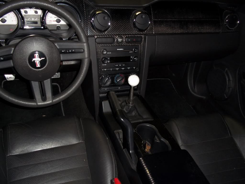

Well right now I have the roush short throw shifter and am fairly happy with it. However it seems that everyone thinks the MGW is 10x better and I was just wanting to hear from some people that have it why is it so much better than the other shifters out there?
Also if I were to switch to the MGW would I be able to use the roush shift arm? I really like the look and feel of it.
This is my current setup
ROUSH Performance: ROUSH Ford Mustang Short Throw Shifter
ROUSH Performance: ROUSH Billet Ford Mustang Shifter Arm (I would really like to keep this)
