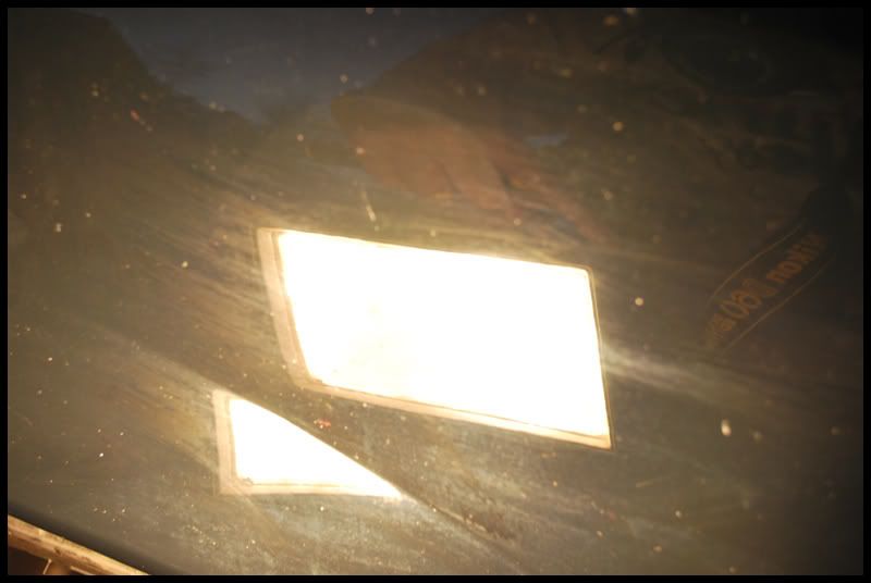

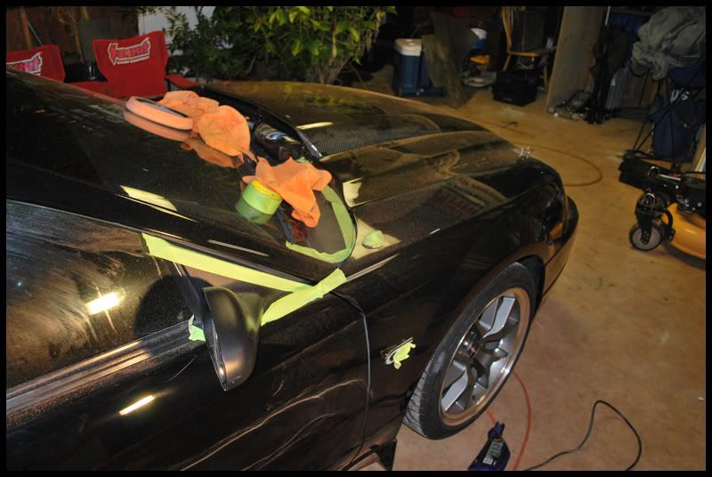

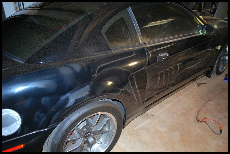

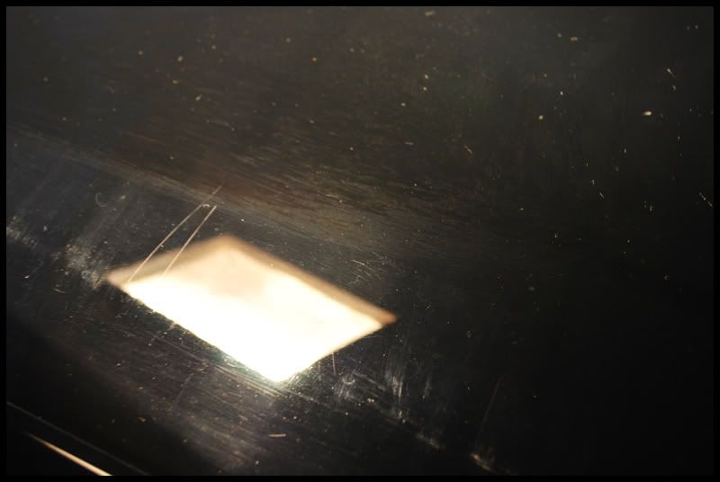

The previous owner must have washed this car with sand paper, it was terrible. I am still not completely happy with the results, but it till have to do for now. The pics do the horrible paint no justice.
Before:
During: Meguiars # 1 is by far the dustiest product I have ever used.

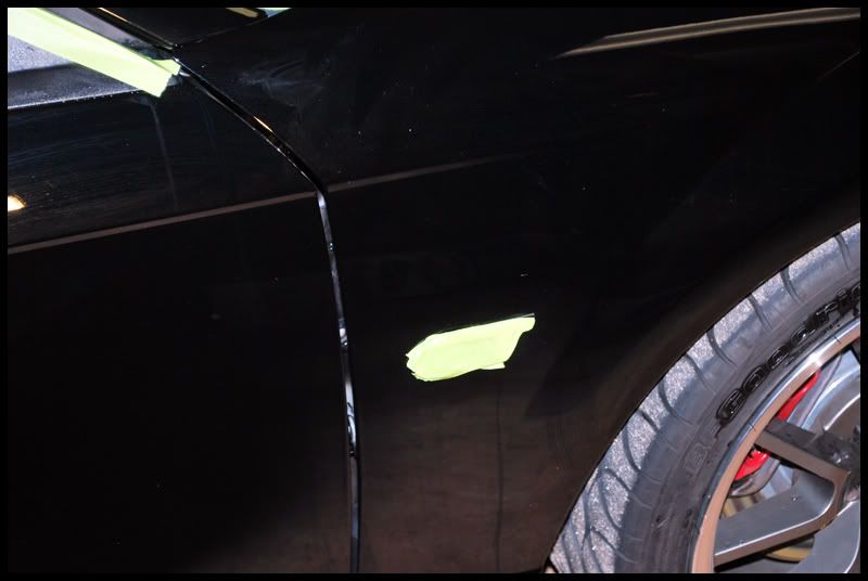

Are those spots on the fender rock chips? Looks much better though.
You said Meg's #1? Is that the medium cut cleaner?
Nah that's just dust from sitting outside while I was cleaning the inside of it.
Yeah it's the medium cut cleaner, and it sucks.

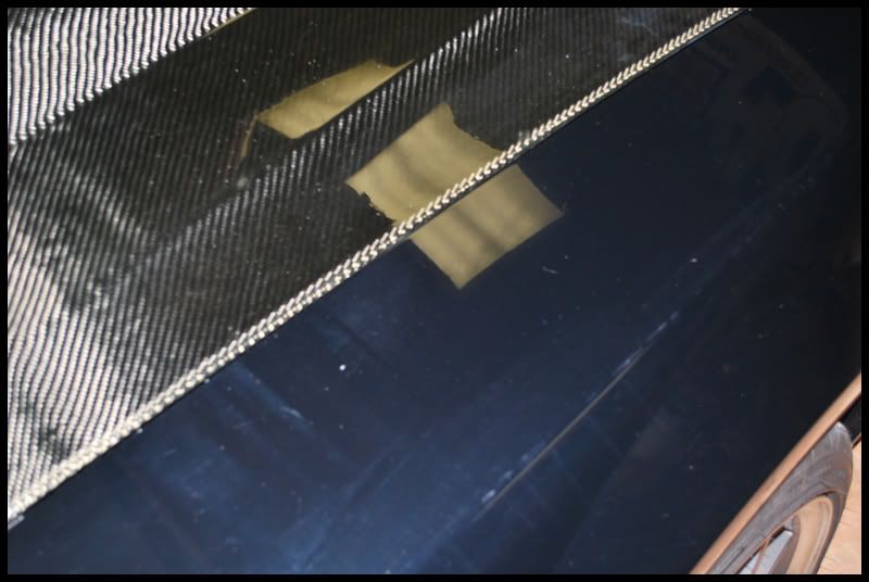

Looks good though. How did you do that CF hood?

It works ok, but it leaves tons of micromarring and hazing behind that you have to make sure and get out. It sucks because you have to do a IPA wipedown after every pass because the next step will just fill in the micromarring instead of correcting them. And it is a f'in mess.
The CF has some hard ass clear, so to start with it wasn't that swirled so I didn't have to spend much time on it. But I used Adam's swirl & haze remover and then went back over it with Adams fine machine polish and topped with Natty's red. All the rest of the panels were done the same way with the exception of the number 1 on top.
I noticed that REAL big when I used it on my car... I tried to use it on the tougher spots because I running so low on the XMT #3. I decided to just bite the bullet and use the XMT #3 after the Meg #1.

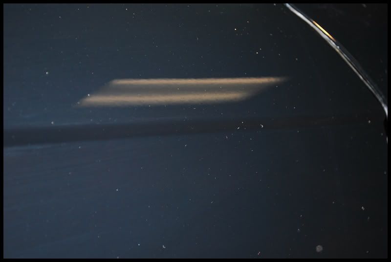

Also while were on this topic, you know the spots that compounding leaves behind? It's hard to explain, but it's like little tiny specs. There are a few of thos on my hood and spoiler. What is the easiest way to remove those with a PC?

Yeah that comes from using too much product, try using a little less, I go by the "quarter size" rule. I have found really the only sure fire way to take them out is by clay bar.
