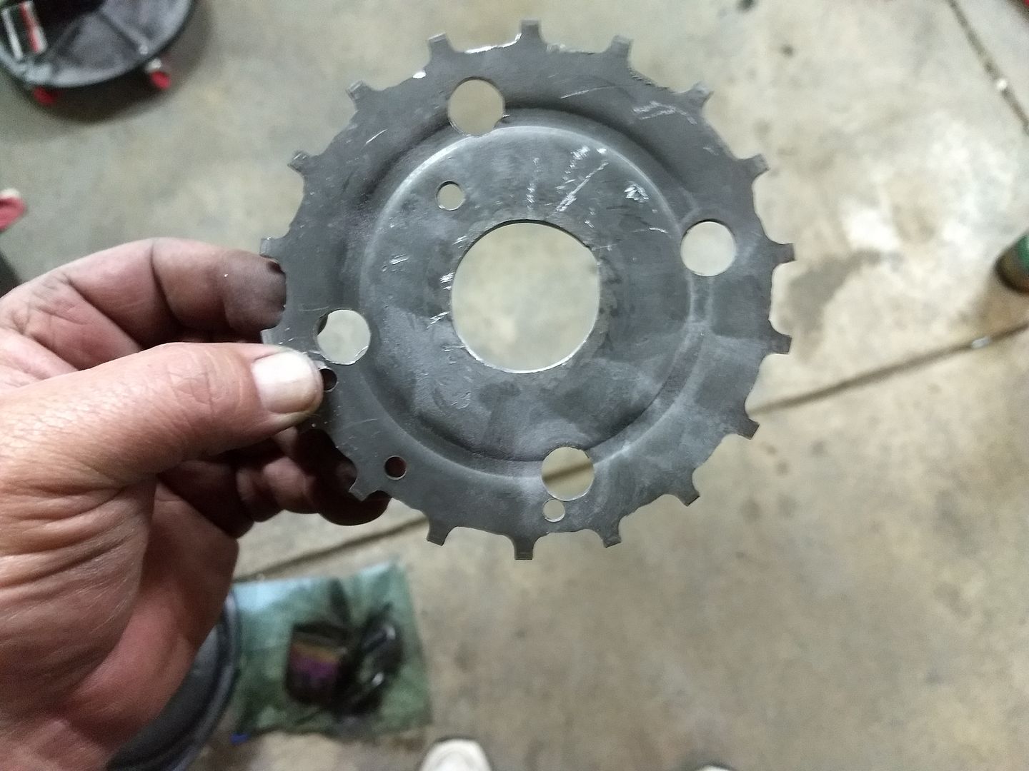

Here's one of my winter projects. I am doing this to be able to read driveshaft speed. I am using the front passenger abs to read mph. Then with driveshaft speed I will be able to read rear wheel mph, calculate converter slip and be able to have traction control. I am going to use a stock timing wheel and crankshaft sensor. I will have $0 of cost and only my time invested. A company does make a setup to do this, but it would cost around $500 for everything needed. I always like thinking outside the box.
Since the timing wheel is missing one tooth I removed every other tooth. It makes it a 18:1 wheel. Then I used a driveshaft spacer to drill the 4 new holes. It is going to mount between the driveshaft and pinion flange.
