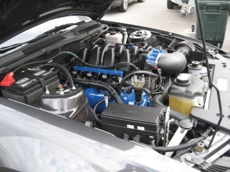

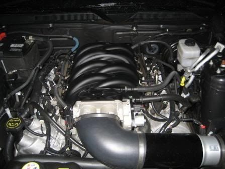

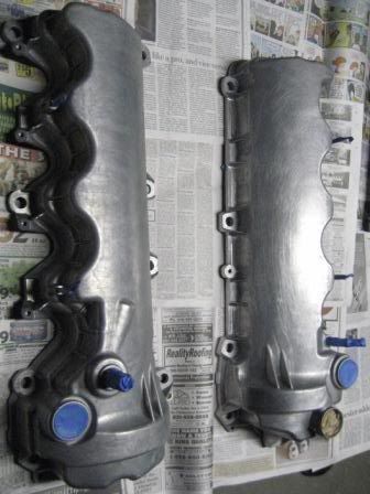

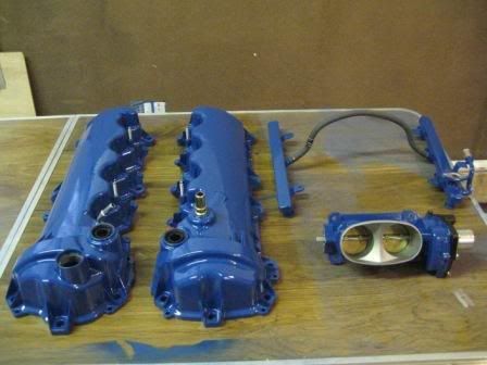

just finished putting my engine back together today, painted the valve covers, throttle body and fuel rails like Namelessliar, here's a couple of pics. i ground all the casting marks off the valve covers and throttle body before i painted them it helped clean up the look of them quite a bit. they look a bit darker in person than they do in the pics, if anything they are closest to the picture of them off the car.

thanks guys! i think it's the same color you used Luis

thanks man. it's called 'Old Ford Blue', duplicolor engine enamel, i got it at autozone. primed, put 2 coats and then used the clear coat on it. it's a little bit darker in person than it is in the pictures and IMO it compliments the alloy pretty nicely.

hey thanks everyone... it takes virtually no skill, all of the electric plugs are fit so you can't screw anything up, just keep track of which bolts go where and you're golden. the hardest part is not scratching/denting the paint when putting them back on. actually even worse is masking off areas before painting, that makes me want to slit my wrists it's so damn tedious.
if you want to know tools/time, you only need a 1/4" socket drive with a bunch of sockets, a flat head screw driver, and possibly a torques head bit if you want to disassemble the throttle body. you also may need some type of form-a-gasket for putting the valve covers back on, it should go on the seam between the head and the timing chain cover. for time breakdown:
disassembly: 1-2hrs
prep : 1 hr
paint : 1 hr
reassemble: 1-2 hrs
so figure 4-6 hrs total start to finish.
