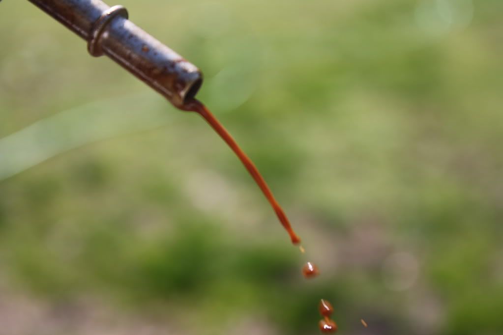

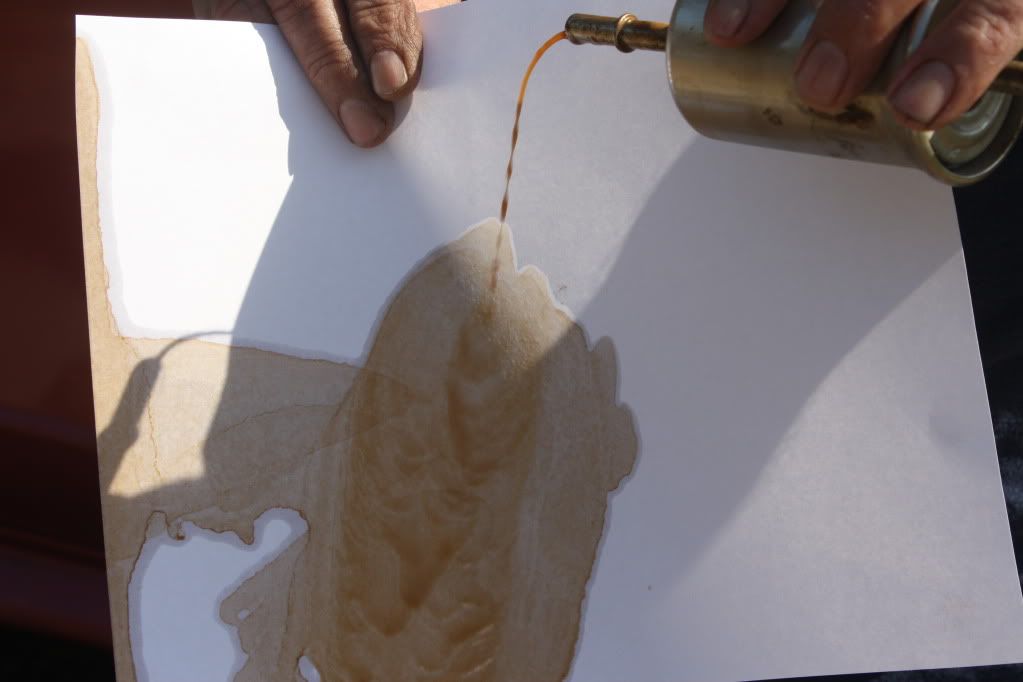

Ummmmmm lets see. Lower Subframe Connectors, NGK Spark plugs and a new Fuel Filter. Pictures attached. Worse than I thought. At 50k miles I knew I should change the sparks and I knew I was getting horrid gas mileage but I had no idea I would find all this. >>>

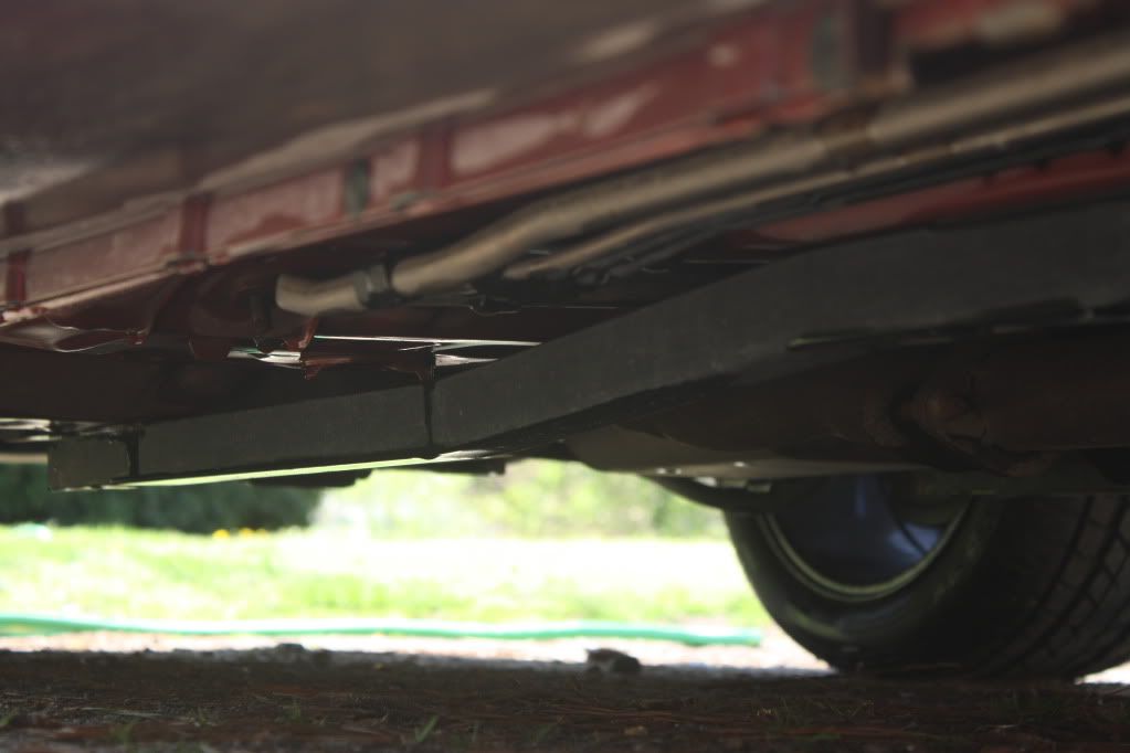

Lower Subframe Connectors, Cheap ones but better than nothing.
Old Motorcraft Platinums, 4 were at 0.61 and 4 were at 0.53. Alternating one from the other. YIKES!
Finally and worst off all stock fuel filter.... OMFG. I was pissed I hadn't changed it sooner.

i wanna say it's a nikon, and you think your fuel filter is bad?
mine had black **** coming out of it. :eek:

I guess black would be worse then whatever color that is Vince hahaha. Muddy Back Creek Burnt Orange. < That's it.

Thats sexy burnt orange lol. Very nice, I waslooking at those camera.
My filter was pulled out and it was more dark grey. That orange is like some rust man lol.
How to do fuel filter? Pull out two white clips, pull off fuel line, pull out filter, reassemble ;)
1,212 Posts
Discussion Starter #7
I hate to admit it but the $6 fuel filter removal tool was pretty helpful. I would unhook the negative side of the battery too. It lets some pressure off of the fuel pump, sounds crazy but it does. You can use the fuel stop button in the trunk as well. Make sure you put the filter the right direction when reassembling too. Most filters have an arrow. It would suck to put in on backwards. Depending on how dirty your car is, I also recommend protective eye wear, and a pair of long arms if you want to avoid being sprayed with gasoline.

Damn at the look of those pictures.my car has 50k on it. Look like a new fuel filter,tires, and spark plugs.

I really need to change my fuel filter. Any tips for changing it out?
Pinch the line with vice grips then shove a bold up it, get the new filter ready, re-clamp the line and take out the bolt, slide the filter in and release the vise grips. Pretty straight forward.:D

They are Mustang Max Subframe Connectors. Paid a little over $40 for them. Not as crappy as you may think either. They do their job for the time being until I get my Griggs setup.
