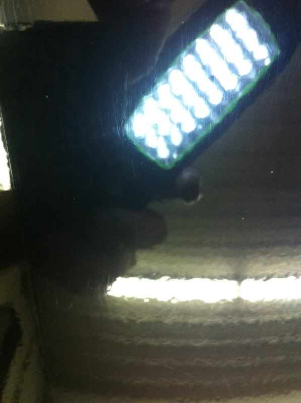

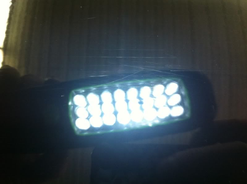

This will my first attempt at correcting scratches so I would like to do it right the first time. The car has been washed 3 times since it was repainted 2 years ago, twice by the former owner and once by my employee who thought he was doing me a favour... Need to know which products you would use to correct the paint. I will be using a Porter Cable 7424XP.
Its not bad but this is what Im trying to "fix". Any help would be great!

I'd suggest buff and shine orange pads for m105 and either green buff and shine pad or tangerine hydrotech pad for the m205

On black i would say a final polish is a must. Follow 105 and 205 with Menzerna PO85RD(SF4500) and youll love the results.
Your paint looks like it has lot of scratches but they arent very deep which should be relatively easy to correct. I also suggest Buff and Shine pads, they are really durable, work great, and arent expensive.

6 hours and almost a whole bottle of m105 gave me this! Very happy with the outcome so far! Different cam angle but same location. Thanks for the help guys, will post more pics after each step. Tomorrow I start m205.
138 Posts
Discussion Starter #19
I went over the car 3 times to make sure I got all the scratches out. There are only 2 I could not remove completely but you really have to look for them. Plus there was some waste as the furnace vent is directly above the car and the m105 would dry out because the furnace ran so much in the garage, it was -4°F this afternoon.

I know the new paints are hard but what kind of pads are you using? A hole bottle should go over your car about 10 times. Using too much compound could hinder the cut because the pad is gonna get caked with product really fast and not cut as well.
Post some pics of how much polish you use and what pads you use, and the way you are using them, 105 should cut pretty deep really fast, you shouldnt have to go over your car 3 times, i would step up your pad if you can.
