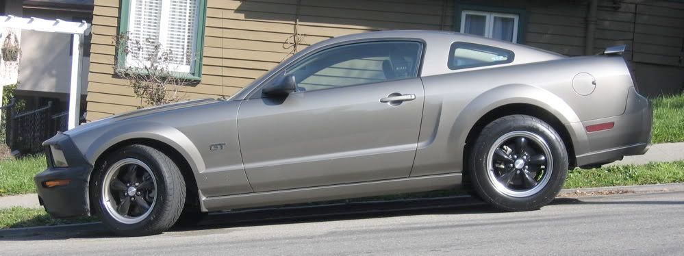

9 in front 10 in back 245/45/18 up front and 275/40/18 in back is what I'm rollin now. waiting for the 275's to wear out so I can put some more meat back there. no speedo recalibration was needed because they were almost the exact height of the stock tire
