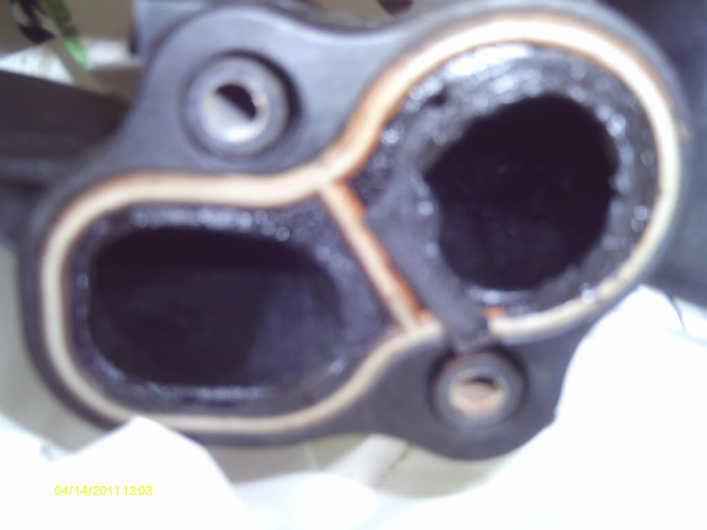

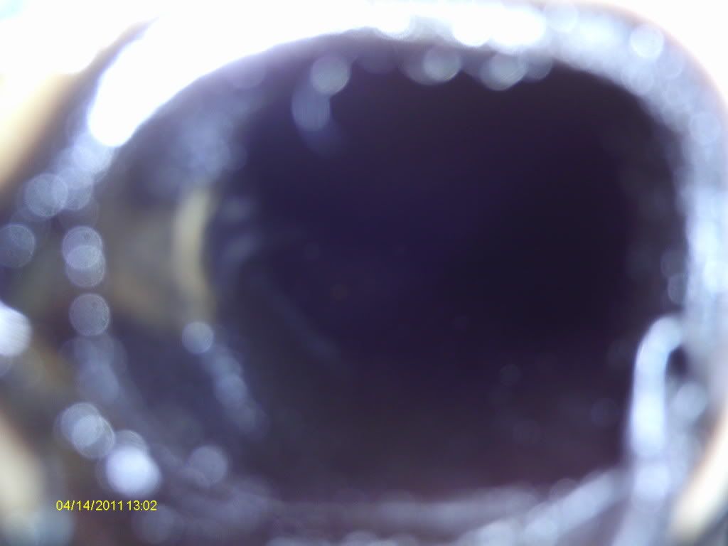

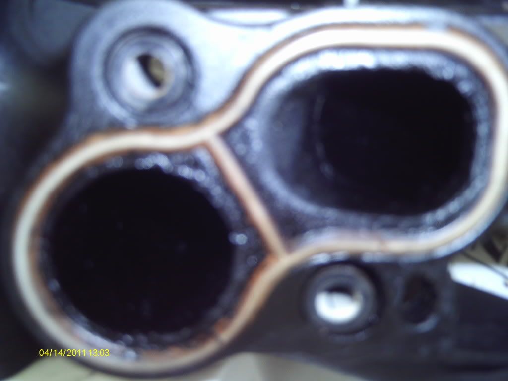

Hi guys, been seeing the seafoam newb questions popping up again. I just received my windstar back home so i had the wifey take some pics of the runners. If your here looking for performance for your stang, then you most definitely wouldn't leave this crap in your intake. Enjoy the pics.

Wait this came on your windstar upper or this was on your stock upper?
631 Posts
This is the windstar upper, which has the same funked up baffle in the valve cover.
10,592 Posts
I think you should show what they look like after you seafoam before you tell people to seafoam. How do yoju know igt will actually remove that stuff if you haven't done it?
631 Posts
Discussion Starter · #5 · (Edited)
Because i have done it to my stock upper. I use it any time i clean my tb's as well. cuts right thru it. This is to show what warrants the seafoaming. It's kinda hard for me to seafoam this since i'm in iraq!

Seafoam will not do much on those runners. That is just nasty.
It does work and I've used it in every car I've owned. I used it on this one after the turbo rebuild to get rid of all the oil my engine swallowed from the leaking turbo. It was so bad that it fouled the plugs with all the smoke, but it did wonders.

@ serlin-that also doesnt look like a six your driving. even on my wifes durango and every car i've had since using seafoam its always a part of my tune up. Any time you use a pcv system to reintroduce crankcase vapor into the engine your gonna have oil misting. theres no way around it unless you use an air/oil seperator, or bypass the pcv and vent to atmosphere.

Trust me this is going on my rebuilt stroker motor and will be cleansed throughly before being installed. I'm betting looking at the pics it'll be a pita and take me a few minute do de-gunk it.

I really doubt seafoam would do much for that; It needs to be actually scrubbed.
I wouldn't seafoam my car. Either it A. Won't make much difference at all or B. Will make a difference and my tune won't be spot on anymore.
Before my next tune I'll clean everything out.

Yeah it'll be scrubbed throughly as mentioned before, seafoam does wonders with a bore brush to get deep in the runners.
Hmm. Guess I should take a look at what my runners on my windstar look like before I put it on. haha.
If you bought your kit from vap i'm pretty sure the already cleaned it out. Because VAP is currently out of stock and I can make all the parts I need I just figured I'd save the money and build the other parts myself. This one is straight from the Junkyard. Obviously never cleaned as well.
