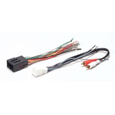

The system is set up like a processor but not on the same level as bose systems. You can integrate a mach system with any head unit just need the correct harness. Which is going to be the Metra 70-5519 harness that come with the correct secondary harness that allows for full operation and control of the stock sub woofers.

The metra harness taht he was talking about hooks in to the line out jacks on your a/m deck.
