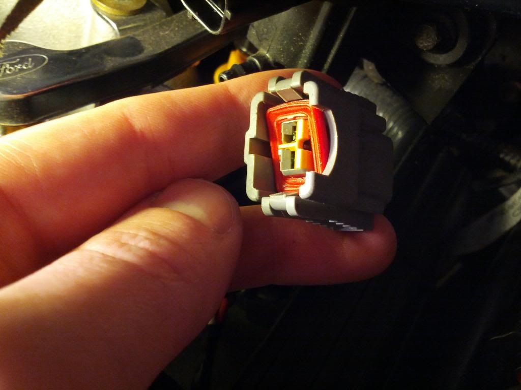

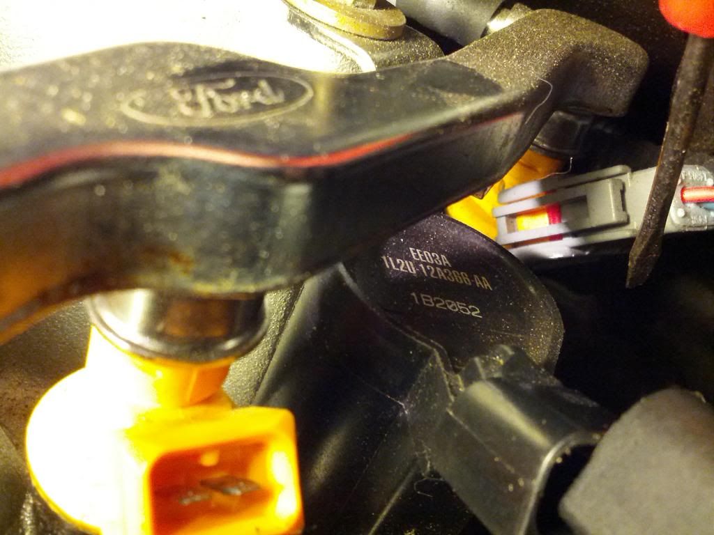

In all the threads I went through I don't recall this ever coming up. Now I may be the only one who ran into the issues, but I feel it's something that could easily be missed if not paying attention. When I started to remove the engine harness, I noticed that almost all of the little red seals from the connector side of the fuel injector clips were staying on the injector itself or falling on to the intake. See pics below.

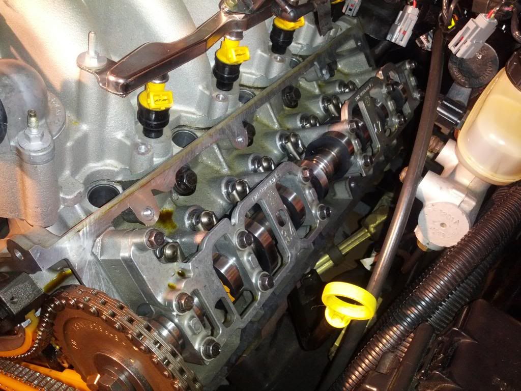

Besides that, the rest of the removal went smoothly. Having an air compressor and all the proper tools helped greatly. More pics of the install.
Stock cams about to come out. I did end up removing the T/B for room to install the cam cover when it was going back together.
