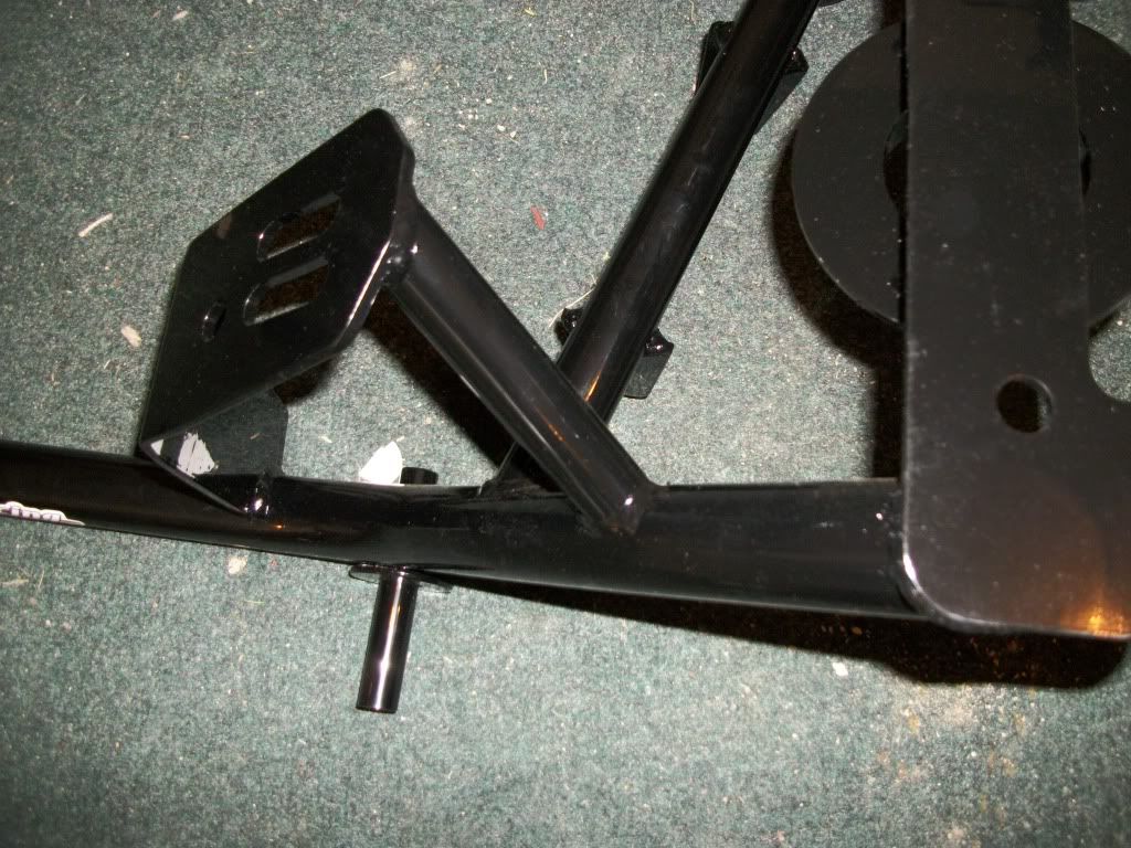

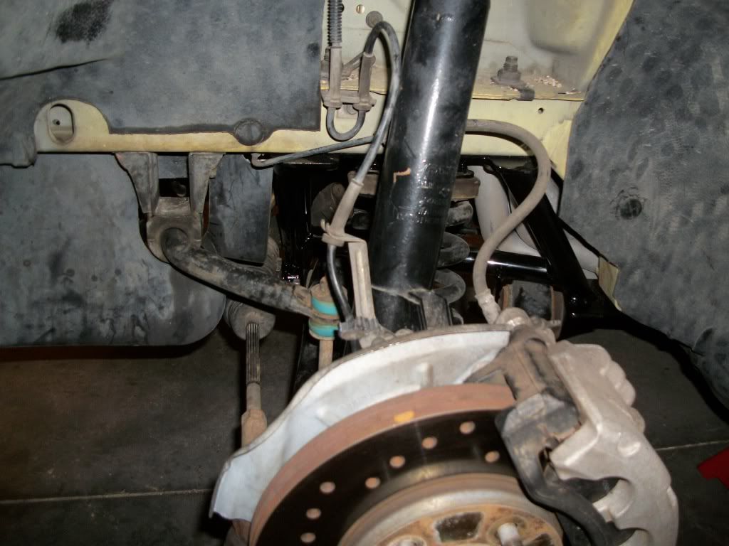

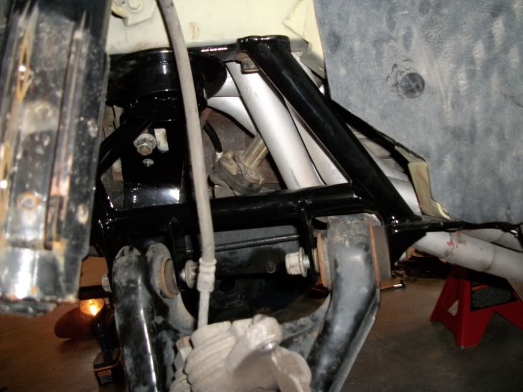

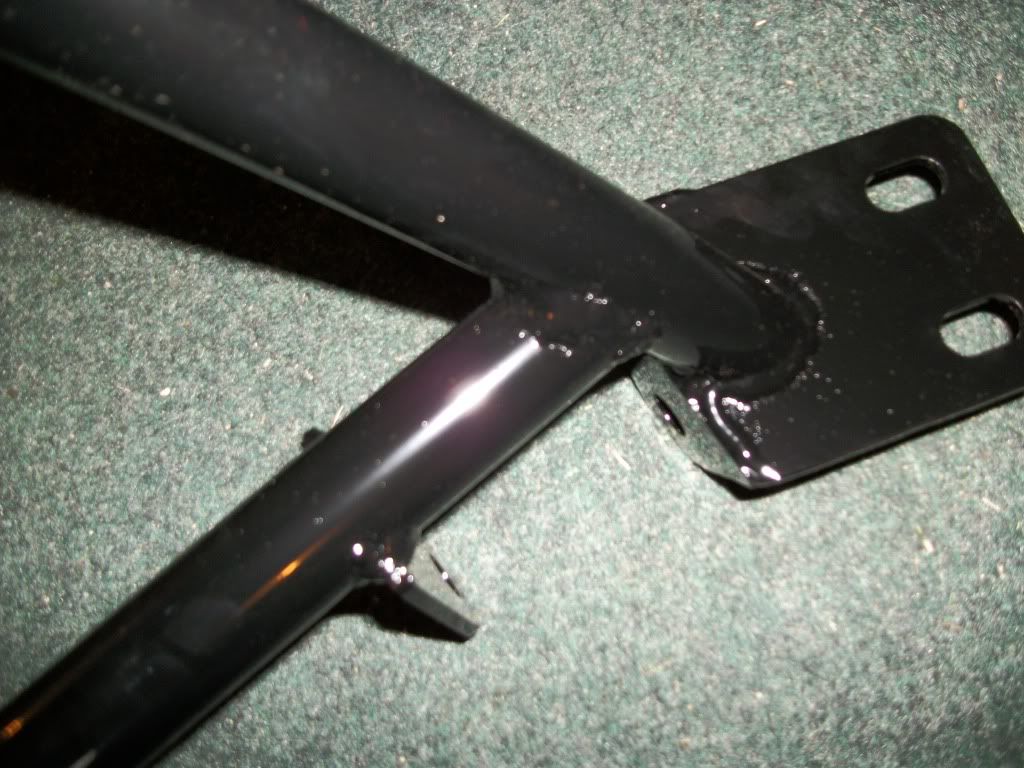

pics of welds on k member

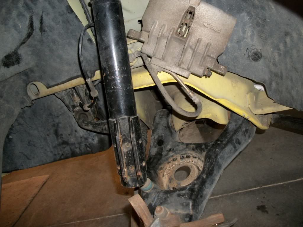

play by play you can pretty much use comon sense to see whats going on from pic to pic
^ vert v shaped brace

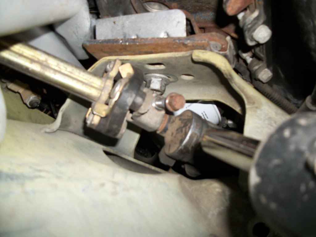

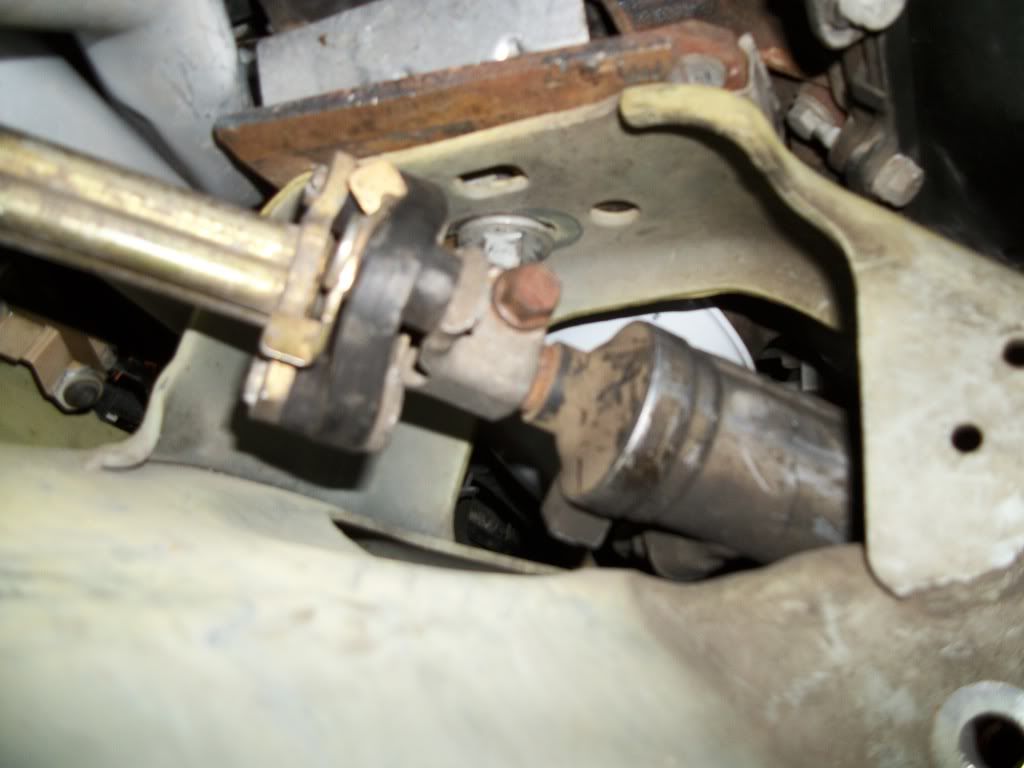

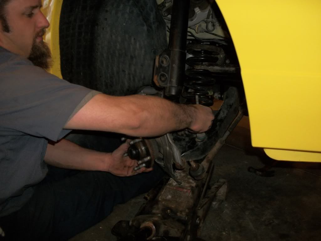

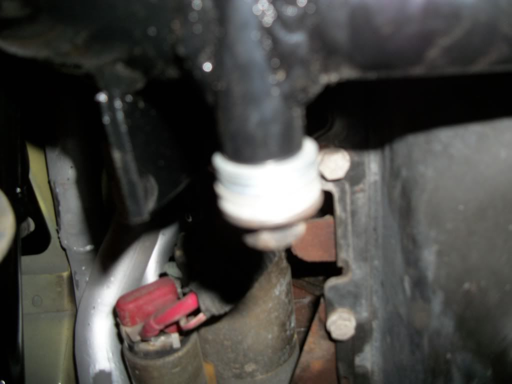

sterring shaft bolt being removed
rack removed

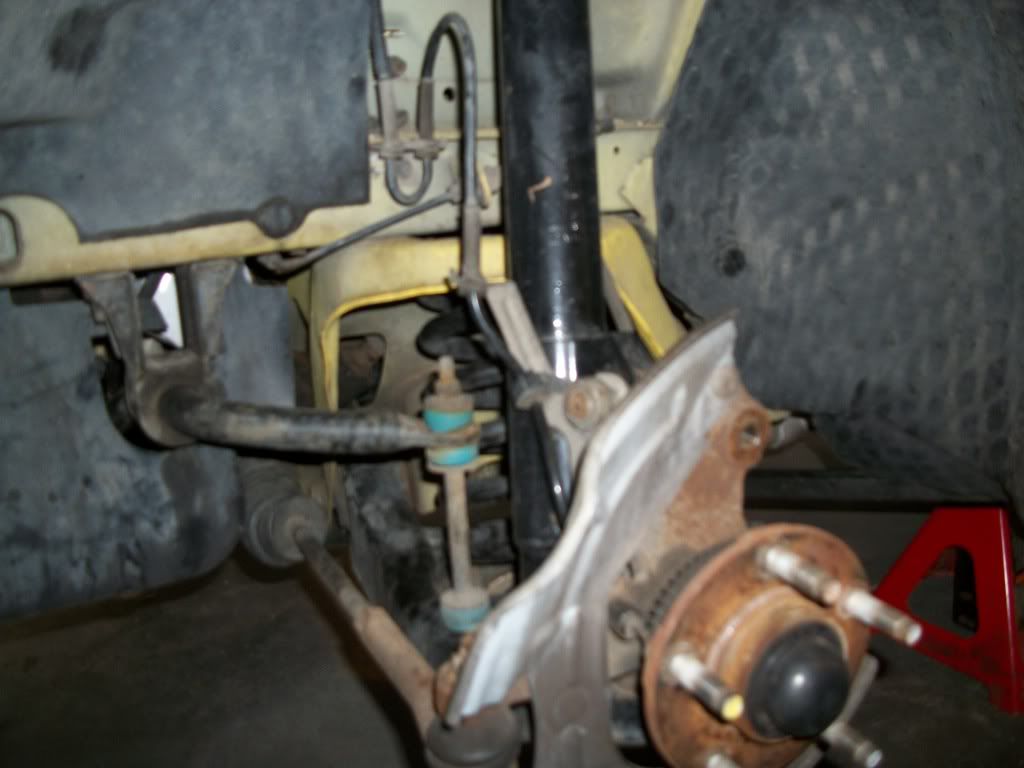

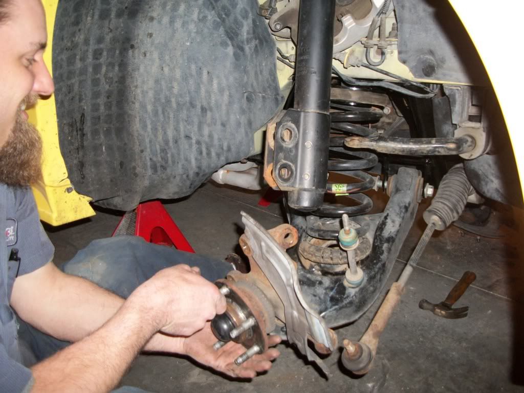

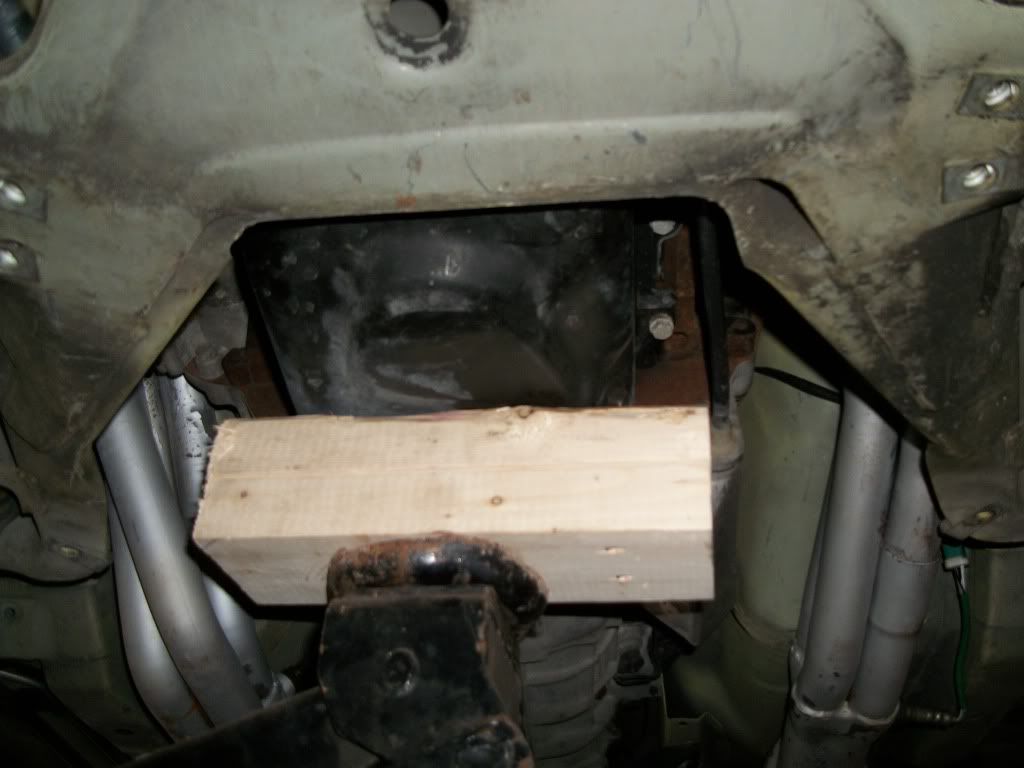

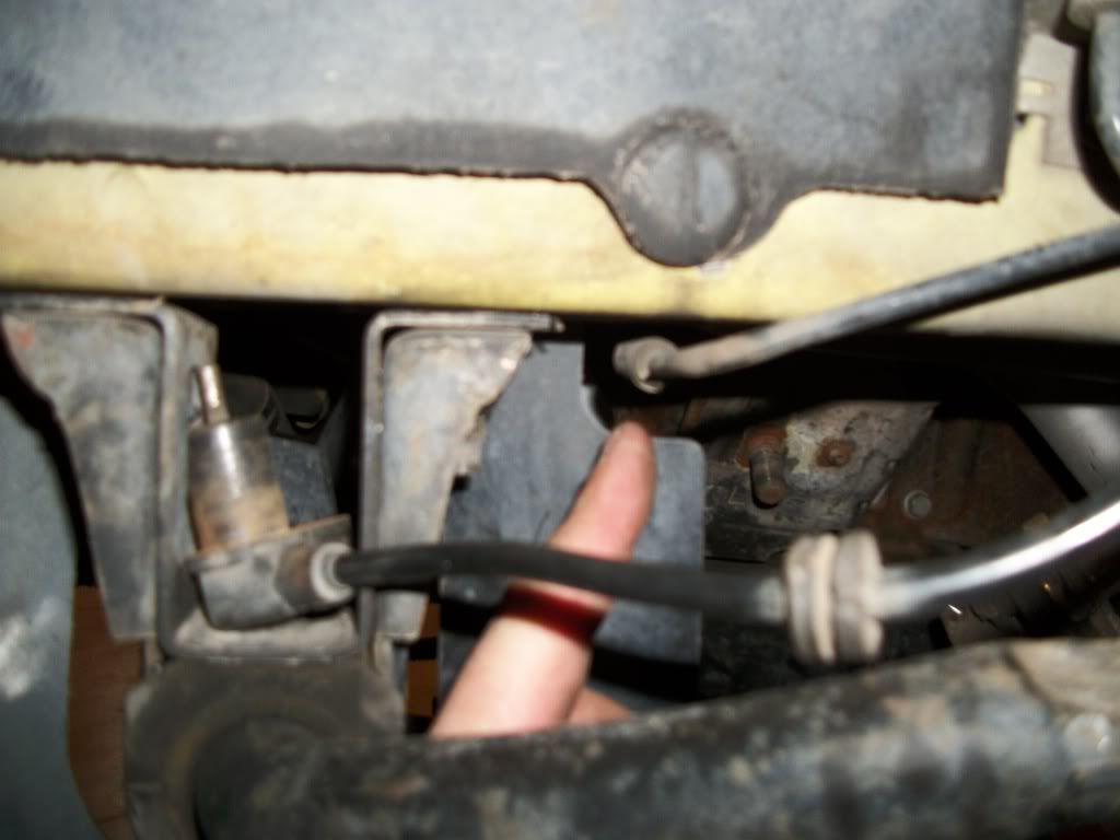

engine being supported by a jack, then romoving all 8 bolts that holf the k member up

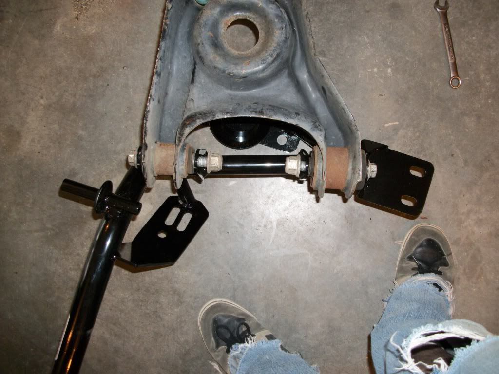

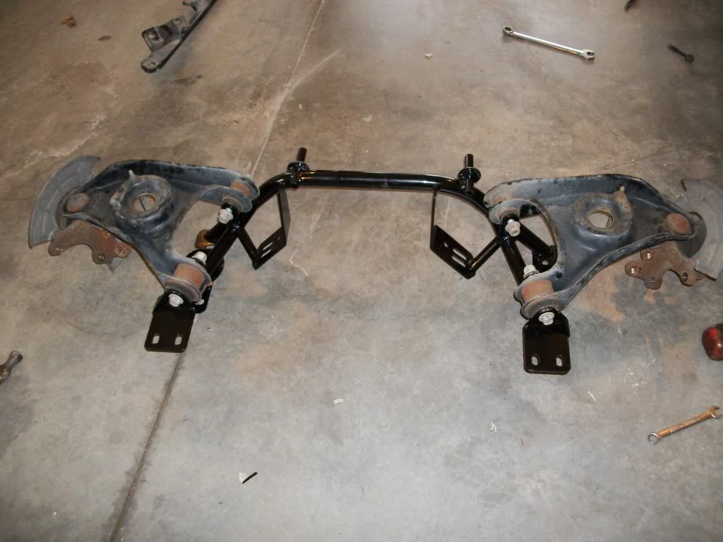

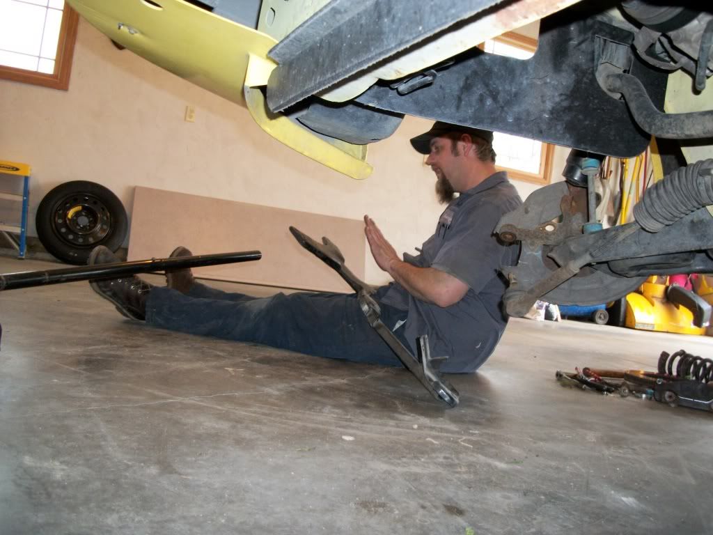

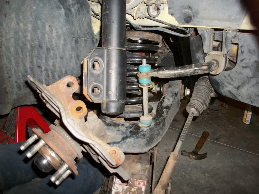

old k next to the new PA racing one
stock arms fit great on the new k with ZERO problems

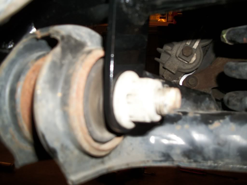

do not tihgten the a arms right awat, wait until k member is back on car and you can put weight of car on are so you dont put un needed twist on the bushings

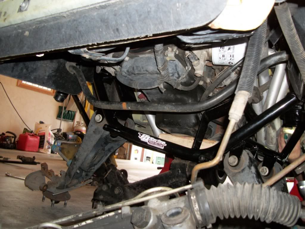

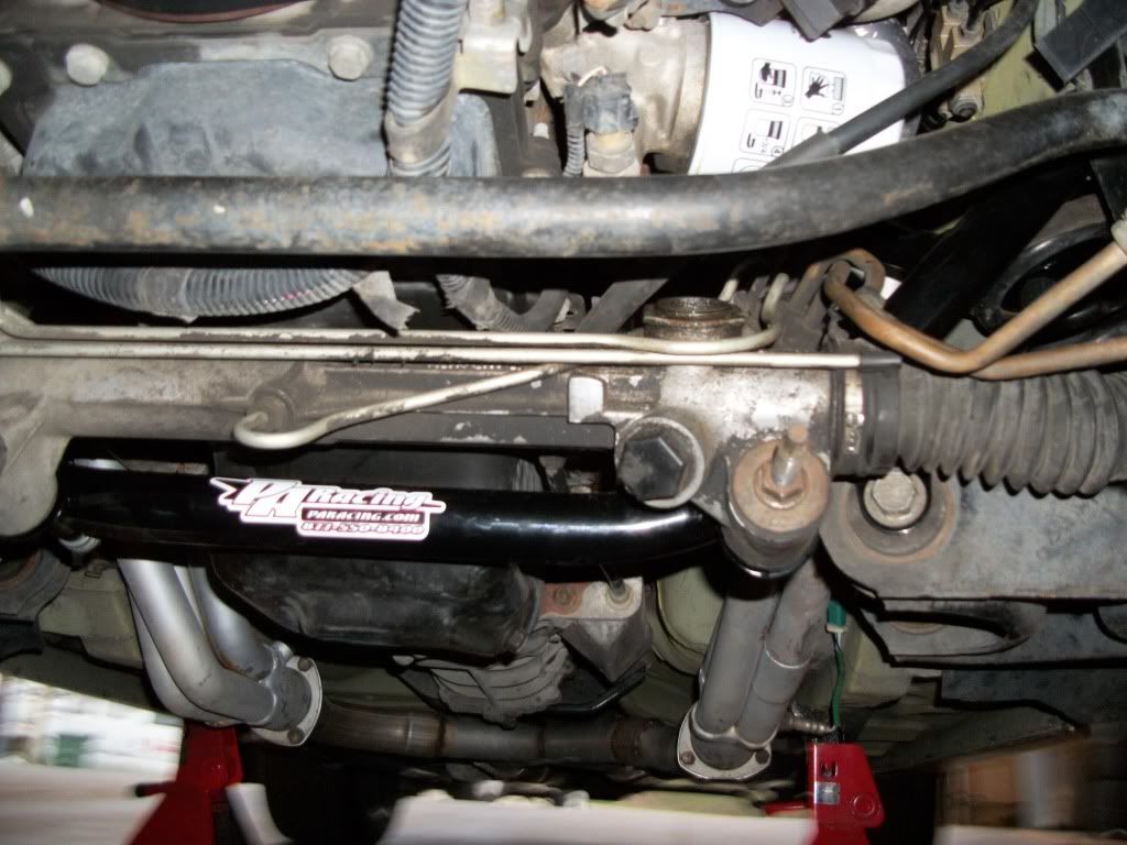

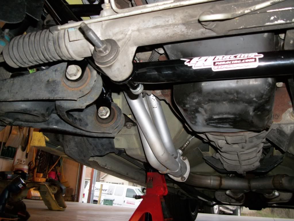

putting new k in

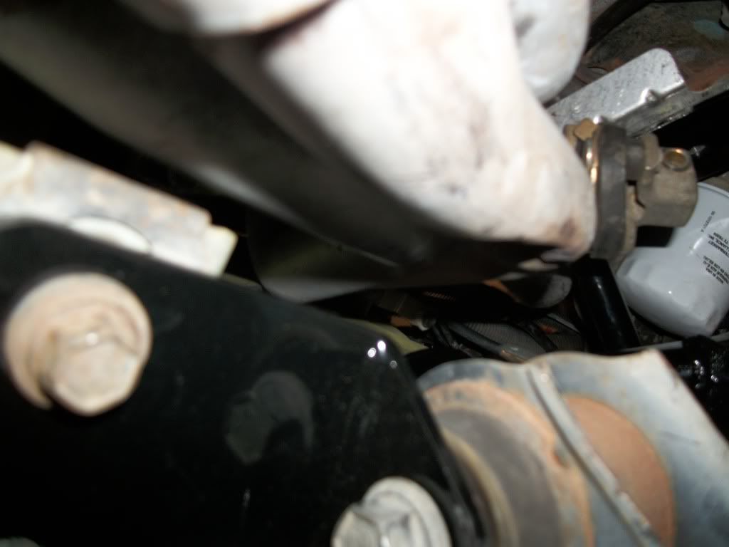

first problem, small ground bolt on dirvers side in the way, just have to take out and drill new hole for it no bid deal
side view

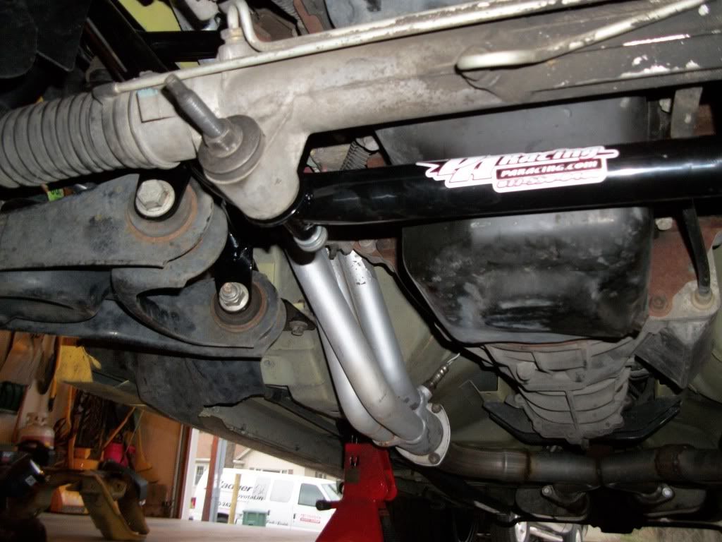

lots more header room

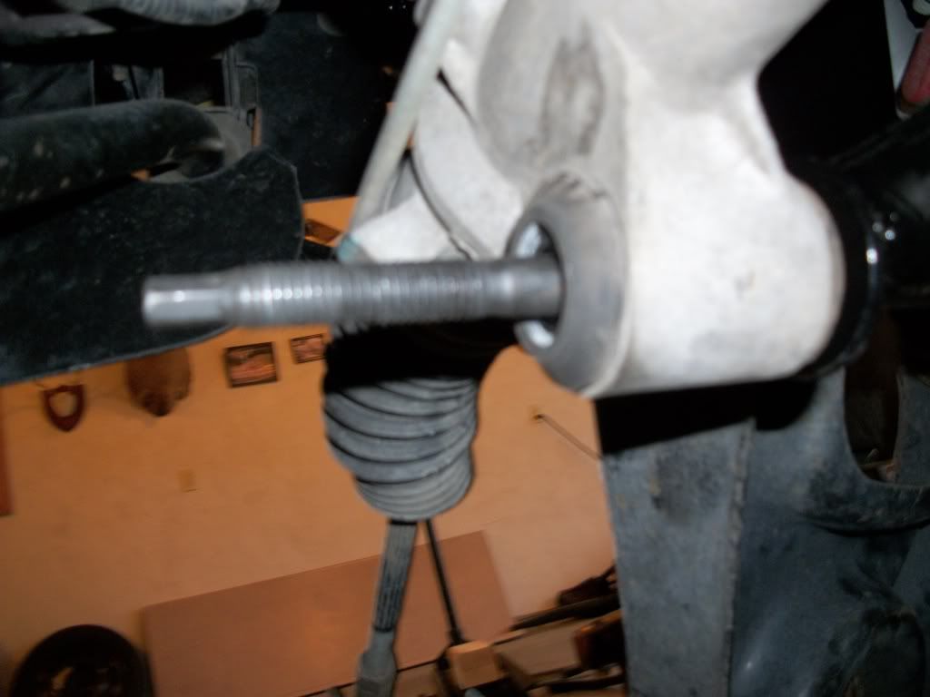

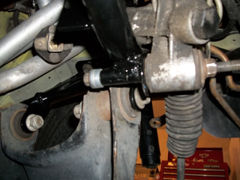

steering rack bolt is to long
added a couple washers to the bolt head side to take up the space, not biggie

going back together
couple diff pics of the new room you have
and thats all there is to it ( in a nut shell)
i was amazed at how well this k member fit and would buy it again it i had to!

got any pics of where the headers bolt to the head? just to see how much room the tubular k gives to acces the longtubes if they needed to be removed
