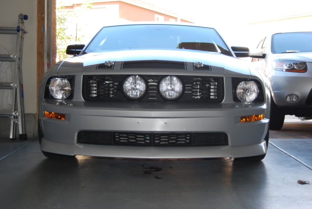

Everytime a get a performance mod I get a little bling for my honey. It helps my car's "chi" or balance. Anyways a couple of install pics and directions, though it's pretty simple. I ordered these of ebay from Ziza Lighting to offset my plum purple torque thingy I got for my tranny.
Before
After

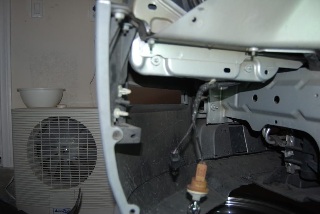

First remove the tire and front wheel well lining. I don't think you really have to take it all the way off to get to the bumper, but I did it so the pics would come out nice. It's held on by 3 or 4 sheet metal screws and some plastic push type panel fasteners.
Remove the bulbs with a quarter turn to the left and remove the signal lamp. The only things holding on the front signal lamp is a tab inserted in a slot on the far side and the 2 white pins on the left. Squeeze the 2 white pins as you lift the signal lamp away from the bumber. That little black thing stickin' up is just an alignment pin. Once it's clear of the pins, pull it back towards you disengaging the tab on the far side.
As you can see here, the replacement piece is a perfect match with the factory piece including the texturing on the side marker. Just slide the tab into the slot and press it down over the white pins. I couldn't get the tab to slide in on the passenger side so I had to Dremel down the tab just a bit to get it to slide in properly.
Since I went with the clear lens I had to get the stealth bulbs. They look chrome when there off and light up amber. I can't stand clear lenses with yellow bulbs.

Except for the minor adjustment that I had to make to the passenger side piece, I thought that these were a great product for the price. I would suggest this brand for anyone who is looking to change these up.

Ryan,
If you look at the big bulb hanging there. See that little white ring on the end? I bet there is supposed to be something similar on the small bulb and that's the part that's missing and making it feel loose.
