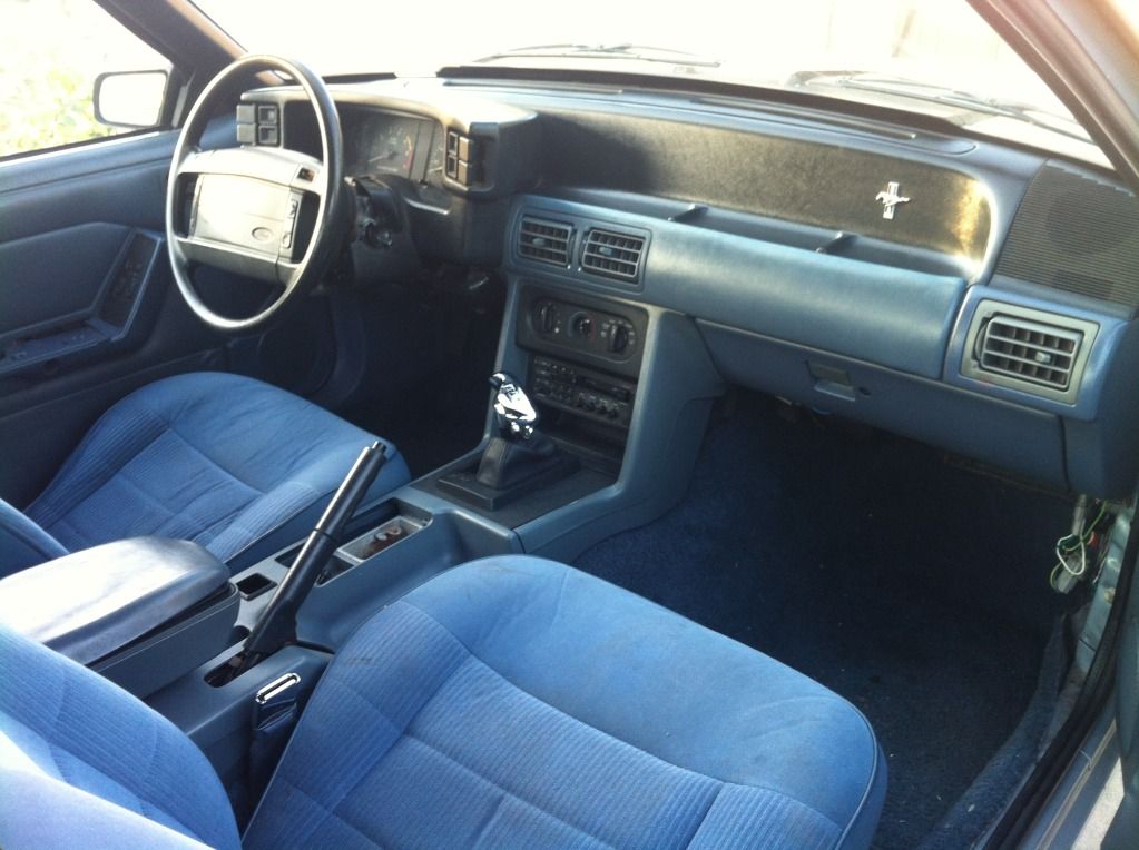

I swaped everything over brake lines , fuel lines , master , engine, trans,rear etc etc . I also took the interior out cleaned the carpet found a guy on craigslist parting out a blue coupe that i got alot of really nice stuff for this car $30 bucks for the seats and arm rest console was better then mine and he gave it all to me .. i will post more pictures and the steps i took on how it was done when i get a little more time ...

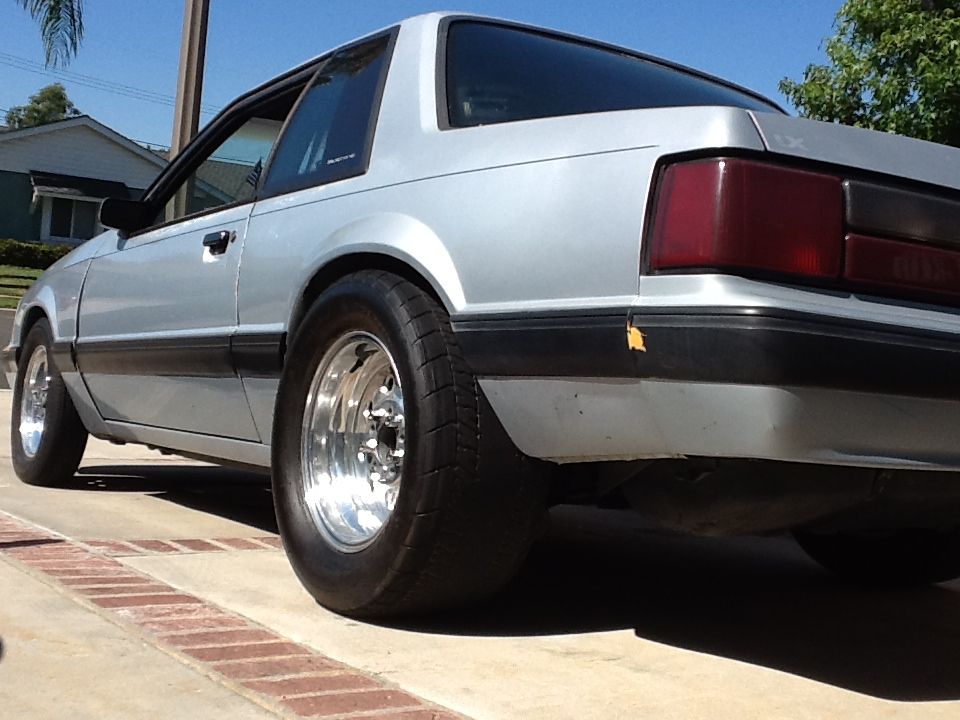

and the end result

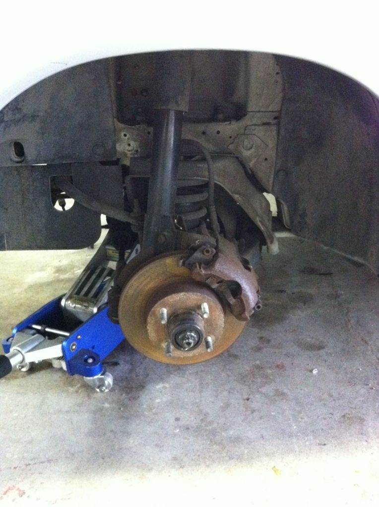

i also changed over to 5 lug with the 5.0 struts , spindles 85 Lincoln rotors
to this
