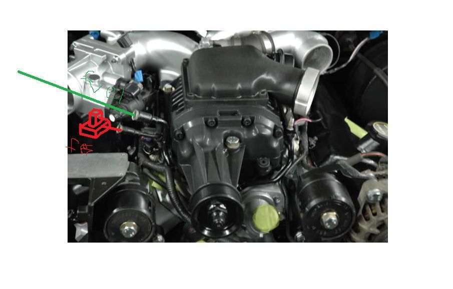

This is the only info I can find, not a bad idea, but idk clearance issues or anything w/o seeing it first hand.
But I came up with an idea Im going to consider attempting. And idk if this will work.
But instead of cutting the thing up, why not use the FPS to plug the return line and knock out both at the same time.
Only issue I can think of is it not getting accurate reading on pressure way off out there, not being between and directly "on" the fuel rails.
