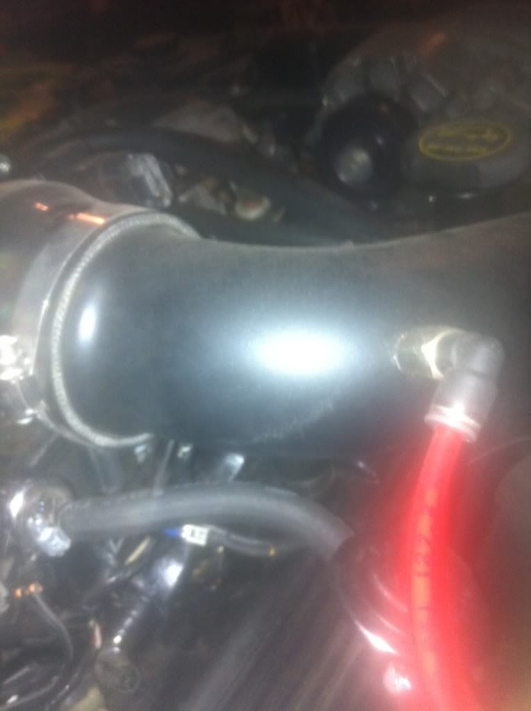

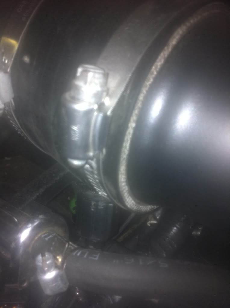

#15 · (Edited)
Sorry man, had to drive home, took some pics, & was hangin/helpin a guy on corral. :D I'm not goin to swear to it but I believe it was black silicone. I used the last of it when I did it. I spread it .25" thick inside & out. I've changed couplers as you'll see so I'm goin to have to do it myself again.
Yea I've got a little anal about hiding wires & things!!! :D
#17 ·
No prob at all!!! Meant to tell you, the IAT/silicone held up to 16lbs boost. And I got my couplers at xtreme psi WAY better than the Vortech. They're 4-ply, made great, & I can barely get em on/off. Almost don't need clamps! Lol! Heck yea, I'd love it!!! I'll pm you my email.
