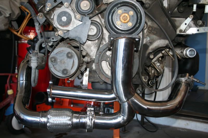

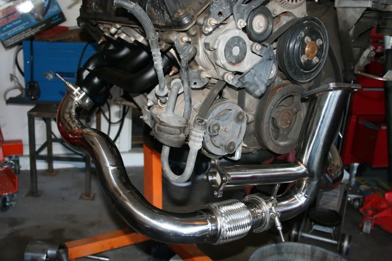

now the turbo bracket. the turbo and piping was all hooked up when i went to install the support bracket and it did'nt line up....
then i reallized that i should loosen all the v-band clamps and mount the support bracket first,then tighten all the piping.

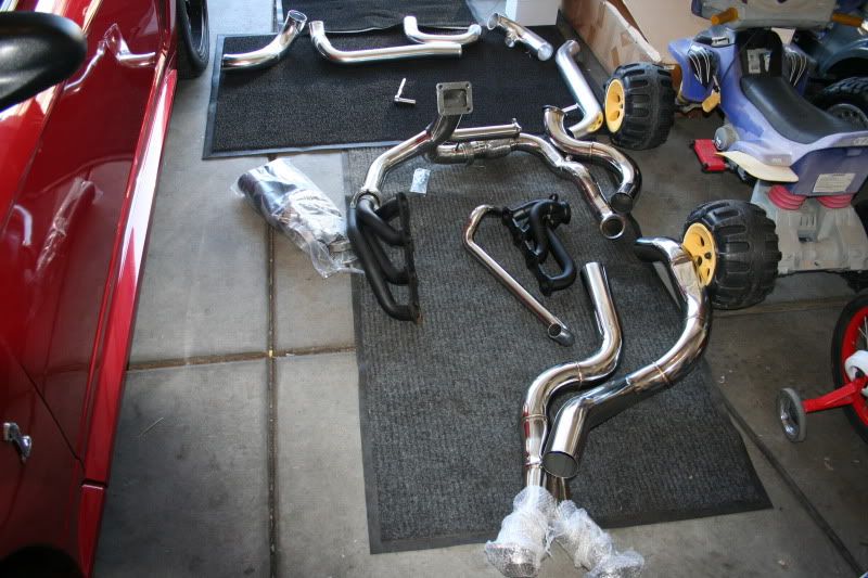

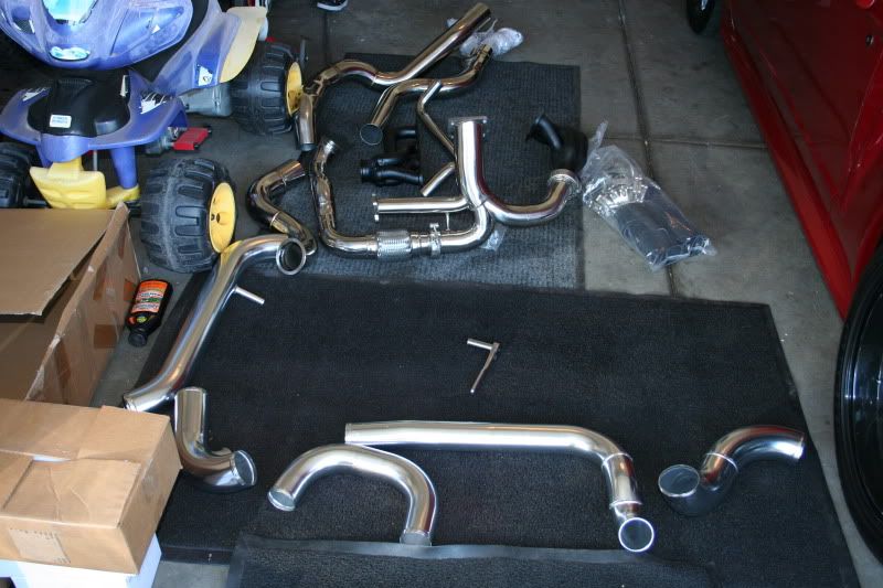

this is what the oil feed and oil filter relocation kit looks like. i need to call on3 and ask them where to mount the filter. the instructions are universal and dose'nt tell me where to mount it on a mustang
Wow that's ****ing awesome. Makes me want to do a turbo build now lol

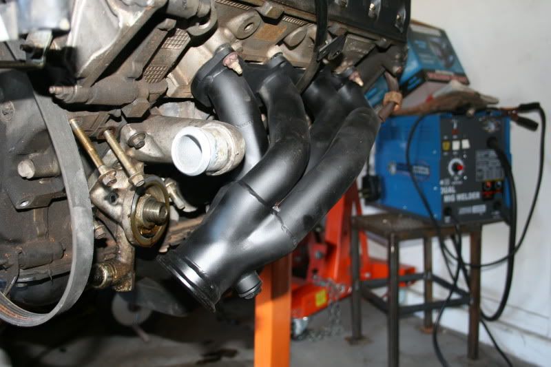

Looks like a good bit less piping with the new forward facing headers
makes me wanna ditch my Pro Turbo Kit and go with this...WAY less piping....plus mine is starting to rust...
looks pretty bad ass, i do wonder how most every one gets away with the by pass being closer to the throttle body then to the turbo/ supercharger, i had my bpv in the same area as yours and it ran like **** at idle then i moved next the blower and the idle smoothed out quite abit...maybe because im using a mondo and it lets a **** ton air out at idle, who knows...
Discussion starter · #118 ·
not sure,but i'll keep that in mind if i have any issues.
