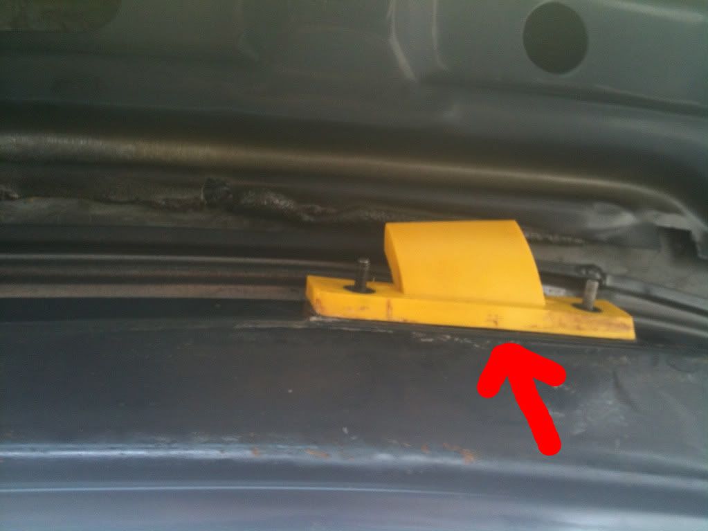

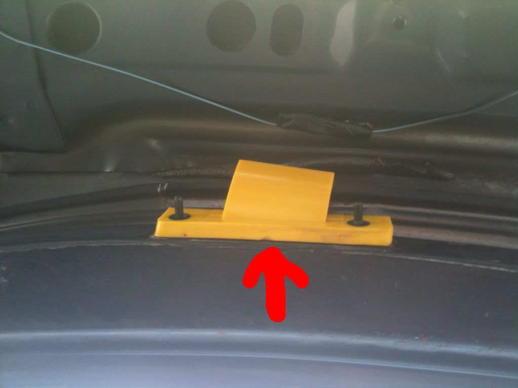

The factory sunroof on the my 93 leaks. I recently replaced the retaining bolts/washers that hold it through the glass, and the glass to body weatherstirping. I still have a small leak coming from the clip holders seen here
Im no expert, but i was thinking I could use that gasket stuff that comes in the tube to seal them up but I didnt want to mess them up if that wouldn't work.
someone must have info on how to fix this problem/had the same problem

Yes, you can seal them up. I personally would remove them, clean off the old gasket material and reseal them completely with some clear RTV (don't overtighten them, mine were brittle) Also while your headliner is off, verify your four drain hoses are on tight, not cracked, and cleared from debris and can drain freely. With those yellow things sealed and the hoses draining properly, the roof will never leak into the car regardless of the condition of the sunroof gaskets.

Ill pull them all the way off tomorrow and try to seal them up. I had already checked the drip channels and after replaceing all the through glass hardware ran up to the carwash to see where else it was leaking.
