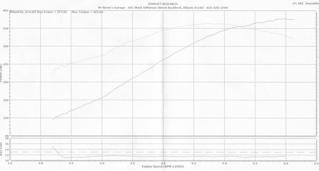

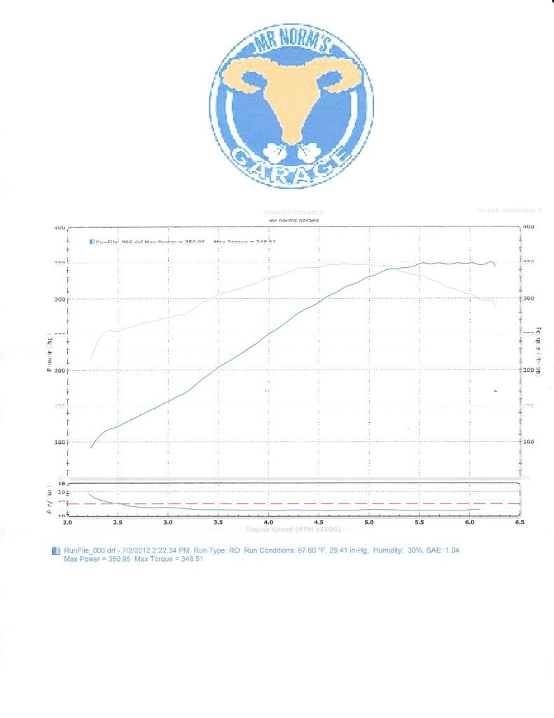

13) New numbers are 377 rwhp, 364 rwtq at 9.5 psi. I was originially at 351/349.
Again, it's an auto.
Not sure what my next steps should be. The backwash really bothers me.
New dyno sheet:
Original dyno sheet:
