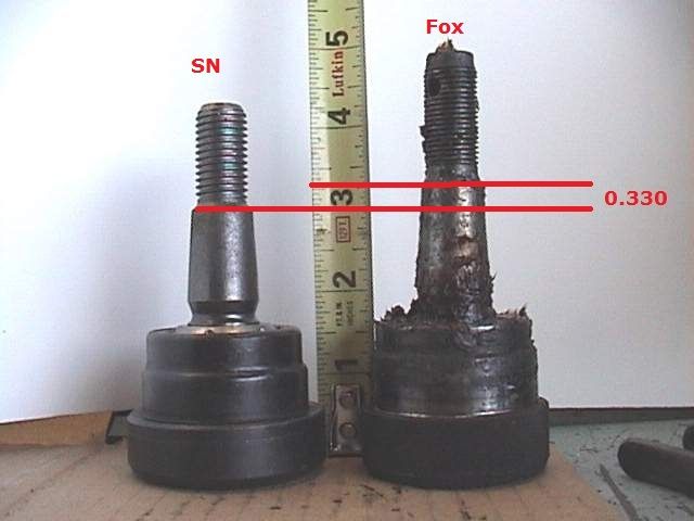

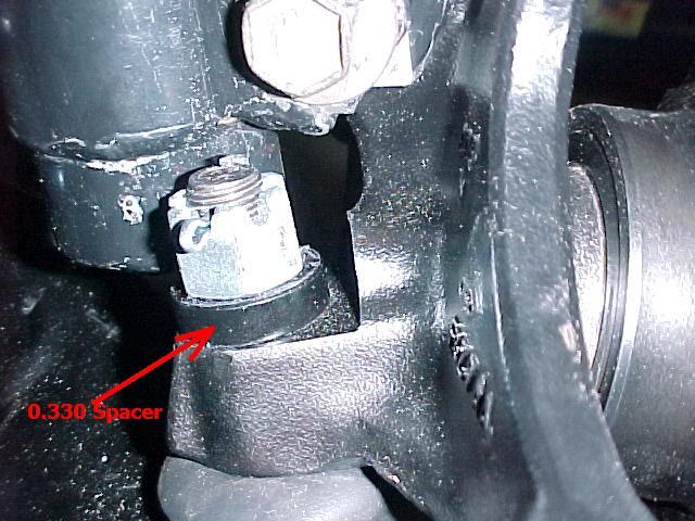

Its not the spindle that needs to be raised up. The ball joints are longer on a fox so you need a spacer to take up the extra room so that the nut can be tightened down. I have a picture ill post in a min
One per side
Difference in ball joint height

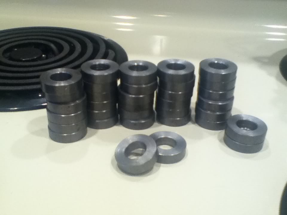

Spacer
Heres a link to buy the spacers if you choose not to use HARDEN washers
For Sale Ball joint spacers for sn-95 brakes on fox - Ford Mustang Forums : Corral.net Mustang Forum
