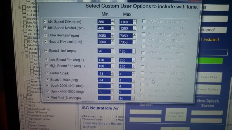

#6 ·
Your tuner can set it up to add or subtract lot of things.
OR you can buy the PRP and set it up how ever you want.
Here is what the prp looks like to program options.
Save
#7 ·
Ok so assuming i can get the tuner to set up adjustabilty on this tune, if i could advance the timing would i also have to increase the fuel and air ratios aswell or the timing is all that would need to be adjusted for more hp
Save
#8 ·
the only thing your tuner needs to know is how much total timing you want and what the stoich of the fuel is.
