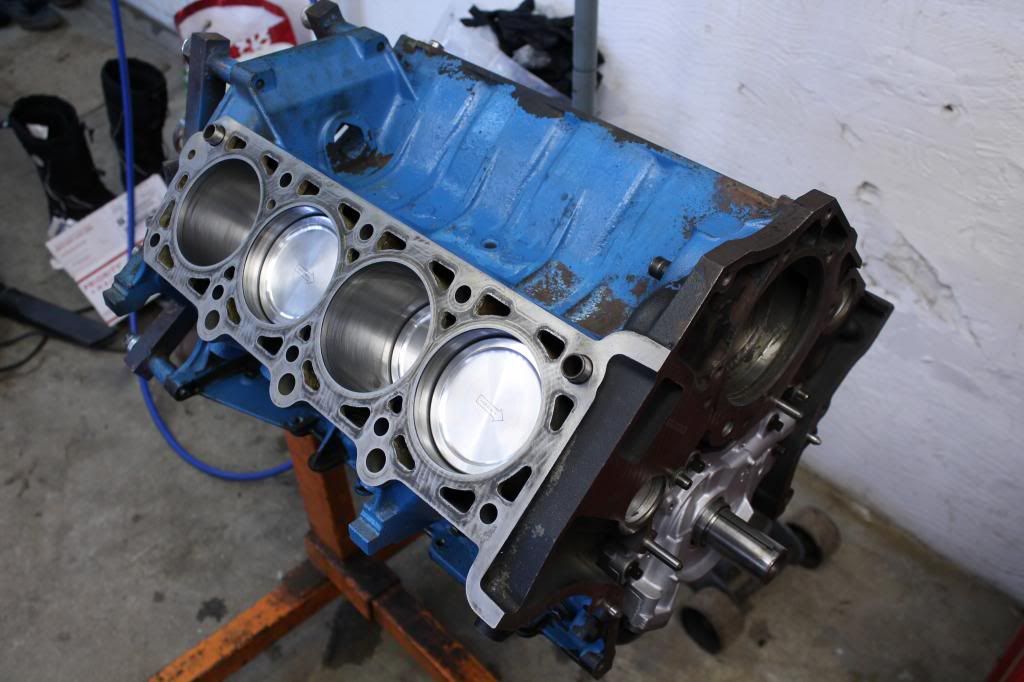

9 is all pistons below deck.
#15 ·
That looks good as well there is plenty of room for valve clearance. The reason I say 9 is because that is where you start when you set up the cams to factory specs and it also puts all the pistons down low.
